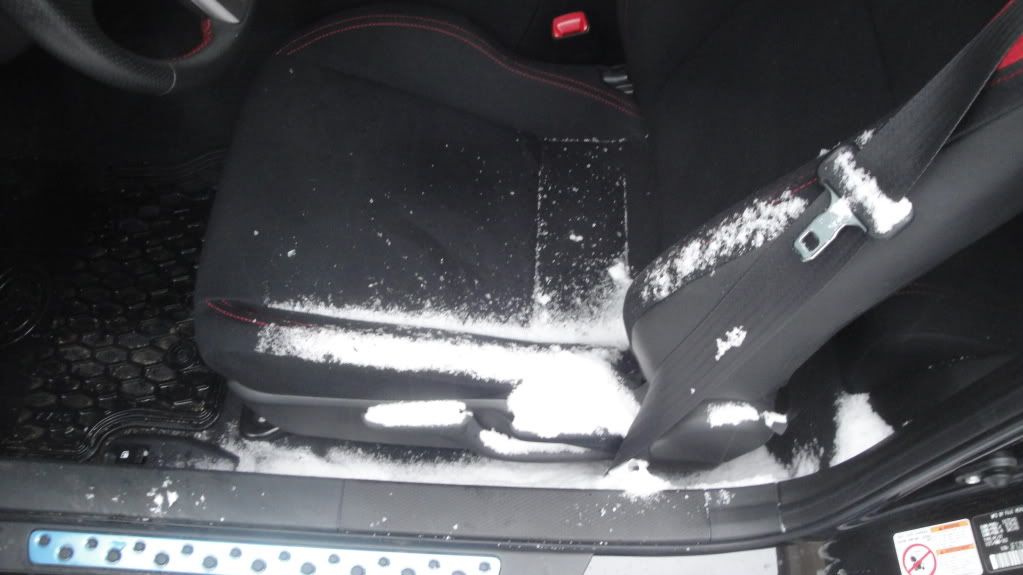

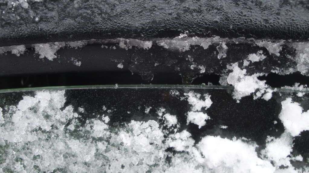

I need to reprogram the windows a dozen times a winter and must continually be checking for either window to be in the down position when the door is closed. If it does not close, the only option is to go back in the car and reprogram by rolling the window all the way down, hold, then all the way up and hold for a bit. Easy, but a nuisance.
Failure to catch the window down:

I find if you run the corner of a credit card between the bottom of the window and the rubber (before opening the door) the window usually doesn't get stuck or make scary noises. I start the back of the door and work my way to the mirror.

And ^^^ hahaha! I know exactly how you feel, I usually can't brush all the snow off the seats either but it's usually cold enough that I can sit on it a not have it melt before I get to work.

Everyone's seen the 2 vertical clean lines on the outside of the window. There are 2 felt guides/spacers down in there just under the sill (I think that's what it's called) which absorb water and freeze up. They seem pretty delicate.
