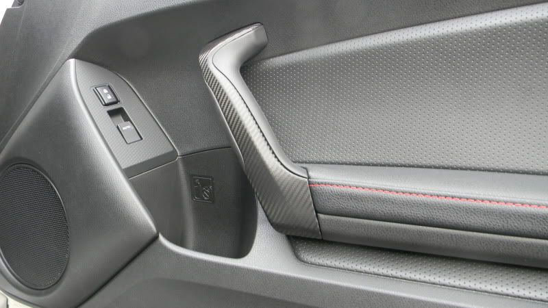

Hey guys, just wanted to show you how the interior looks with 3m vinyl. The 2 center pieces were pretty easy to do however the handles were a little more complex.
We are in development of full carbon fiber replacements though, so keep an eye out!

Does the center dash pieces just pull out? Are they just held in with clips?

For the center console, just pull the center out and then the right side comes out with one screw right?

Easiest way was taking out the passenger side piece first. You can do it by hand or use a plastic panel removal tool, its a few clips. Then when that's out you'll have a good grip on the radio piece and it should come right out. No screws at all.

That looks awesome. Did you wrap the 3M Vinyl around the edges of the panels or were they cut right at the edges? They look seamless.

I wrapped it around to the back. A little heat and persuasion does wonders.

this looks wayyy cleaner... I wonder if you could wrap those window panels as well... or even the climate control panel...

The silver parts by the climate control are next up to bat!

Don't understand what you did, need a before and after.
