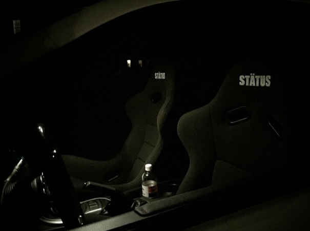

Just installed my seats. Does anyone know how to get rid of the annoying beeping warning sound?
