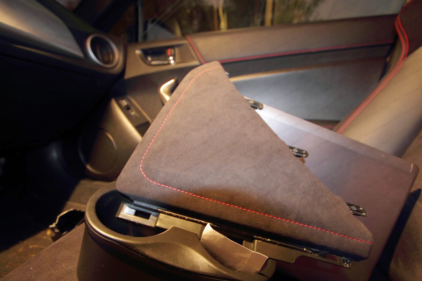

Now clip the new knee pad tot he grey / silver plastic piece.
Screw the screw back in.

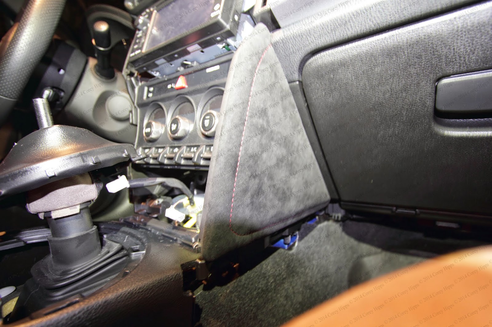

The assembled knee pad has three black clips that go into notches in the foot wells and has three clips that go in notches on the columns next to the HVAC and infotainment system.
It takes a bit of force to get back in, don't use too much though as you might damage a clip.
The reinstall is a bit awkward because you need to push it toward the center in order to get the clips on the grey / silver part pushed in.
Also you NEED to keep the center console pushed back while you do this or the bottom of the knee pad and the center console will push against other making your life difficult.

(Prior photo of the installed knee pads.)
