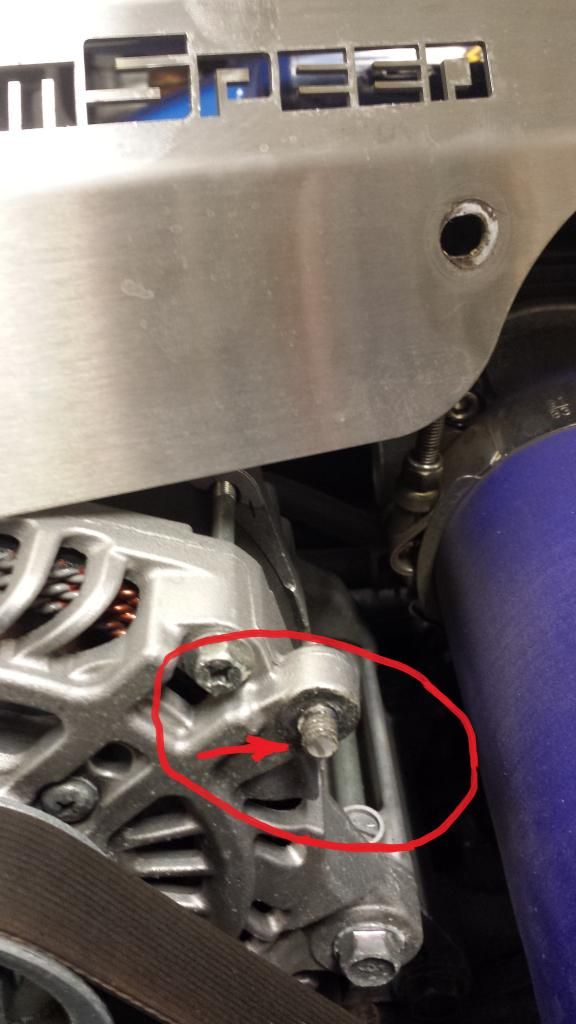

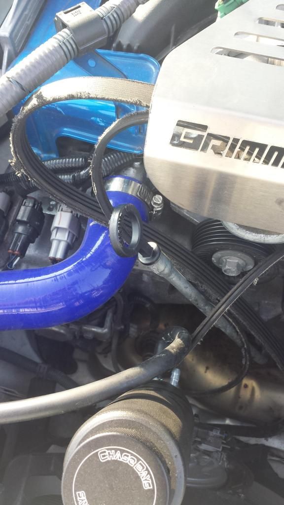

First Issue I had was the front facing bolt/washer just fell off one day while driving... Not to big an issue I called Grimspeed they shipped me replacement for about $15
Not too long after it fell off again... luckily it fell into a crevice on the engine block and I was able to retrieve it.
I learned my lesson I used a bit of lock tight on the Bolt and well this happend...
Bolt sheered off
And a broken belt...
Not sure what to make of this, Do I have bad luck or is their something else wrong here? Anyone else having an issue with it?

How much are you torquing the bolts?

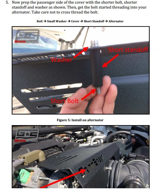

Did you use the right bolt?
From the pictures, it appears you've used the short one when it should have been the long one?

It was short bolt, short stand-off on the front side. and the long bolt, long stand-off on top.
Yeah, I think you installed it wrong.
I don't think so I installed it based on their "Install Instructions"

I bought during group buy, and I hadn't touched it until last night. Mine was secure and perfectly fine. Might want to see what the proper torque is for those bolts. I hand tightened them and haven't had a single issue.
P.S. Short bolt is def front facing. Long one is top facing.
Wasn't sure what section to post this in.
First off I have nothing but love for Grimmspeed!
I have had the Grimspeed cover for a few months now and it "Looks" good!
Bolt sheered off
I stumbled across this thread by accident today and I wish I had seen it sooner! Have you contacted us through PM, email or phone yet since it's been a month and I'm not sure this ever got noticed?
That definitely looks like a case of horrible luck. That's an extremely weird place for that bolt to shear as it is inside the sleave and not at an area that would see any sort of shear load. And the bolt is stainless steel so if you were to overtighten it it would strip the threads first. The only way I could see this happening is if you loctited the bolt in place, let it harden, and then tried to tighten it again at a later point, but that really doesn't make any sense. So it really does look like a case of horrible luck.
If you haven't contacted us for a replacement bolt yet please do, and mention the fact that I looked at this, and we'll get you a replacement bolt, because that certainly is a peculiar failure.
