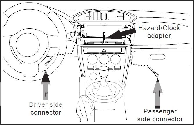

Originally Posted by JoonPrime View Post
i would like to do something like this as well, but unfortunately am so unsavvy with any type of mechanics or maintenance, its a wonder i was able to bargain for my brz!
Just buy the OEM footwell illumination kit. You only need a 10mm socket and a phillips screwdriver, but a plastic dash trim tool helps as well (available for $6 at Harbor Freight). The installation process is very simple and basically consists of the following:
1. Disconnect battery.
2. Remove bezel around stereo (it pulls off, but the trim tool makes it easier).
3. Remove stereo head unit (4 bolts and it pulls right out).
4. Disconnect stereo connections.
5. Plug the harness in.
6. Fish the harness wires behind the dash.
7. Stick the lights to the underside of the dash and connect them to the harness.
8. Put the stereo back where you found it.
The kit comes with an instruction sheet that has pictures (attached). Mods don't get much easier.
File Type: pdf Footwell Illumination Installation.pdf (558.9 KB, 365 views)
