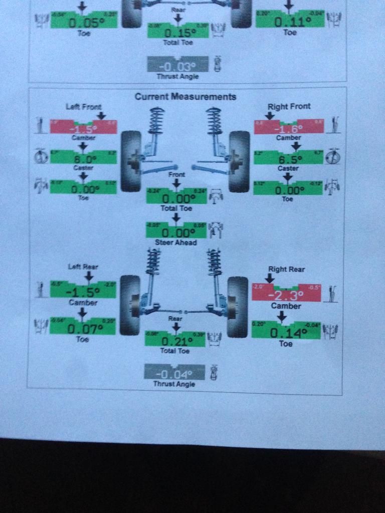

Hey guys, I just installed koni struts/rce tarmac springs/hvt top hats on my 2013 BRZ. Everything feels great, but I have a discrepancy with the rear camber.

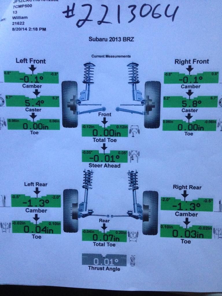

I got an alignment with stock suspension on 8/20/14 as part of my car coming back from the body shop (hit a tire) here are the after results. Pretty good, toe was just slightly off.
And here are the results from today after installing the new suspension
As you can camber is -1.5 on one side and -2.3 on the other. Is this due to an installation error? Or is this level of difference acceptable? I was jumping on the back right control arm to get the strut out, maybe I damaged it? I might switch the rear struts (if thats even possible) to see if that helps.
Thanks in advance!
Steve

Hahaha, I just spent five minutes staring at the first picture going, "Huh? It's identical side-for-side," before realizing there was another photo.
Don't you generally need to have things re-aligned any time you make any suspension changes?

There is some wiggle room in all the components when reinstalling. I'm betting that's where most of your discrepancy is coming from.

Thanks for the replies,
I got 2 alignments in the last 3 days
The wiggle room sounds like it may be causing the problem, but the "before" had 1.5/2.5f
1.6/2.3r,
So the whole right side of the car had excessive camber and toe. Maybe it just wasn't settled haha.
