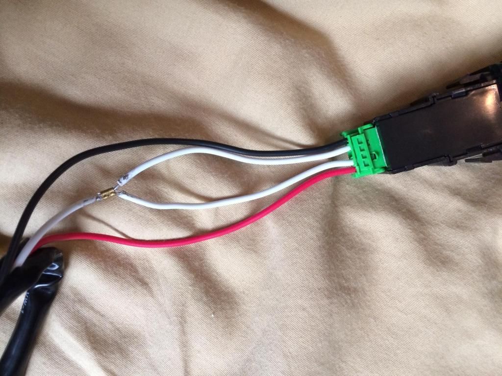

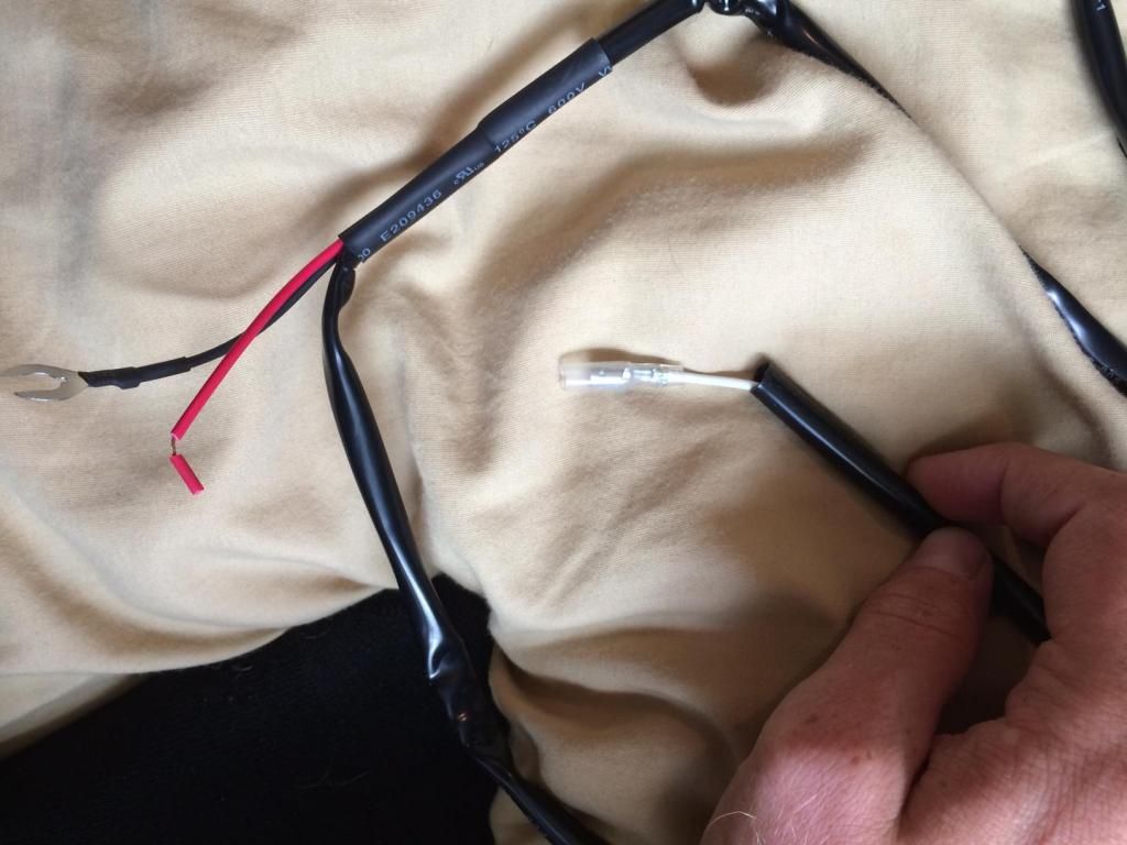

help wiring foglight switch
so I'm trying to wire my new foglight harness to an old switch i have, but heres the wiring issue.... the harness has a +/- wire mean wire here is the switch wiring (switch is also lighted). i don't get it. normally there is a +/- for the light and then 12v in/out for the fogs. what is this 2-1 white wire??

Originally Posted by Rican_D View Post
If I'm not mistaken that would be tapped into an interior 12v power source.
i get the red/black, but the white is the issue since i need to connect it to this

lbroskee
lbroskee's Avatar
Drives: 2023 WRB BRZ (MT)
Location: Coral Springs, SoFlo
Posts: 2,252
Thanks: 1,503
Thanked 534 Times in 430 Posts
Mentioned: 42 Post(s)
Tagged: 5 Thread(s)
Originally Posted by Chimera View Post
what switch is this?
switch from Nigel JDM Parts, but i wired it to a harness from Diode Dynamics (way better)
I ran red to battery, black ground, white to my red trigger wire, and then ground my black trigger wire. Also red harness wire to battery and ground black harness wire. Now fogs work with car off or on (i wanted that)

yeah I see what your issue was since the diode kit is originally designed to tap into the headlight or parking light harness.
