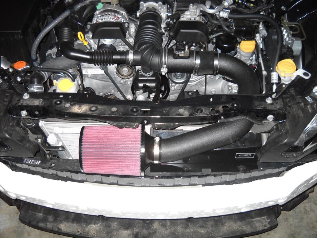

I installed the new Mishimoto CAI this weekend. I figured i would put a couple hundred miles on it before i wrote out a review. It took me about two hours to install it from start to finish. It can be done faster but it was my first time taking off the front bumper... also i didnt lift the car up on jacks.
Here are some pics..
My current set up is Stage 2 E85 EL with nameless axle back 5"track pipe and the CAI. So once i dyno, i really wont have a good way of seeing the gains it gave me... if any. Even though the butt dyno feels like its better, at times.
So once installed, i reflashed the ecu and took it out for a good hour of learning time. Finally got on the throttle after 50 miles and was kind of disappointed. It felt slower. It felt like the motor was working harder to make it through the rpms. I shrugged that run off and tried another at WOT... it felt the same. I did a few more runs before i called it a night, it seemed to pick up a little bit, but not much.
The next day i decided to get some fresh e85 and try it out again. First attempt at WOT was great, it felt like before the CAI only maybe a little more. It felt like it was still working hard to get through the rpms but it had livened up since the night before.
I did notice one draw back after installing the CAI. The throttle has some lag in it from a normal stop. I noticed this instantly backing out of the driveway. It has gotten better after driving it for a couple days but is still there.
I know this post doesnt prove that this CAI makes 10 + hp like the manufacture claims, but i figured i would put out a review on installation and performance. I will be going to the dyno soon, after i get my OFH and will post those results later on.
I do believe nelsmar had won the give away for the new CAI and may have a dyno sometime with just this CAI on a stock car, but i could be wrong.

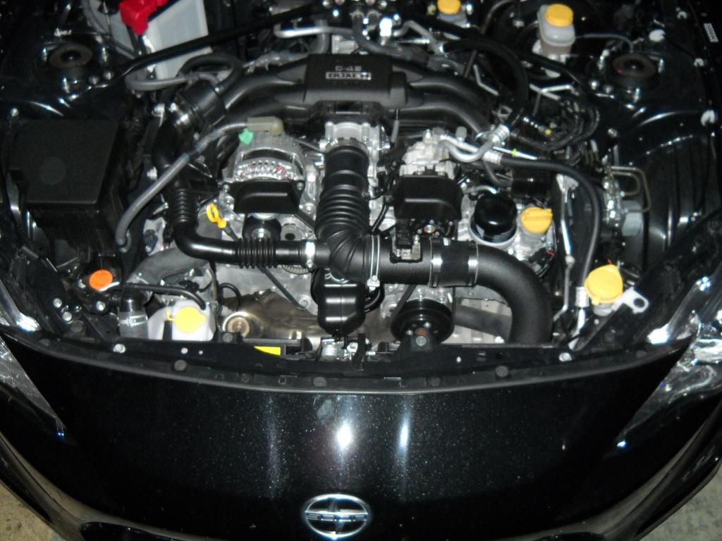

I just did the same install. I experienced a serious drop in power (hesitation) at about 4 thousand RPM while accelerating through the gears. It did not worry me much as I have experienced this many times setting up a new carb on bikes and cars. Adjust the accelerator pump..do a plug chop to see if its from to much or to little fuel etc..
of course those days are pretty much over ..for the injected ECu adjustments are needed..our ECU has the capability (within limits) to do so on its own.
I wanted to help the ECU learn the new set up faster than it would under normaly driving conditions..One of the vendors (Grimmspeed?) who does tuning mentioned this is a very fast learning ECU. He was right
I got rid of the hesitation in less than 30 miles ..this intake has some unique sounds..I like it...at a certain rpm it almost HONKS...ha ha ha..
What I did
I found a hill and helped out the ECU learn the new set up.
I went through the gears one at a time (1st-3rd) .. and held the throttle at 500 rpm intervals from 2 grand through 6 grand in for at least 3 minutes in each gear...you would never do this in normal driving of course. I have done some data logging on my bike and this is what's needed to accelerate the ECU adapting to the new setup. You need to do it at 1/4 throttle through full throttle at each of the rpms I mentioned...this is where the hill comes in handy..You can get some serious rpm at the different throttle inputs and still keep the MPH down...for 4th through 6th..your going to need a safe,cop free, low traffic, long stretch of highway. .....or a dyno.
If you don't have a a safe,cop free, low traffic, long stretch of highway..a dyno could be a lot cheaper in the end.
