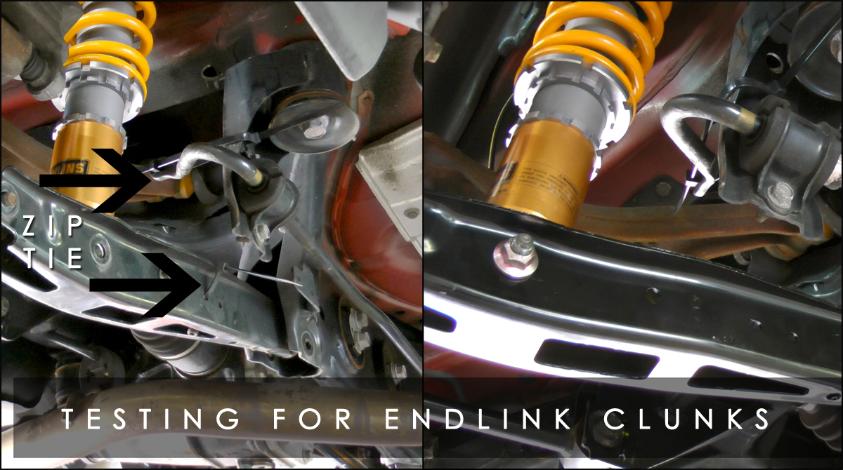

Did you receive any new endlinks with your coils ? I had the same noise as in the video and it was coming from the endlinks I installed that came with my HSD coils. The problem wasn't the end link itself it was actually me not being able to tighten them properly at the part it connects to coils. The reason it was loose is because there was a gap in thread on the endlinks after it sat on the coils. So I just bought some washers and was able to reduce the gap just enough to have those end links tightened.
Also, if you didn't relieve any endlinks it could be that the stock endlinks are too big and hitting against the LCA. You can check on your LCA for marks if that is happening.

Hey guys, just thought I would get back to you about the rattles. I took my car to a suspension shop and they found that the locking nuts on the adjustable end links on the front had come loose. Apparently the small amount of backlash in the thread was enough to make it sound like my car was falling to pieces because it did the trick.
I only have a small noise in the rear now but I think that is only due to the stiffness of the coilovers, possibly all the junky foam in the boot.
