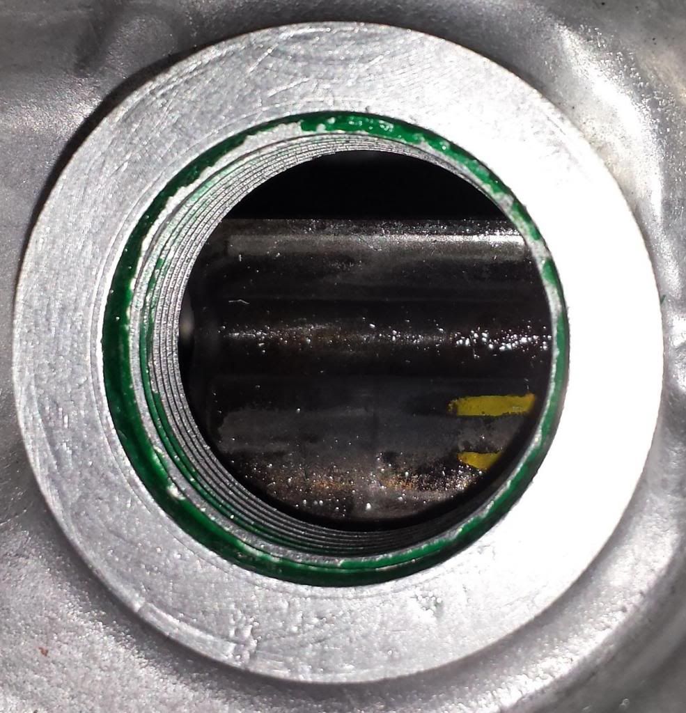

I know the install directions say something like a 30 minute install. If everything goes right, it could be that fast. If stuff goes wrong it could take MUCH longer. Do yourself a favor and have a can of carb cleaner, lots of rags, and lots of patience. There was a metric crap ton of locktite on my bolt which prevented me from re-installing the bolt. Rags soaked in carb cleaner rubbed in the threads to remove the locktite is what enabled me to finally get that bolt back in.
DO NOT try to put the right side bolt back in with a ratchet. I repeat, DON'T use a ratchet at first! You need to get it hand threaded first! Make sure the transmission is in neutral before you take those bolts out as well.
There have been many cases of people getting impatient and having it cross threaded, only to have to have their car flat bedded to a dealership for a new transmission housing. Take your time and get it hand threaded and everything should be fine.

I did read about this issue soon after and got a bit worried.
How tough do you reckon the job would be on a lift? I heard that 27mm bolt is tough to open up because of the loc-tite as you mentioned and can only hope a lift would make it a bit easier.

The bolt threads were leaking tranny fluid onto exhaust and causing smoke and stink. Toyota sealed the threads and now no more stink and leak. Love the mtec shifter springs.

On a lift would be MUCH easier than on stands. Part of the problem is access to the bolts. Its a tight fit up there and even with removing the front pipe removed there is only so much room. I didn't remove my front pipe when installing mine but I can see how that would help a little. The bolt is in a spot very close to the trans tunnel and trying to get your hand up in there to get it hand threaded means your arm is going to rub on the transmission housing because of the angle. I'd definitely wear gloves (latex or even a set of ringers) if you can still have enough dexterity in your fingers to manipulate the bolt. Either way be prepared for some minor abrasions from the rough casting on the trans. When I finally got done with my install ~5-6 hours later (over two days) my right hand was worn raw. You can see on the pictures attached below how bad the locktite can be on the threads. I ended up using a shop towel soaked in carb cleaner and a small pick set to get all that crap out of the threads before it finally went back in.
You don't have to get it all off, just enough to where you can get it hand threaded a couple of turns so you don't risk stripping it out. You'll notice on the picture that the threads start at the bottom on mine. You can look at yours and see where the threads start and position the threads on your bolt to help you get it positioned to where you can get it threaded. Then again, it might thread right up and you won't have any of the issues I had.

It depends. If you install them incorrectly and strip out the threads on the transmission housing from the large bolt because you got impatient and tried to reinstall it with a socket instead of hand threading it, I wouldn't expect subaru/scion to replace your transmission housing under warranty. As for them denying your warranty from a transmission failure after the fact I highly doubt they would notice the springs upon a disassemble/rebuild. They look almost identical to the stock ones, but hey, stranger things have happened.
