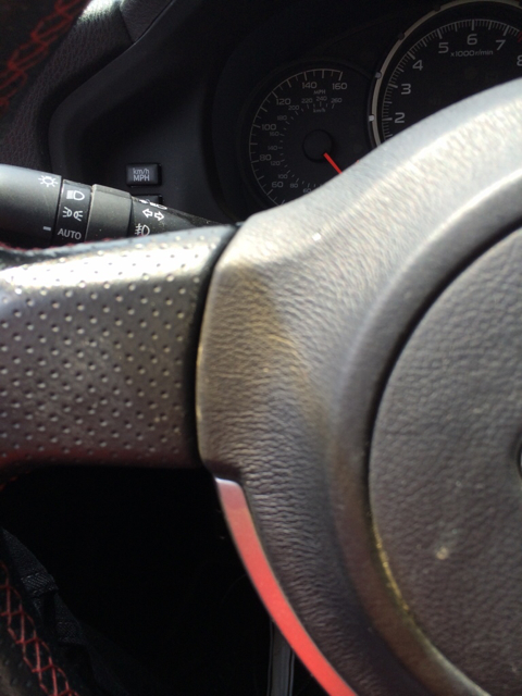

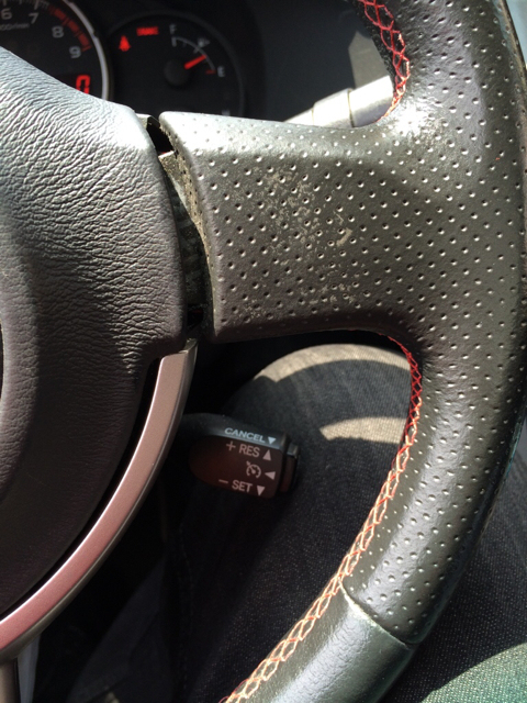

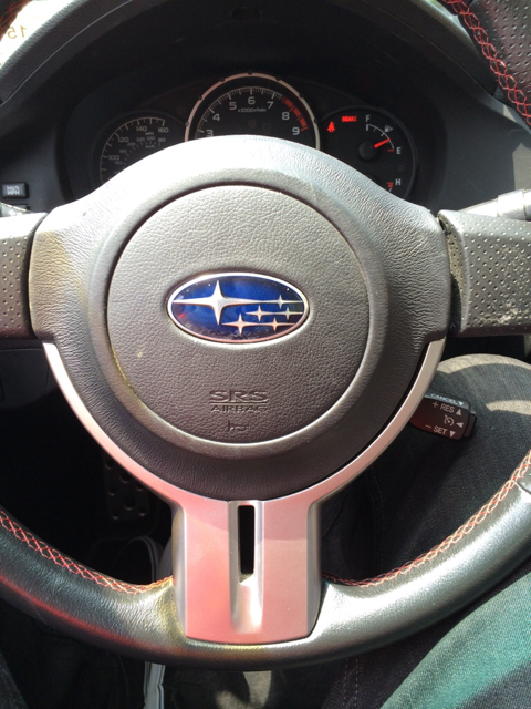

Anyone else have this issue? Not a big deal but the unequal space annoys me sometimes.

Did you bend your steering wheel? It looks bent.

I don't believe so, it looks good when I look at it.

I'm noticing this now also. It isn't anywhere near as bad as yours but the right side has a little more of a gap now.

The airbag module is held in by 3 bendable metal clips in a hole behind each of the steering wheel spokes, including 1 just behind your problem area. The clip might be loose? Try pushing that area of the airbag module to see whether it 'clicks' back into place first?

I've been able to bend steering wheels by simply pulling on one edge with enough force, it's not that difficult to bend.
But OP's pictures are from a straight on angle, and even though the gap is visible there's no way to tell if there's vertical seperation (which would suggest the steering wheel cover material lifting or center airbag seperating).
Maybe additional pictures would shed some light on this.
