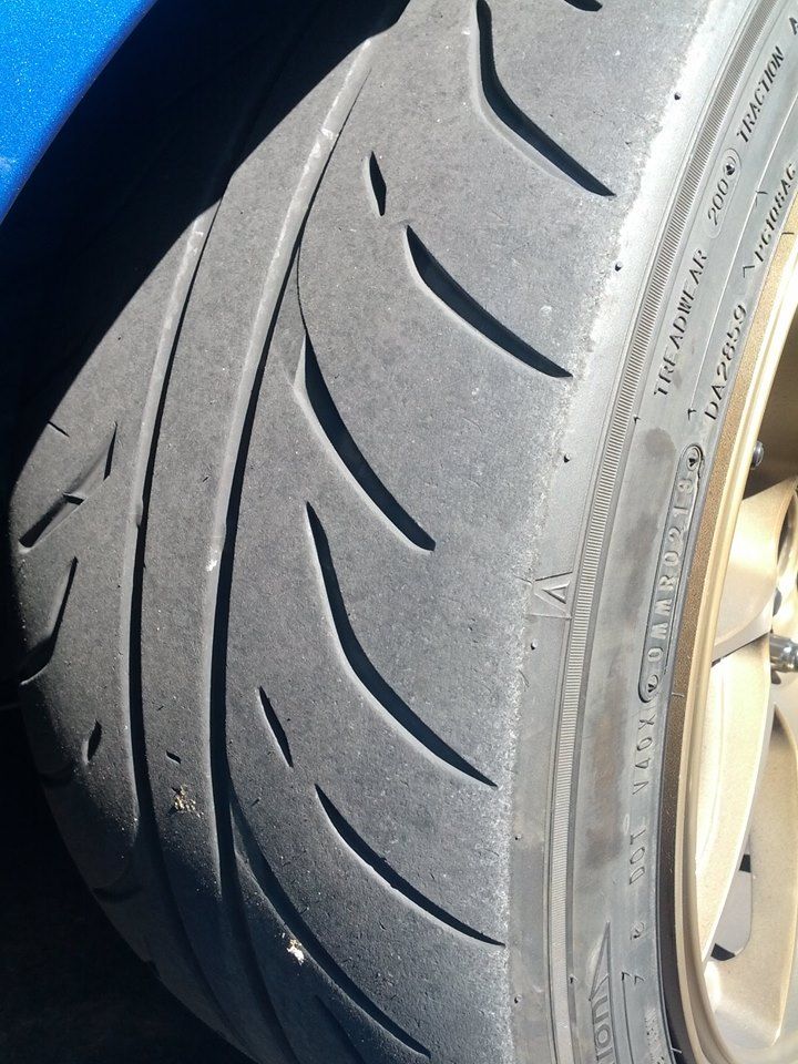

Is there a way to tell if a tire is hear cycled out? Is that a thing? I don't know if my Z2's just got too hot today but my last autocross run they seemed to fall off a bit. I only ask because I have a slightly fresher set I can get mounted on before next weekend's ProSolo.
The tires in question have approximately 21 autocross runs on them and 1 track day with 4 20 minute sessions (1.6 mile course, pushed pretty hard).
I realize this is vague, but a shot in the dark for anyone who may have insight.
Thanks!
