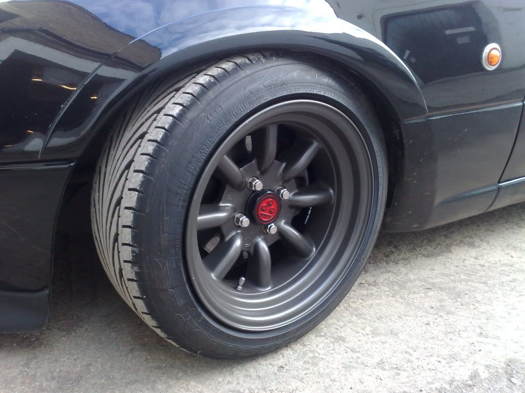

Here is pic for reference.

3mm spacers are pretty cheap and will fit on OEM studs, you might try that to see if it helps.

Want to replace wheels with correct offset and width, so was asking what size would be better.
