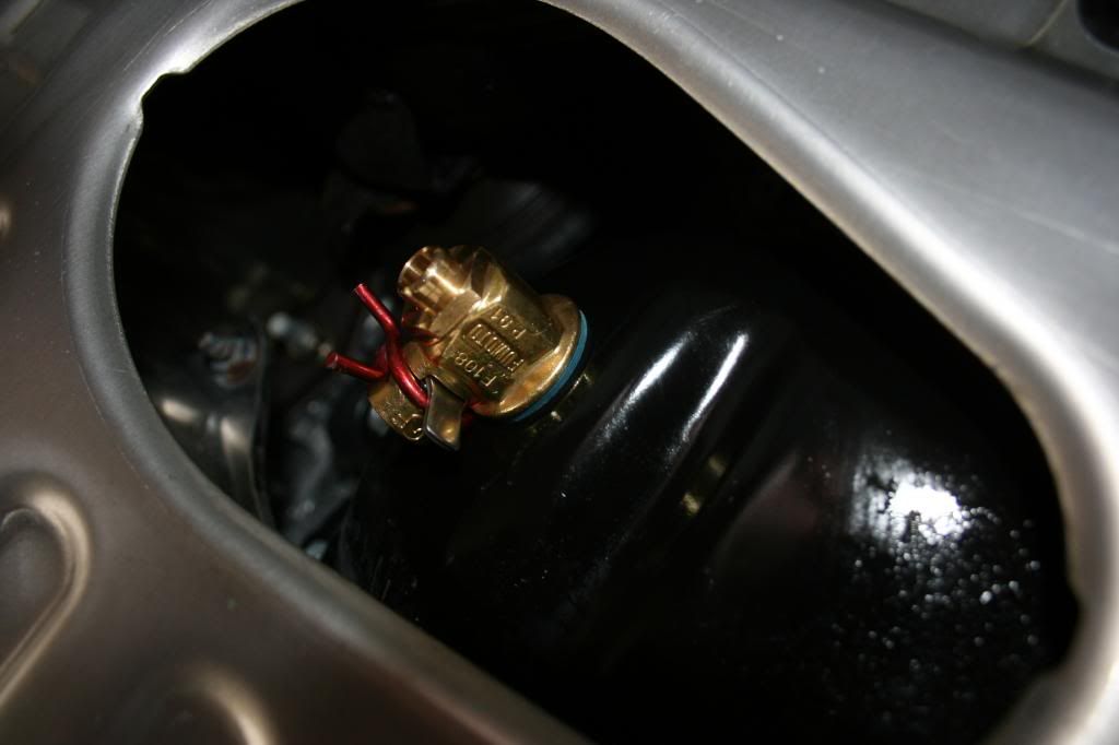

I thought now would be a good time to install a fumoto valve as well. I have heard good things about them before and since the 0w20 comes out like water I figured this would help avoid spilling with the use of the drain hose.

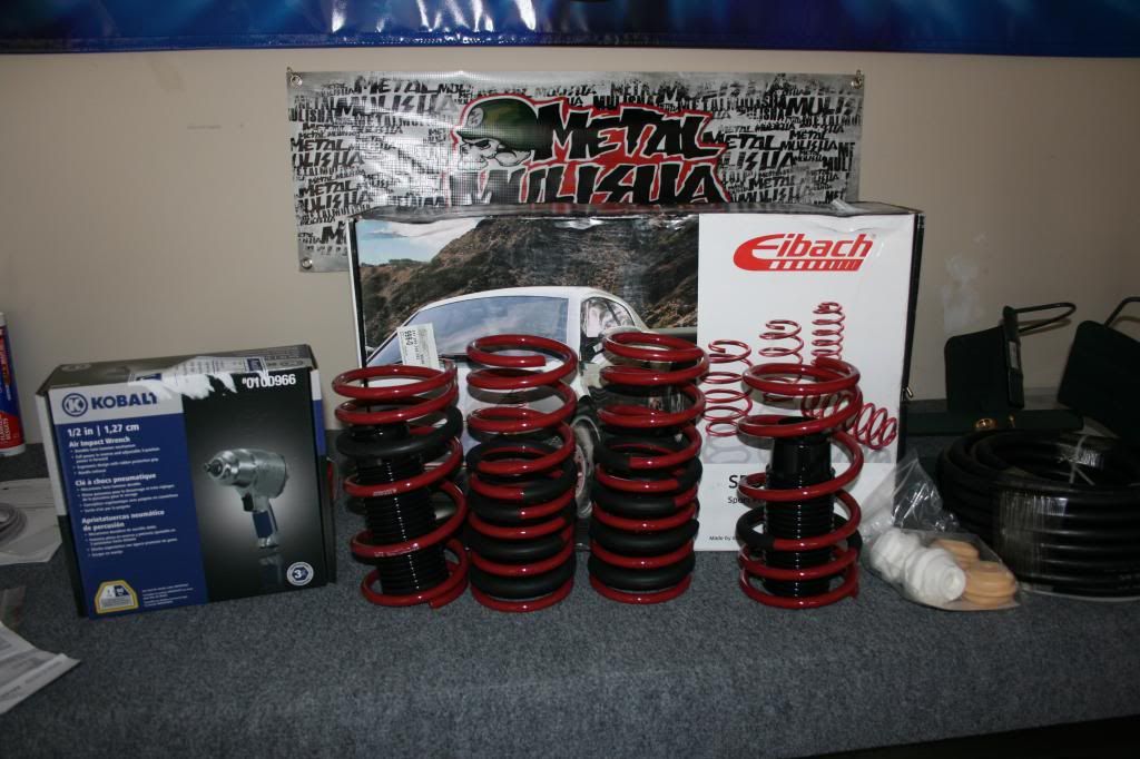

Good Friday install Eibach Sportlines
I have done quite a bit of research and thanks to other on this forum I knew I would want an Eibach product. I have never used them before but then again I don't have much experience lowering cars I have only done it twice once with Vogtland springs on an E36 BMW and another with I believe Skunk 2 Springs from eBay for a Neon I had back in High school.
So even though according to most the review the ride quality was almost like stock with the Pro Kit I knew I wanted to lower look of the sportline kit.
I purchased a set of Sportline from eBay for $222 shipped couldn't beat that!
With Good Friday off I decided I would spend the day in the garage while my wife was at school
I would like to say thanks to DarrenDriven for his awesome very thorough write up on spring swapping. With that I decided to try his shade tree method of removing the spring without a spring compressor and use an impact. I never had an impact wrench before so I was amped about purchasing the new tool I went with a Kobalt from Lowes but after the install returned it for an Ingersol Rand. The CFM need on the Kobalt was 7 @90psi insane smh.
The install went great the impact wrench method was awesome! and overall the look is exactly what I was looking for!

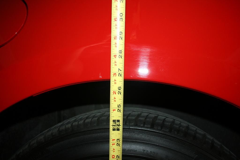

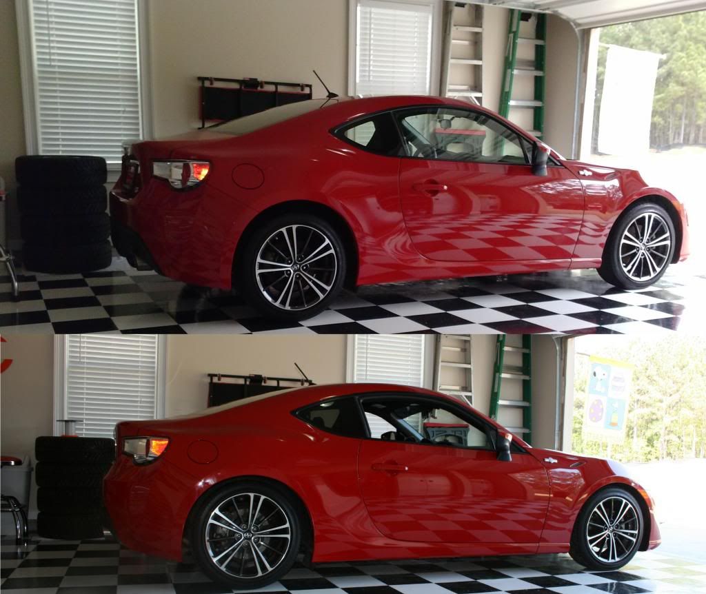

Before and after Rear measurement from the ground to Fender
Before Rear
After Rear

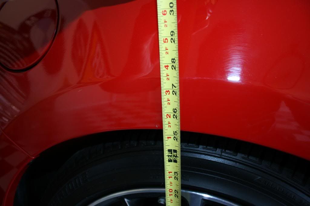

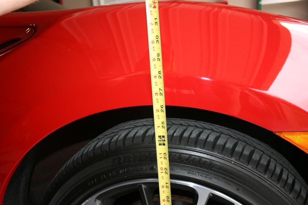

Before and after Front fender from the ground
Before Front
After Front

Eibach Drop Measurements after sitting for 3 days in the garage no miles logged yet
The car has not been driven since the install but after three days of sitting here were the specs from the fender to the
Before After Drop
Front 26 1/4" Front 25 1/8" 1.125"
Rear 26 5/8" 25 1/4" 1.375"
The rear was almost spot on with the 1.4" drop that Eibach stated from the sportline kit. I am hoping the front will settle a little more after I log some miles on it. Overall I am very happy with the results I fell the car should have come from the factory like this. The fender to tire gap is virtually non existent anymore.

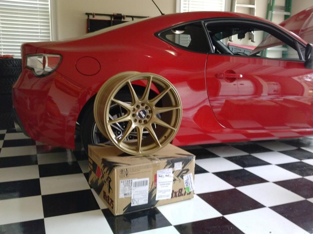

XXR 527's 18*8.75
My next mod will be to get tires mounted on these and put them on the car. I will hopefully be doing that at the end of the month.

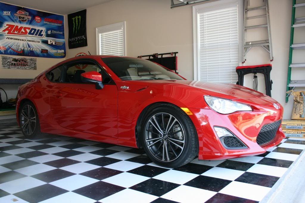

New Wheels mounted
Gold XXR 527 18"x8.75" +35
Kuhmo Ecsta AST 225x40x18
LOVE IT!

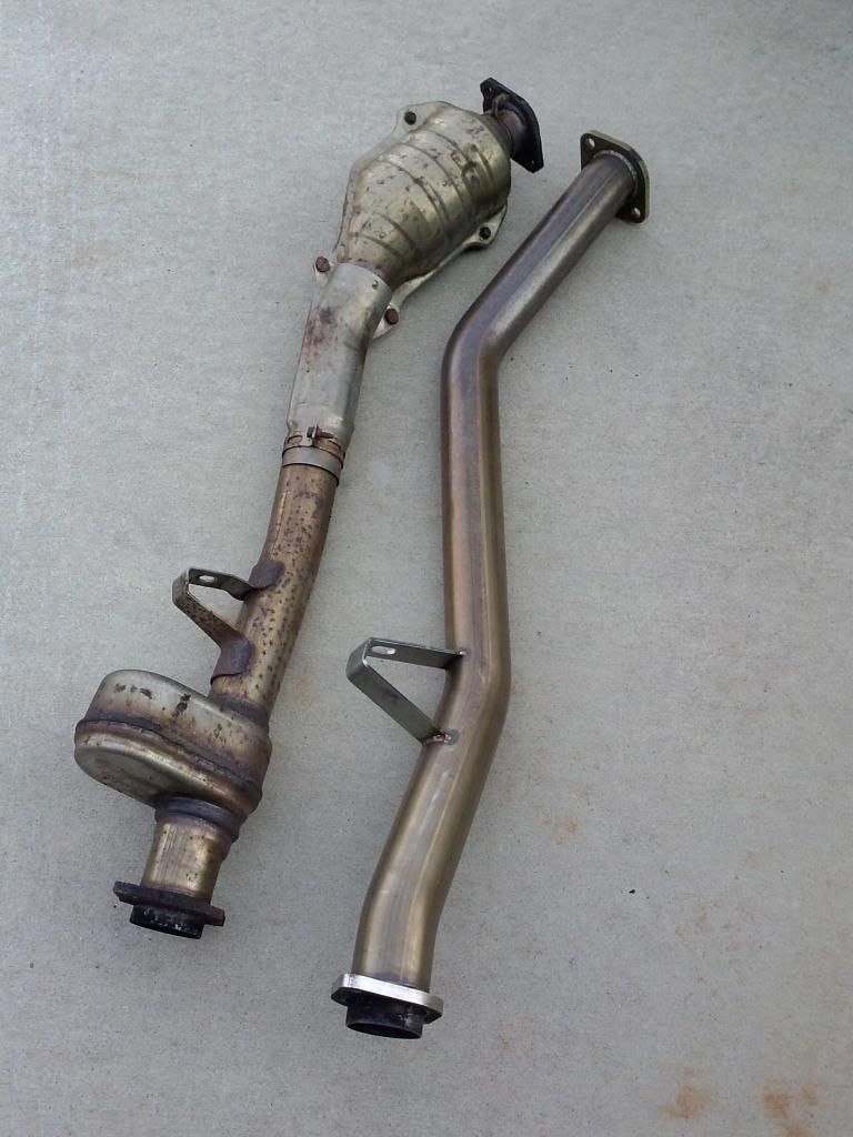

Installed a Berk Technologies Front pipe installed last night thanks to TONY_BRZ.
I could not believe the amount of oxidation on the OEM pipe with only about 8k miles on it. That previous owner lived in Chicago you can tell that winter was hard on this car. I'm sure she's happy to be down in the warm salt and mostly snow free south.
I have slight exhaust leak where the front pipe connects to the mid pipe. OEM Gasket cracked off on the bottom but I think I found a cheap like $3 easily available replacement gasket at Advance Auto. Should get that all fixed up this weekend. I can't believe that prices looking around at Grimmspeed (granted its thicker but still) ft86speedfactory ext ext $20+ for a $3 gasket.... smh
Took it for a drive after now paired with the resonated Perrin Cat back system I have achieved the sound level I was looking for. Will have to wait till the leak is fixed before I can fully butt dyno it lol
