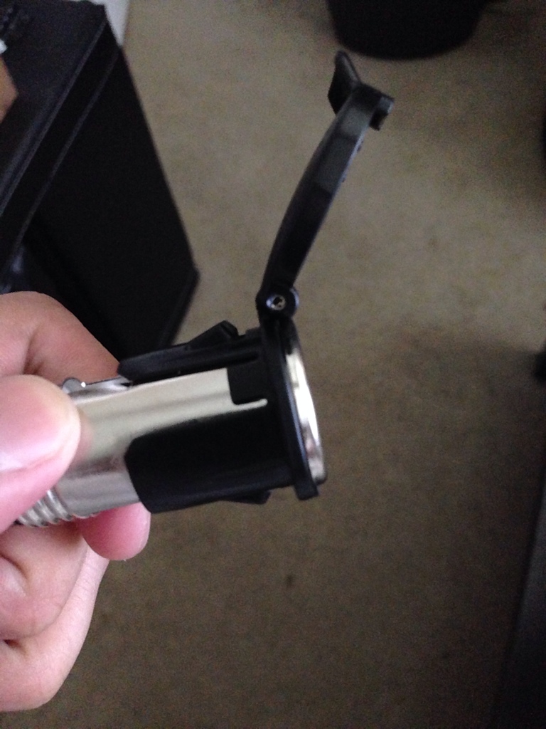

Size:  242.1 KBName:  ImageUploadedByTapatalk1397158893.523995.jpg
Size:  274.2 KBName:  ImageUploadedByTapatalk1397158904.874025.jpg
There ya go!

Damn, that's worse than I thought, it looks like the black piece is what's actually holding the outlet in place, with those black clips I doubt I could remove it and have the metal outlet still stay in place. Damn, maybe I can slide the metal pin out of the hinge to at least get rid of the annoying lid =/
