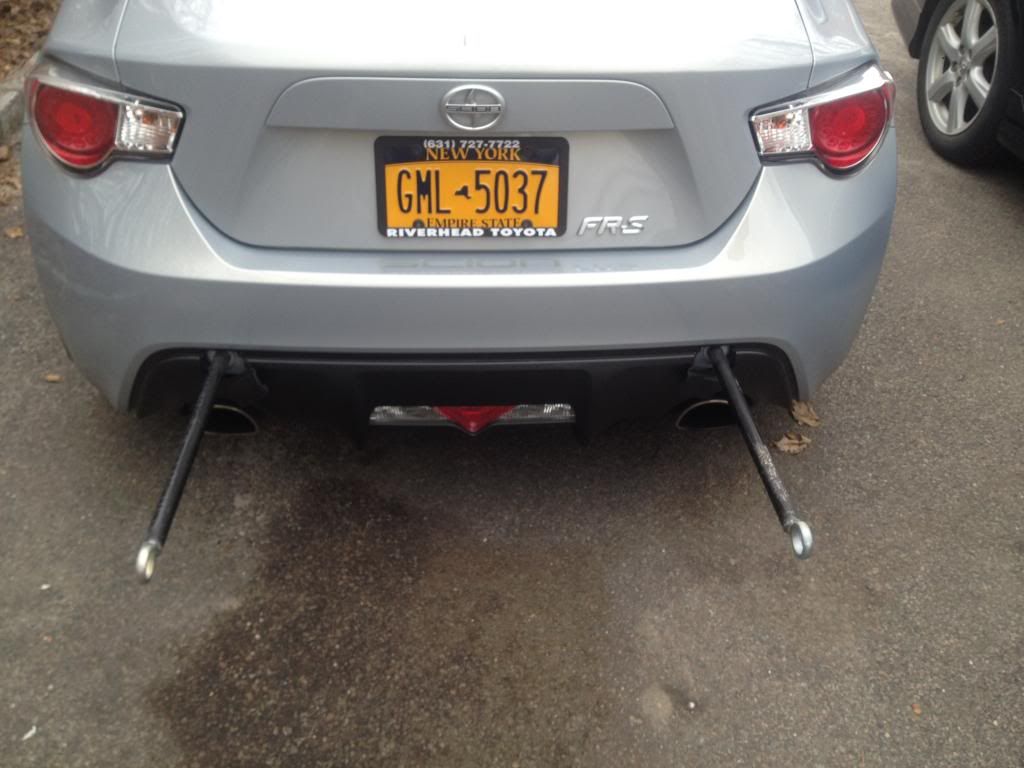

I will give credit when credit is due. I essentially used @that_guy 's idea in a slightly more crude fashion.
I don't have access to a fancy machine shop and all that jazz, but I do have a welder. So where he had a one-piece aluminum setup, mine is 3 pieces and made of steel.

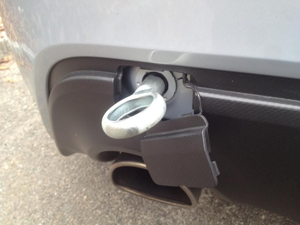

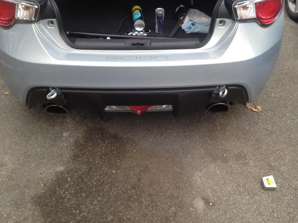

So here's what I started with…I purchased two new tow hooks from my parts department

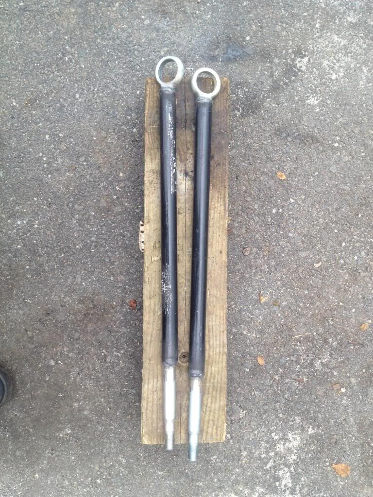

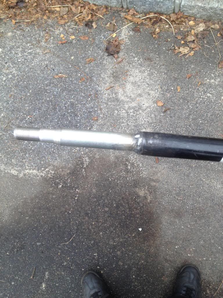

I then hacked off the loops, and cut down two 17" steel tubes (.250 wall 1")

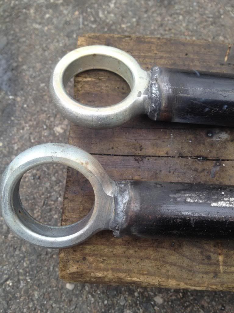

Then I stuck an orange slice in my mouth and got to welding. Welded the steel tube onto the very end of the tow hook (I'd liked to had sleeved it further but in order for them to stay tight, the tapered portion of the tow hook would have to seat)
I was left with some open tubing on the end and I wasn't sure what I wanted to do there. I contemplated some rubber caps just to cover the open ends, or maybe welding some round plate onto it to seal it. I ended up using the loops I cut off the tow hooks just to "finish" it off…

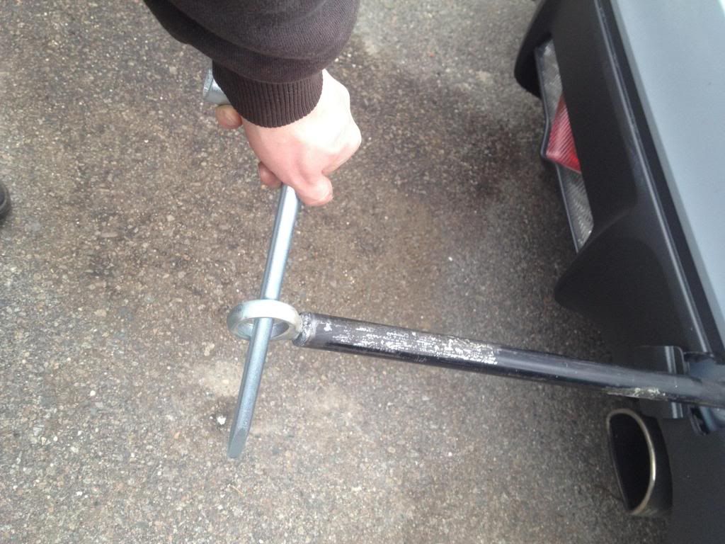

…and as an added bonus I can use the loops to make sure the bars are tightened down to TAF specifications
test fit

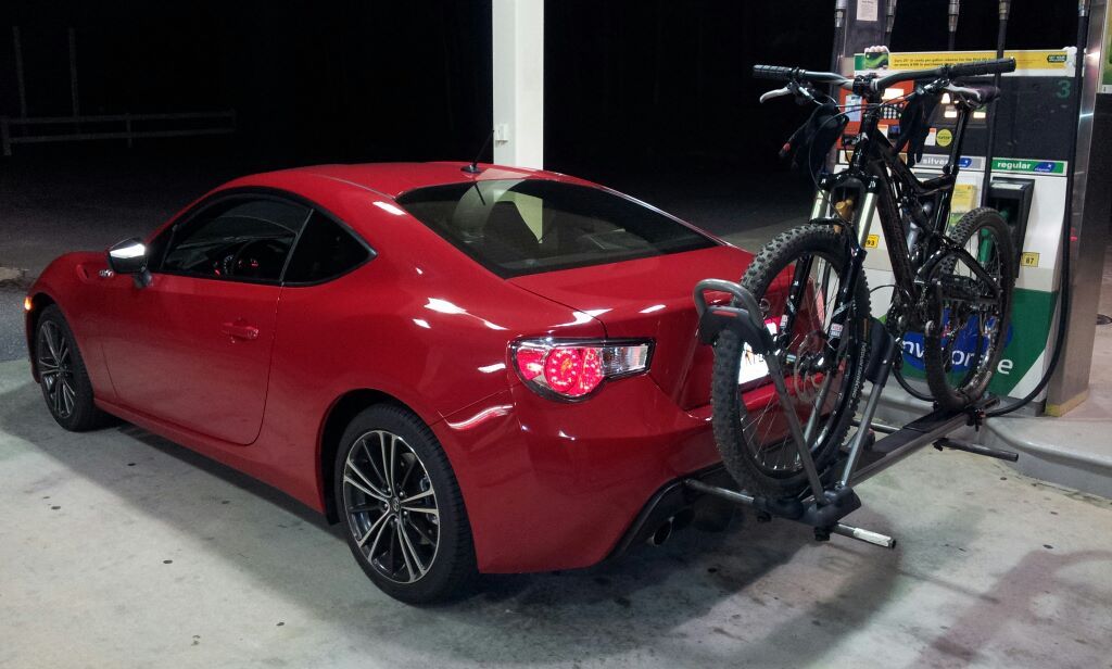

and yes, they're strong…I'm about 150lbs, my bike is 22lbs

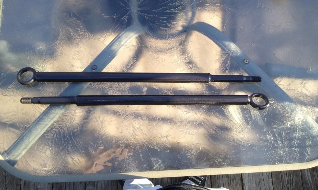

Finished product after a coat of Rustoleum Hammered Black

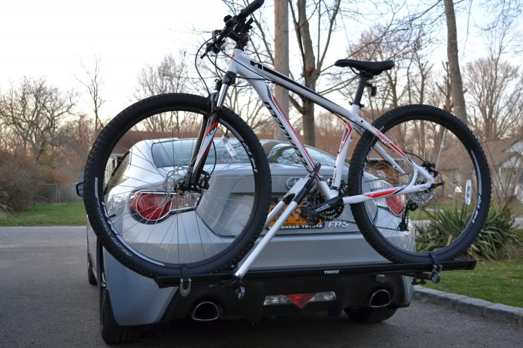

Installed with the Thule Big Mouth
aaaaaaand with my new 2014 Specialized Hardrock Sport Disc 29er
This image made me cringe.
Overall, great DIY solution.
Thanks! Why would it make you cringe? They're beefy!
Originally Posted by Zozr View Post
I'm still unclear how a bike will sit on those poles
Exactly like this:
You can literally lift the entire car from those tow points. I think they're strong enough to support 75 lbs each.
