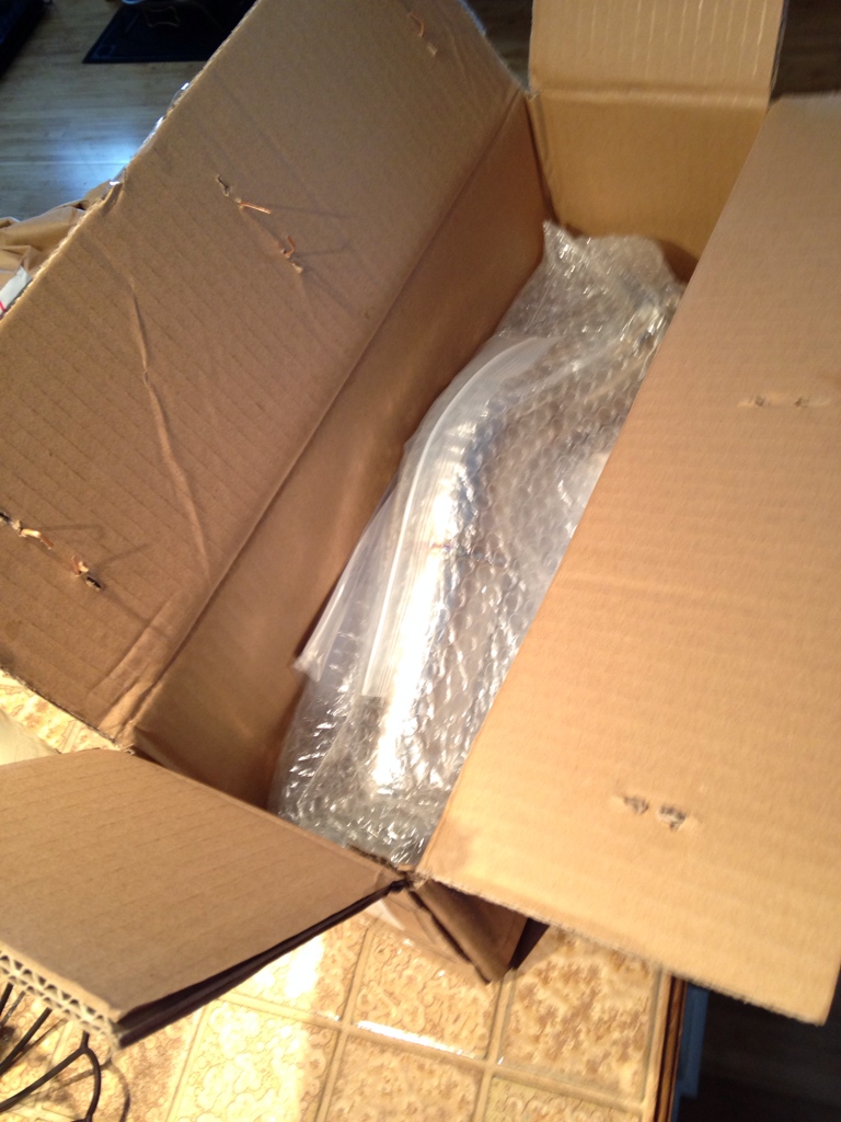

A pipe is a pipe right? The 100 dollar DC Sports overpipe review.
So just got this in after finding it on eBay for 100 bucks shipping included.
Size:  237.4 KB Pretty light box. Name:  ImageUploadedByTapatalk1396472659.865563.jpg

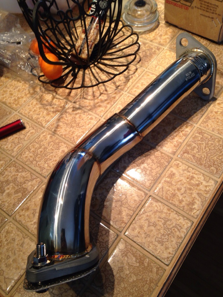

I've installed the DC Sports uncatted, unresonated test pipe and it fit perfect with good welds and thick flanges. Upon taking the bubble wrap off this over-pipe I came face to face with what I can best describe as a "Frankenstein" pipe lol. Three sections with a different diameter pipes welded together to form the over-pipe.

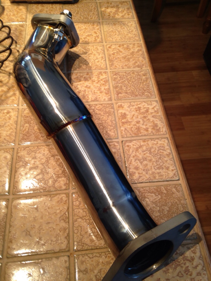

Its definitely the ugliest over-pipe currently available however, the welds are crappy!

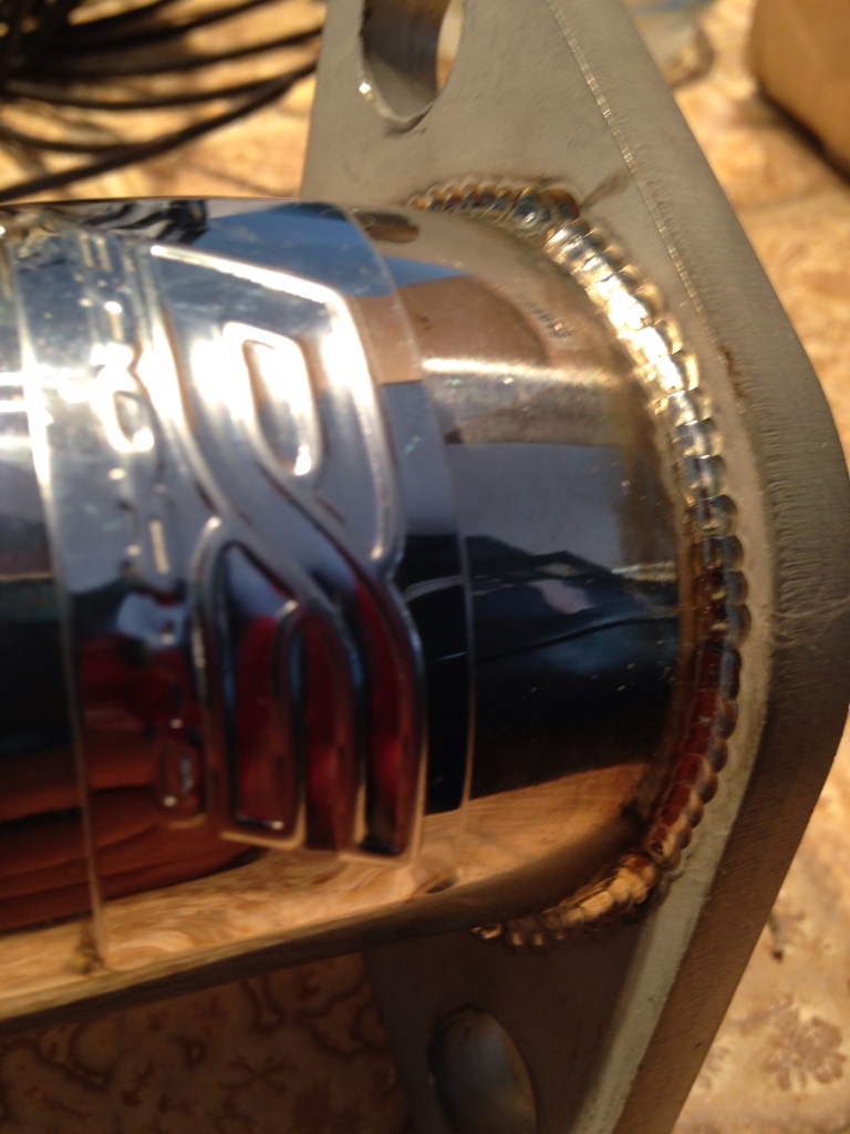

Flanges look to be .5 inch thick. Same flanges used on their test pipe. I think they're pretty stout and way better than your typical no name eBay exhaust flanges.

Interior of the pipe looks like it flows well and the inside edges where the pipe meet the flanges (inlet and outlet) have been ground smooth. Not bad for 100 bucks IMO. I'll update after install tomorrow to see what the sound, power and fitment is like. Oh sorry, only have access to a butt dyno..

That pipe sure doesn't have much bend to it. Interested to see if you get any rubbing\fitment issues.

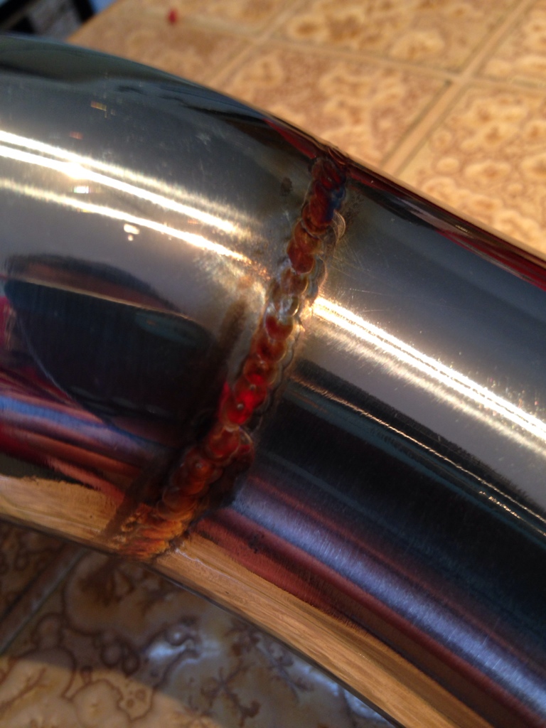

Those welds look to be a line of tacks more then a consistent bead. Its not the best picture but when a weld looks like a bunch of fish eyes that someone going along, zap, zap, zap. It works but often thins out the metal creating a weak point. This is a cheap and easy version of fusion welding.
This weld has one "fish eye" where the weld ended after going around. Also notice how this weld bead does not have that under cut concave face to it, thats because filler was added rather then just letting the two parts melt together.
I personally hate the "pipe is a pipe" argument its just a lack of information and people trying to justify buying junk.

Pretty bad that they can't get the length right. Fab guy must have had a few too many when he built the jig.
Or they're eyeballing them....lulz
