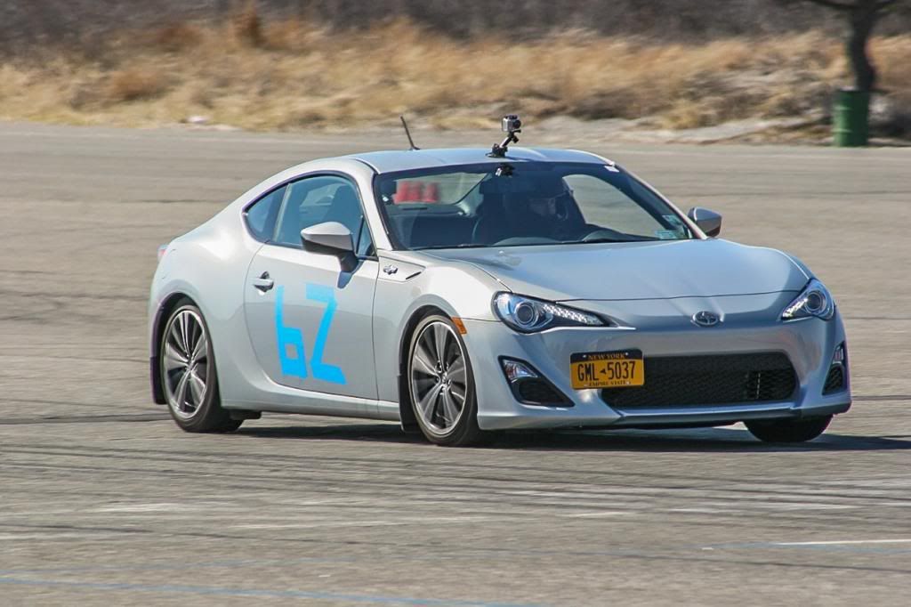

RIDE HEIGHT:10
Ride height is PERFECT in my opinion. Just enough fender gap to stuff a slightly bigger tire but not sky-high like factory. This is how it should come from factory. I found the springs to sit slightly lower than Tein specified but I did not measure to confirm. Car gets on and off the two-post lift fine with no rubbing or scraping.

Action Shot:
2013 Sc10n FR-S 10 Series

No pics how dare you

updated with pic
