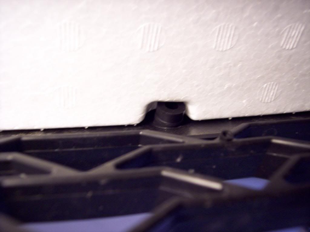

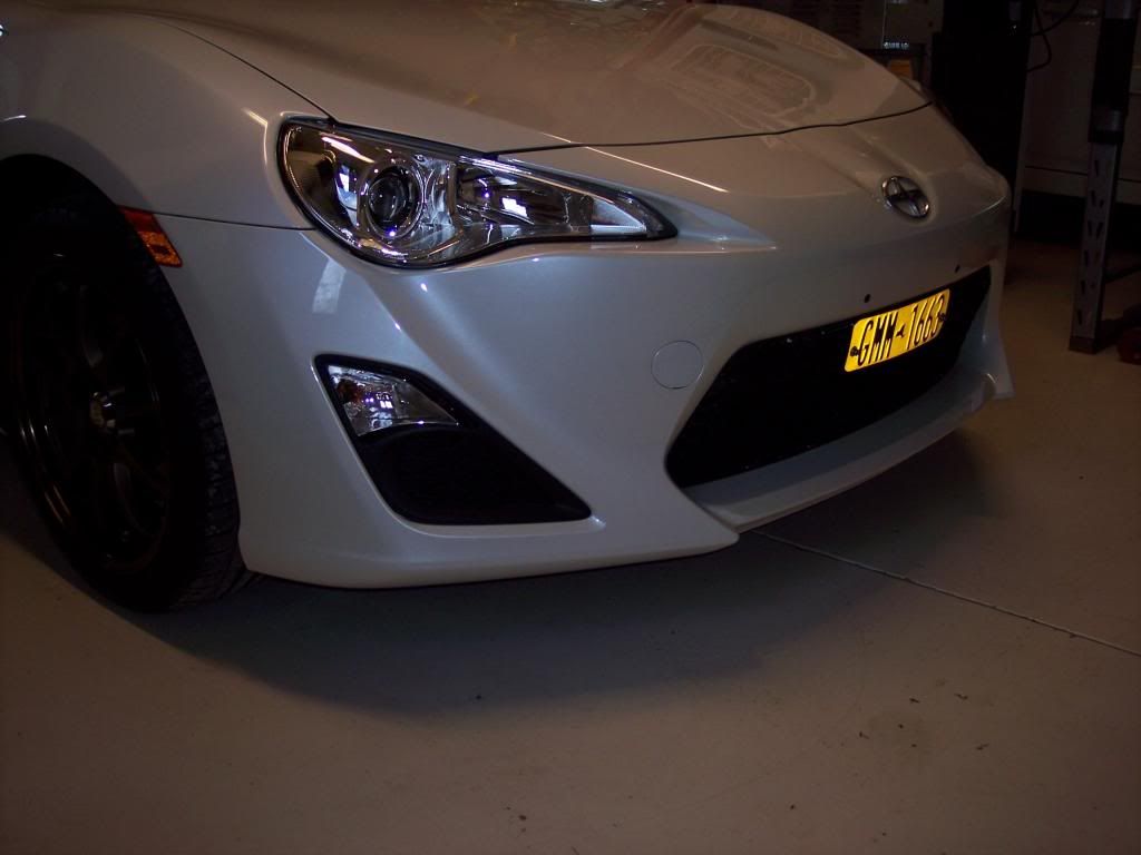

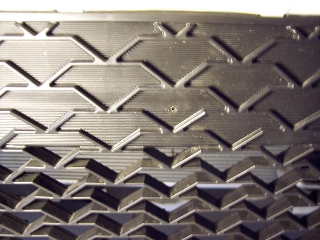

Here is another way to mount the front plate. I did something like this for years with Spyder. On the FRS there are some molded in bosses on the grill that I used.
You can locate them by two molded index marks on the front. Here is one:
The boss is on the backside. you do not need to remove the lower cover. I did to investigate and take a picture.
Drill the spots with a 3/16" dia drill and run a M6x1.0 tap thru.

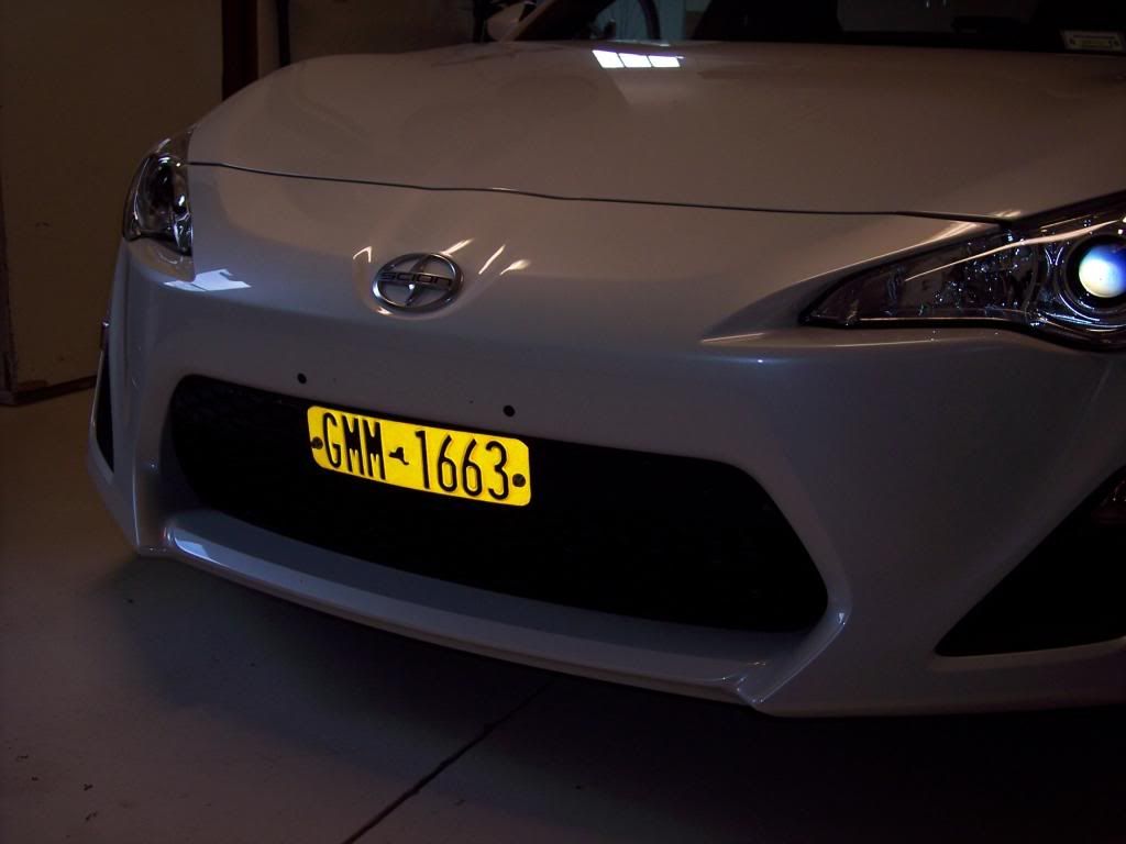

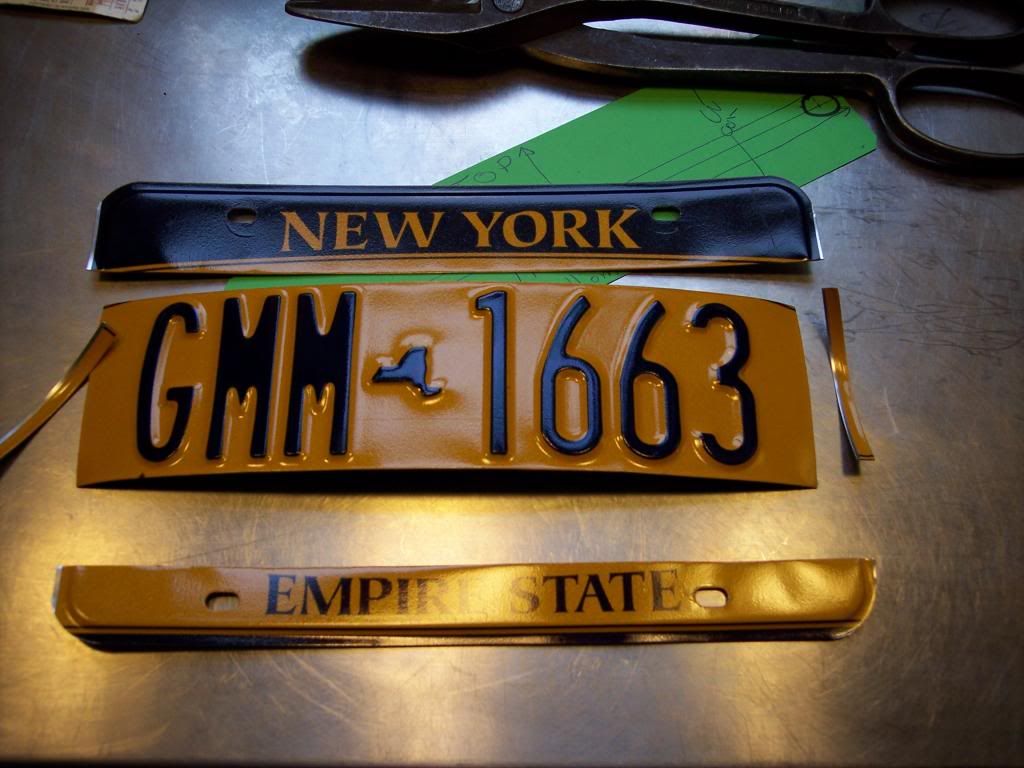

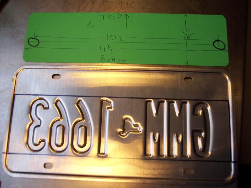

Modify the plate like this:
I attached it with some stainless M6 screws.
To finish I put some trim plugs in the holes from the dealer installed mount. The only thing I would do differently next time is use my sheet metal brake to create a hem on the top and bottom edges.
