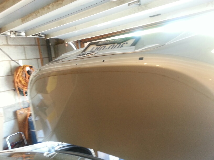

Sorry but these only pics I could find. It's real easy to remove, just be careful not to break the plastic clips. There in no 3M tape, just a foam "gasket"
Attachment 69376
Attachment 69377
Ahh interesting .. Was hoping it was just Tape .. As i wouldn't even know where to start about on covering those holes up .. or if anyone here knows the duck bill type would cover all those up well?
