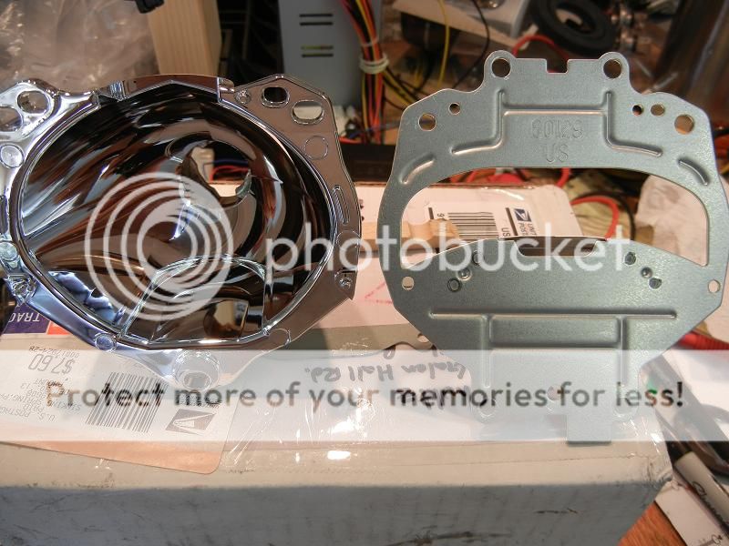

To bend the squirrel finders, you need to remove your bulb. Look inside the light, this is what you should see:

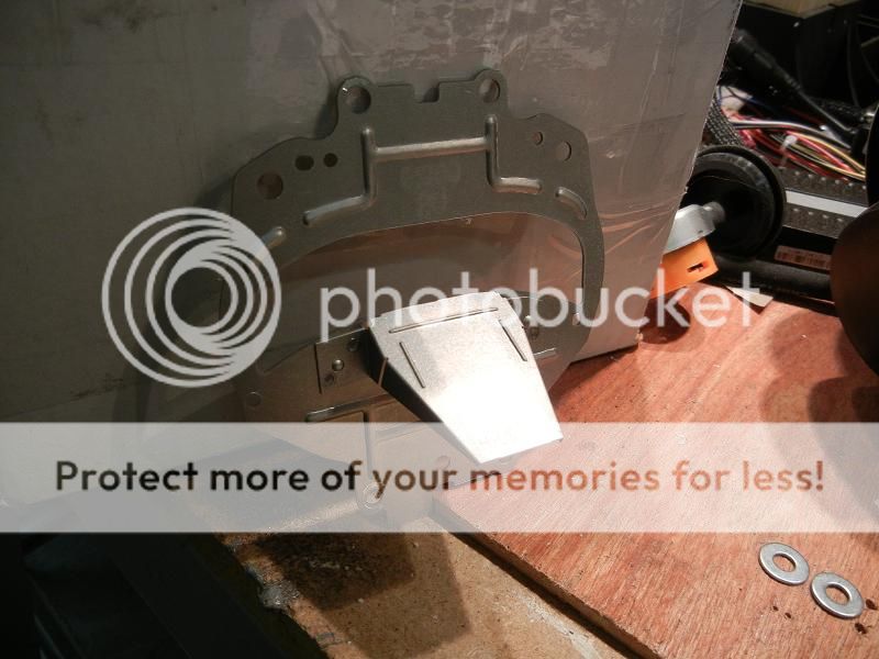

The squirrel finder is the large metal tab that sticks out towards you in the picture below:

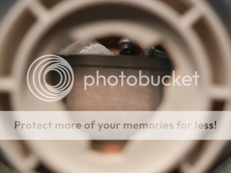

The squirrel finder allows light to be reflected off the bottom reflector and out the hole on the front. You'll see the hole on the front in this picture:
The light escaping from this hole is the primary reason why PnP HIDs blind people. They still won't be as good as a retrofit, but you won't blind as many people. All you need to do is stick your finger in the bulb hole and bend the metal squirrel finder tab down as far as you can. Stick the bulb back in and you will no longer be blinding as many people.
