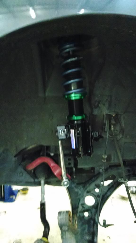

I went with the Fortune Auto 500 Series V5 coilovers with all the upgrades. They have swift springs for which I chose 6k and 7k spring rates and Koyo radial bearing mounts to keep binding and noise to a minimum. They build each set to order and use a shock dyno to match every set of coilovers to ensure balanced performance and solid reliability. They have a digressive piston to aid in sharper feedback and they use Amsoil synthetic shock fluid. All components are precisely engineered and matched together to create the best unit possible for the price.
Purchase and Install: I bought my coilovers from ProAuto, LLC in Columbia, SC from the owner, Nick as they sponsor our club (Southeast86 on Facebook) and are also fairly close to me. I was given a fair price and also bought them during a free installation promo period so that was just icing on the cake. It took about 8-9 weeks to get mine as they had just started producing the V5 coilovers and as I said, they make them to order. So this past Friday night I drove to Columbia to have them installed. I am still waiting on my Whiteline rear lower control arms so I have not yet had it aligned and it is riding pretty low until I decide what ride height I want to compete with.
