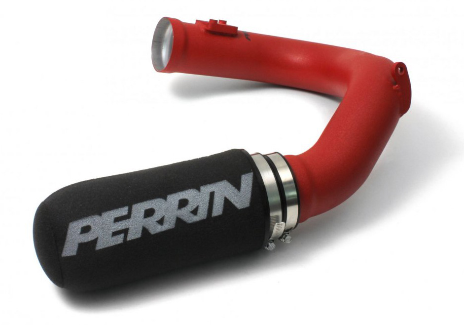

I'm not sure if this topic has been brought up yet, but does anyone know what the best Cai for the fr-s is?
I've been leaning toward the Perrin, but I didn't know if any of them had higher horsepower rating. Anyone know?

I do not have experience with the perrin intake, but it does look nice and seems like it could function properly, especially since it uses the stock snorkel location.

But You Will need to remove the bumper to clean the filter with the Perrin COD

We've got Perrin, Injen, and Takeda intakes that you can take a look at. Let me know if I can help out!
Perrin Performance Cold Air Intake for Scion FR-S/Subaru BRZ - Available in red and black
Injen SP Air Intake for Scion FR-S/Subaru BRZ
Takeda Cold Air Intake System - Scion FR-S / Subaru BRZ

The stock setup with a drop in filter is best for drivability and fairly good on the power but obviously only looks stock. With a tune something like the Perrin 3" will probably get the most power but you NEED a tune. Not sure if Unichip will work with it or not. For bling, well thats your personal choice whats best.
