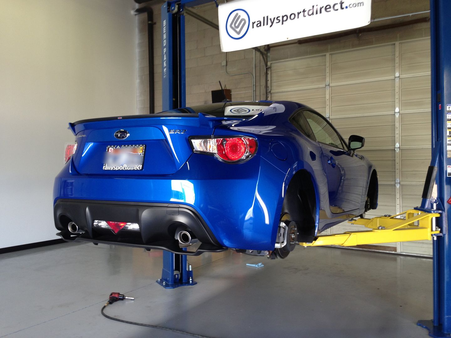

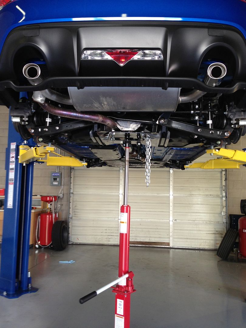

Whiteline rear subframe inserts, Kartboy Trans bushing insert:

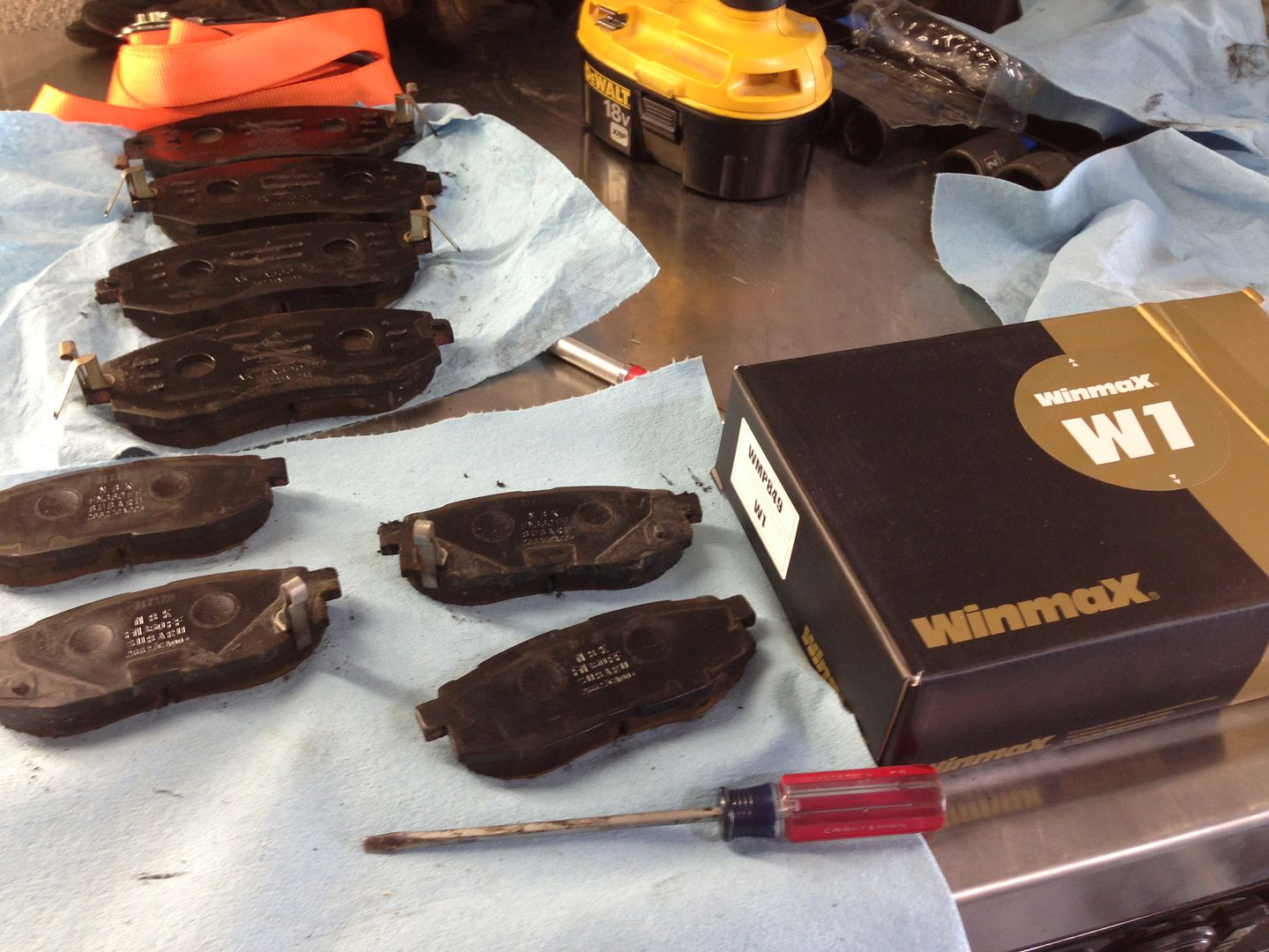

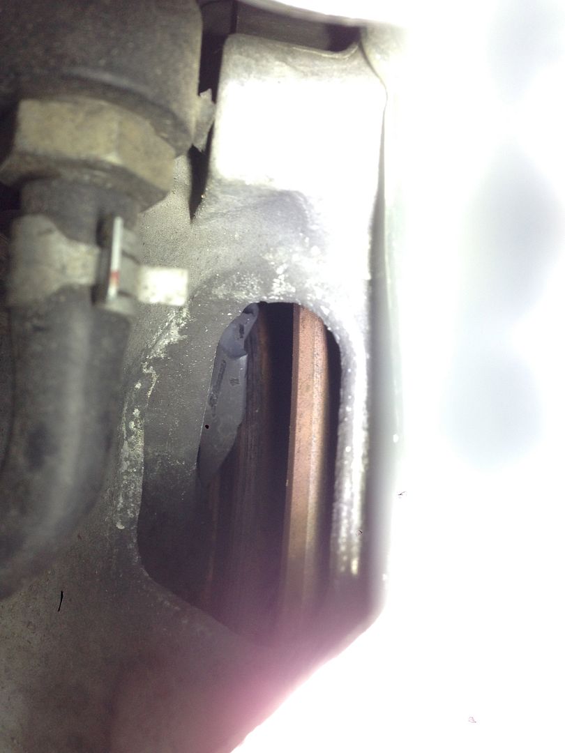

Winmax W1 brake pads:

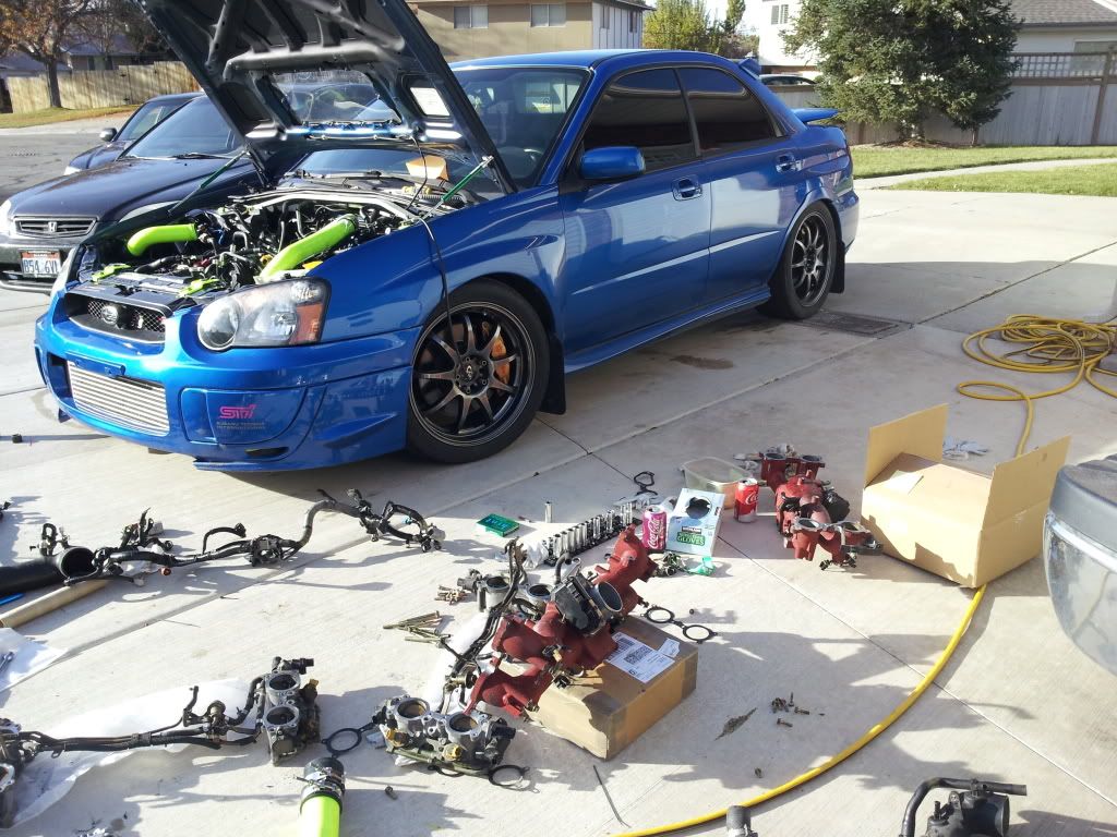

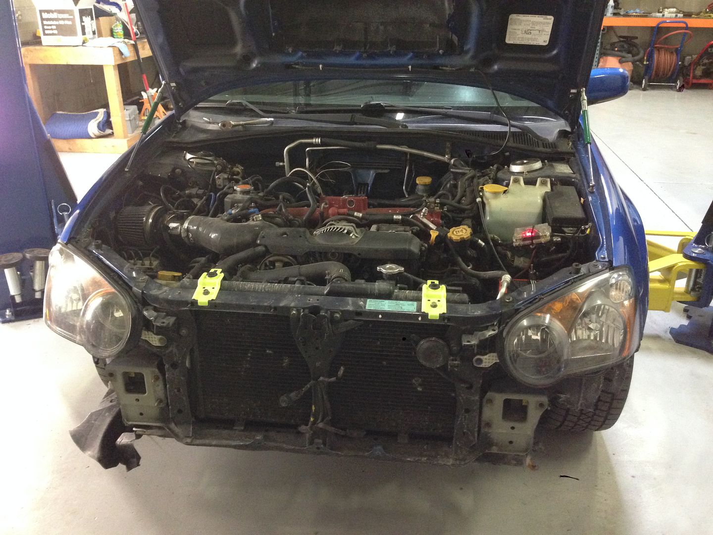

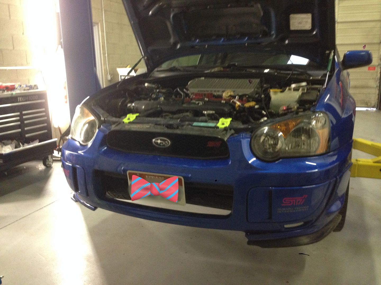

The De-Ricing of the STi continues!

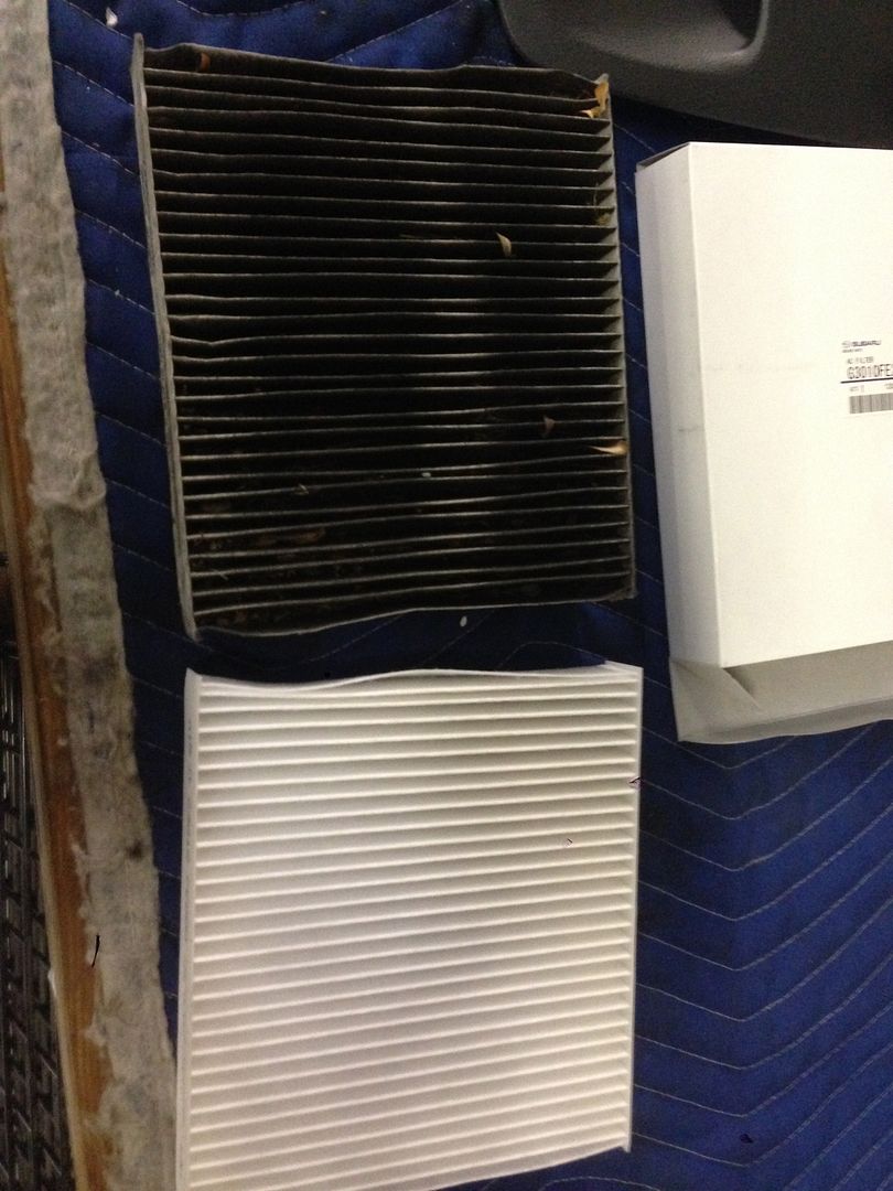

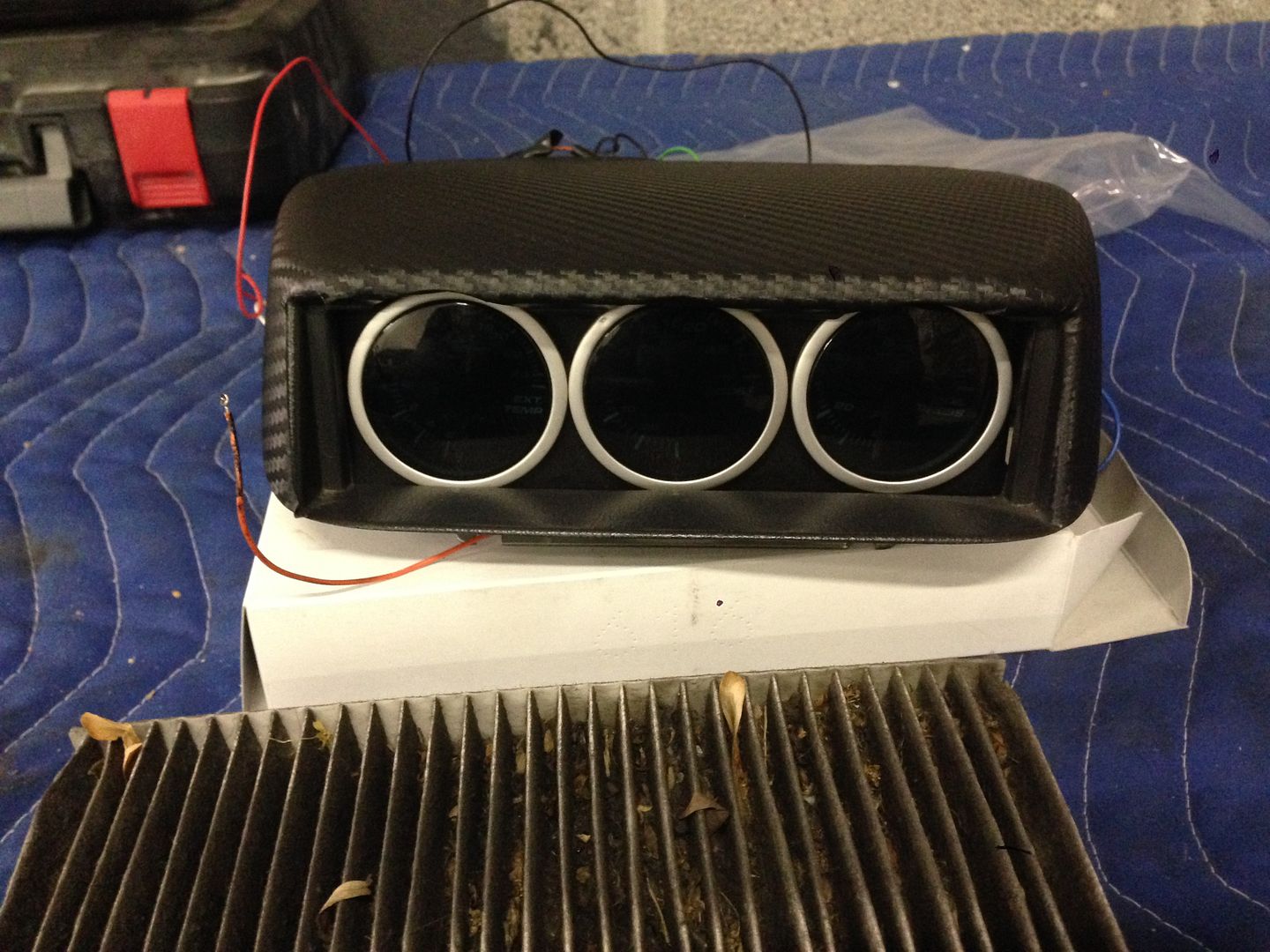

First getting rid of the horrible/shitty Poor-sport gauges. I also replaced the Cabin filter at the same time.
Out with the rice: And holy dirty cabin filter!!
In with OEM!
Now the real fun begins. Ordered some stuff from Subaru.
Combined with some other stuffs I had laying around for quite some time.

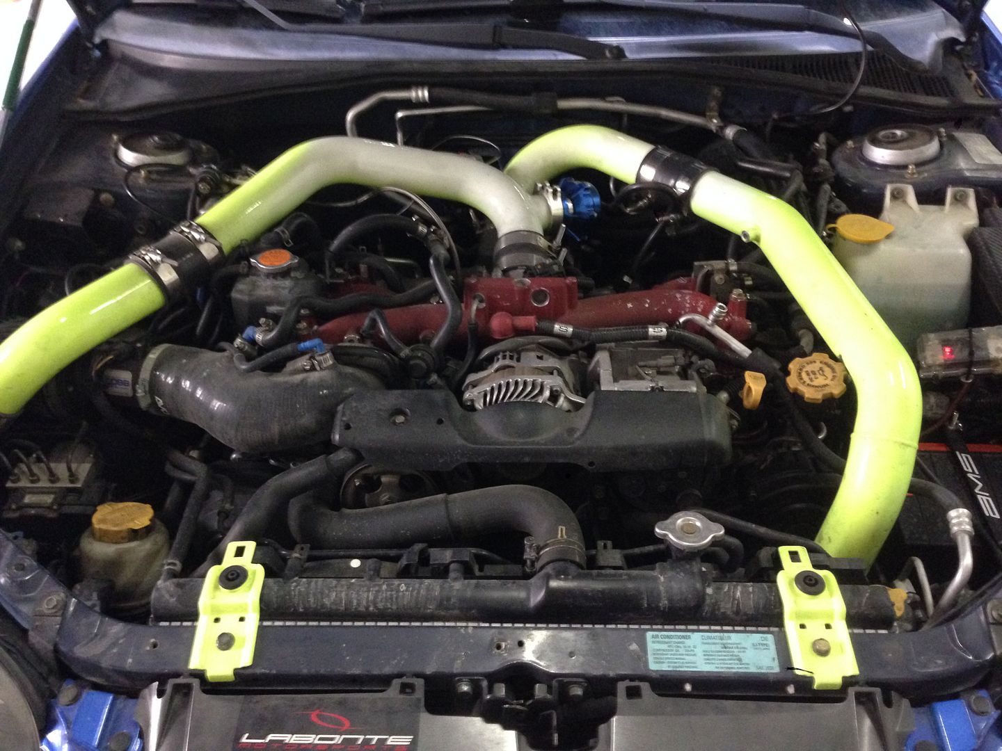

I'm not Ken Block, so the horrible green shit has to go:

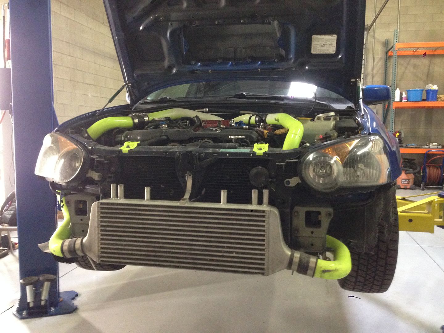

FMIC be-gone:
Green charge pipes... Gone!
Yummy PTP Lava Turbo Blanket installed:
WTF is this.. Trans inspection plug chilling on back of the flywheel hahaha.. Spent a good hour fishing this little bugger out.

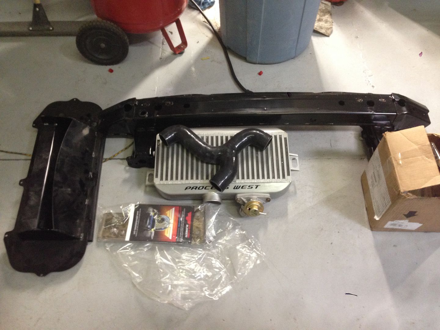

Process West TMIC installed!!!! Even my car is happier!

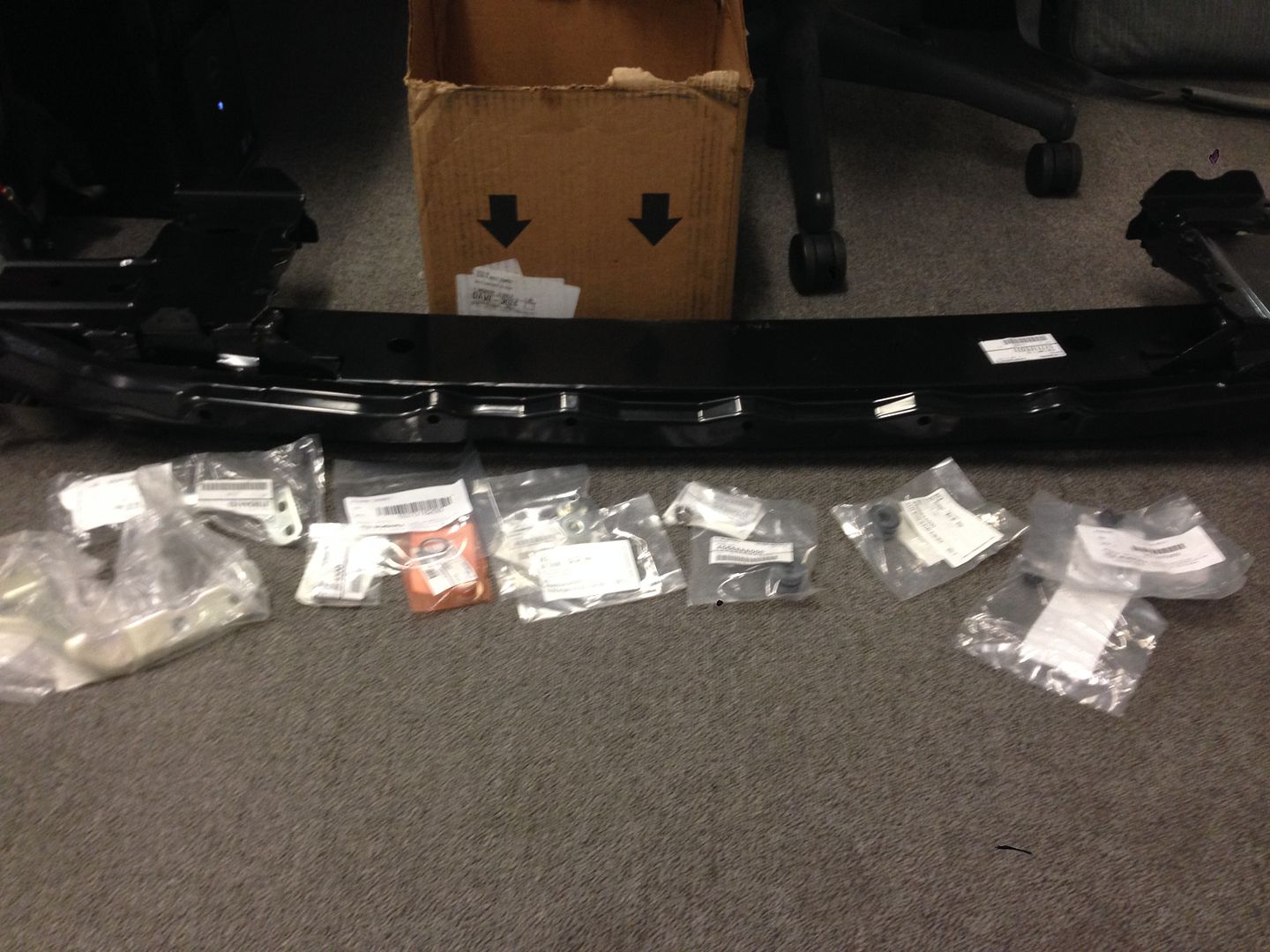

OEM Bumper Beam installed. I had an aluminum Oswald Performance Beam, but decided I wanted OEM instead... #becausenotracecar
Process West Splitter installed, modified for OEM water sprayer, and Bumper installed. All dressed up and ready to dance.
Next up when time permits. Get OEM rad suports, or paint them black. Remove Amps and wiring, uninstall water meth kit. I *may* in the future go with an Aquamist kit, larger injectors and pump and go for 400 WTQ. For now I am SUPER happy with this setup, no more loud ass blow off valve, boost response is much better, and hopefully less people will try to race me with the giant FMIC removed LOL.
Thanks guys!

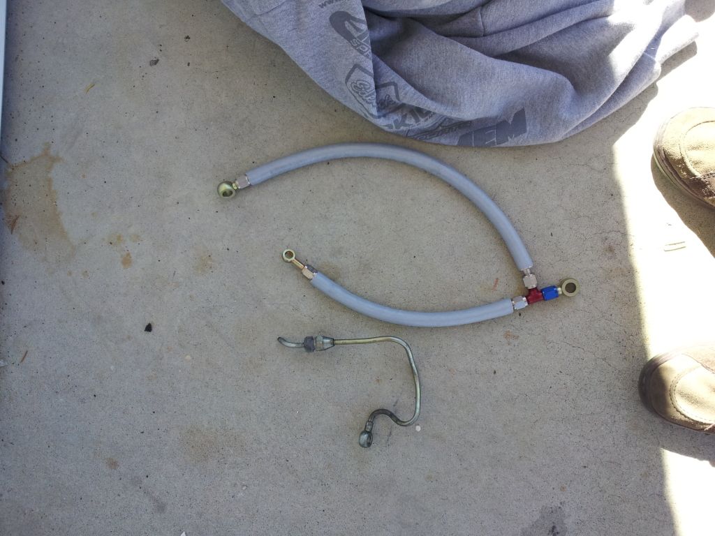

Ebay turbo that came on the car. 300 miles(according to seller), although I did find a pinhole leak in the hard oil line which might have been the cause. Grateful that the dude did not know about cars and just "wanted it gone" lol.
Replaced the pinholed turbo oil hard line with a stainless AVCS + turbo line:

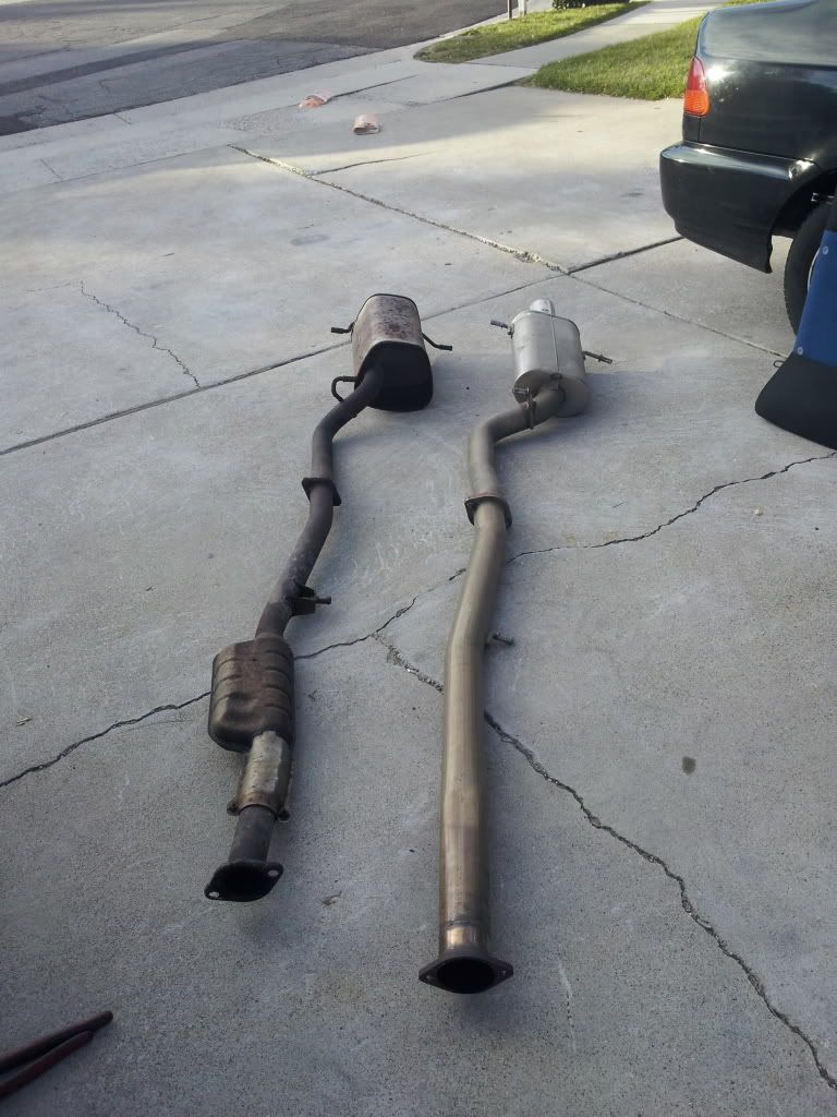

Cobb catback out(it was a bit too loud), rusty OEM catback in:

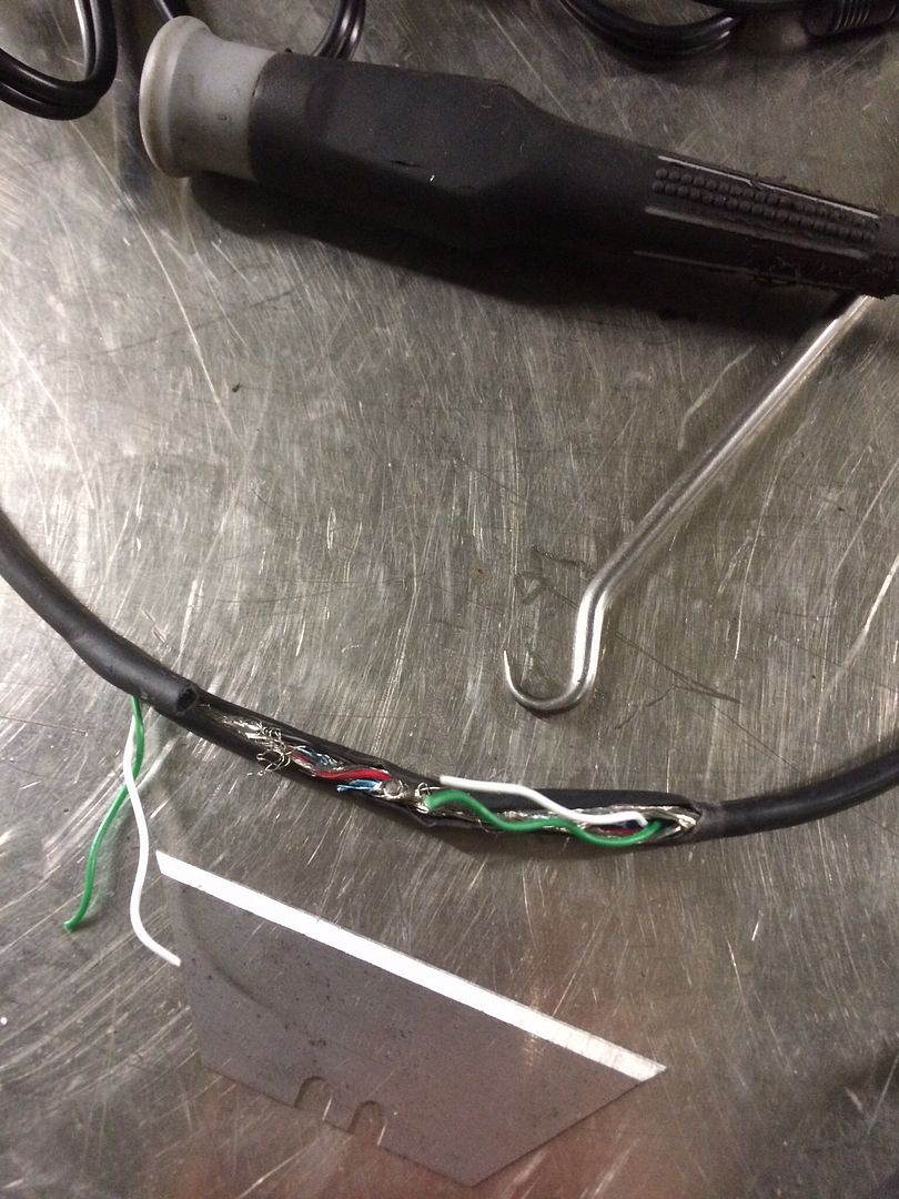

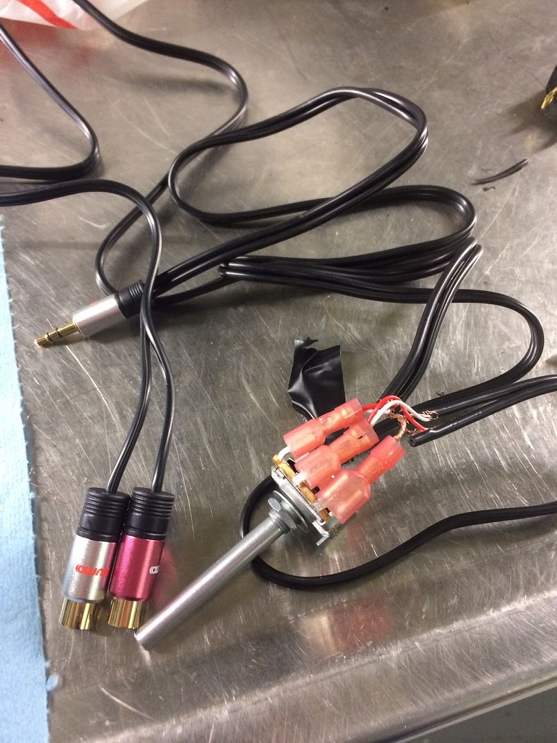

Inspired by some of the guys on here putting tablets in their car, I went out and bought a nexus 7 for the STi. The physical install was much easier than expected, getting the tablet setup and running the way I wanted it to was a bit harder.
The STi came with amps already in it so I decided to get rid of the head unit completely and run the tablet straight to the amps using a aux to RCA adapter. I also used a DC to 5 volt USB adapter to power the tablet. Here is the tablet installed and running.
I quickly ran into an issue, I was only getting 500 mA power to the tablet and could use more power than it was taking in. The solution? Modify the USB data cables so the tablet does not limit the incoming charge. Take the 2 data cables and wire them together.
Now I'm getting a solid 600-1000 mA charge depending on the screen brightness and apps running. Great, okay next problem... Volume control! Well I tried using widgets, but they just don't quite cut it for quick/easy control and it was driving me crazy. So my solution was to wire in a 10k ohm potentiometer.
And I mounted it in a easy to reach location.
Bam! Good volume control! Yay!! I have been sick this whole week so I have not had a chance to tweak and permanently install everything yet. I also bought a new DC to USB converter which should give a bit better charge that I want to test out, but do far I am incredibly happy with it, it really looks like it belongs in the car
