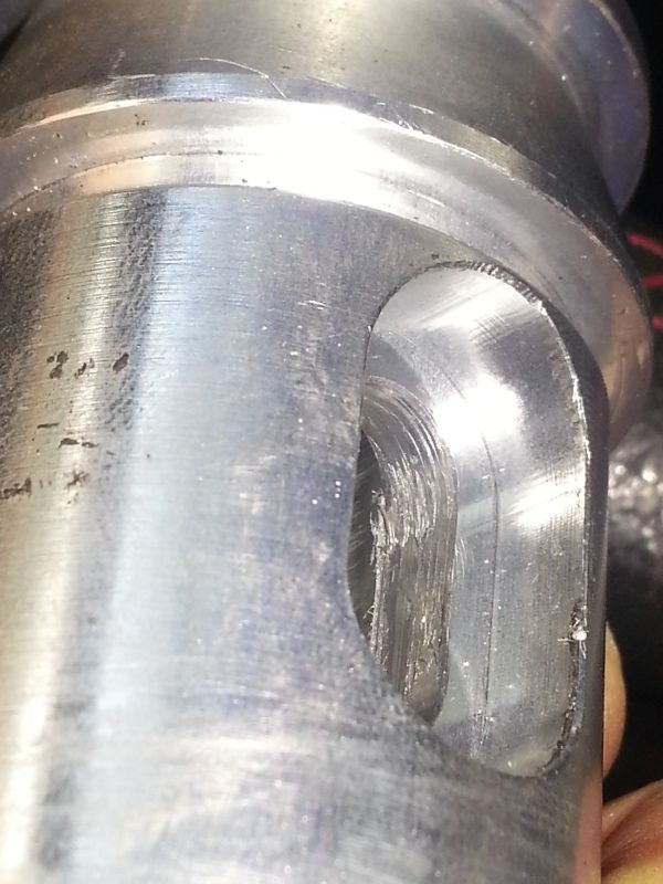

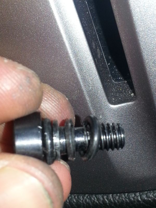

I actually think I might have installed the first Shiftek shifter on a twin. I only say that because some of the QC was way off. It was back in August and I went back and forth with the vendor about the issues I was having while I was installing.
I understand that sometimes this happens in early production runs so I didn't make an issue with it. I've still been in contact with them and am still waiting for a revised, or fixed shifter.
Although cutting the Oem bushing to reuse it wasn't my first choice, I was fine with that.
I then discovered that the ID of the linkage bushing didn't fit, and that is what lead me to believe I was the first people to install these because it was clearly far too small. I didn't have a caliper around, so I passed drill bits through the oem until I found the closest match (3/8 was a little loose on the oem, but it was close enough). I overbored the bushing and finally got it on.
The real problem was with the rattle that came with it. After stripping it down a few times and checking everything out I found the source of the problem. The hex bolt that attaches the reverse lockout to the main shifter shaft.
You can see where it was rubbing
The lower edge where the o-ring sat became warped causing it to no longer fit without contacting the reverse lockout.
Other than this, it's a nice inexpensive solution to getting a short shifter. I might have liked the reverse lockout having alternate color options, but that would obviously increase the price of the unit.

Damn that looks all messed up. Maybe you just got a bad one. I don't have any rattle and mine doesn't look like that but I will take a look at it in the morning. Bought mine June 30.
