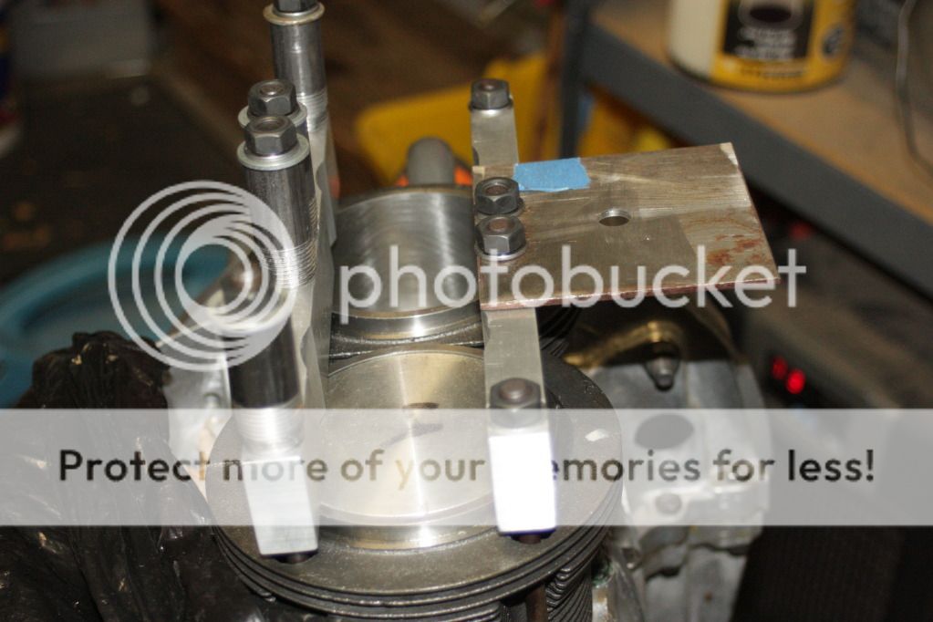

(Oh And I build racing 4 cylinder Boxer engines for fun - I have three of them at home right now)
