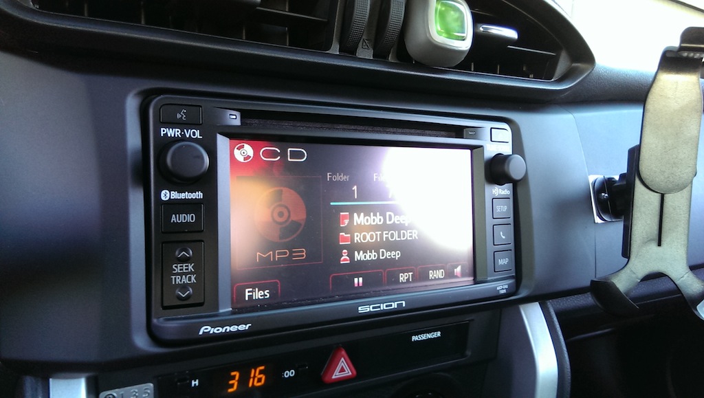

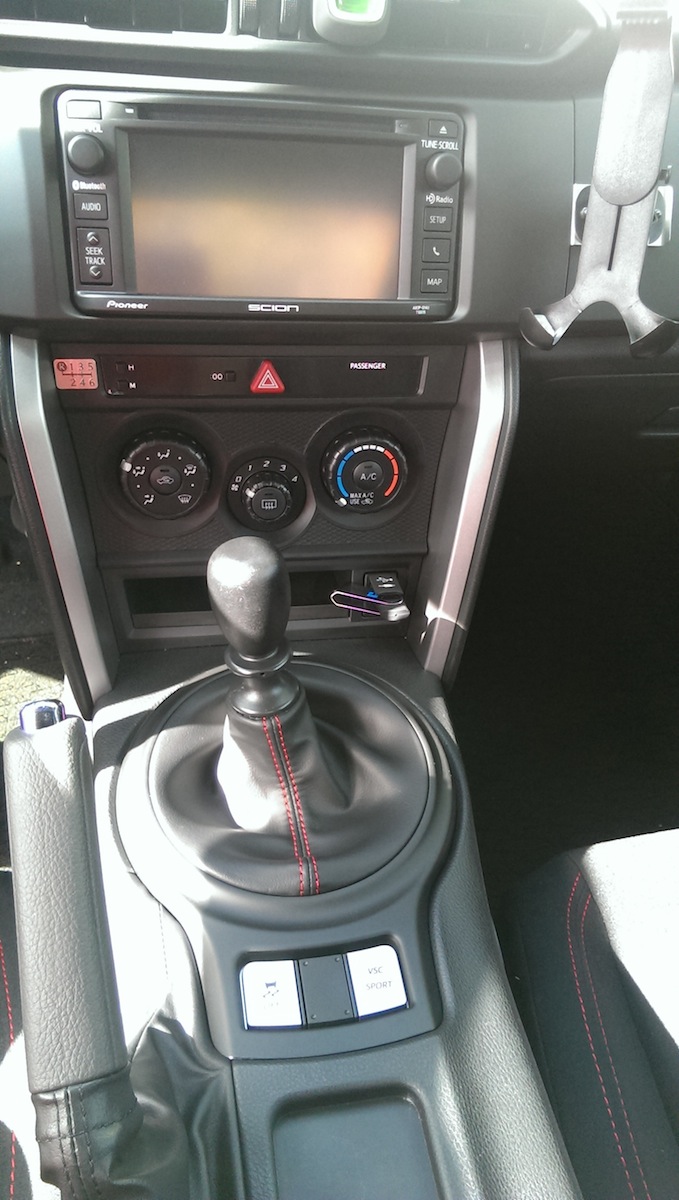

The dash bezels may be appealing to some, but personally it's not for me, especially with a raven black exterior. Did this mod on my previous car, figured I could do it again on this one.
Wet sand the original bezels, air dry, and use several light coats of the spray paint. You're gonna have to air it out for a few hours, the odor may linger around once you reinstall.
Materials:
220 grit sandpaper
320 grit sandpaper
Krylon Fusion Flat Black Plastic spray

I attached the Beat Sonic mobile carrier

Use several coats

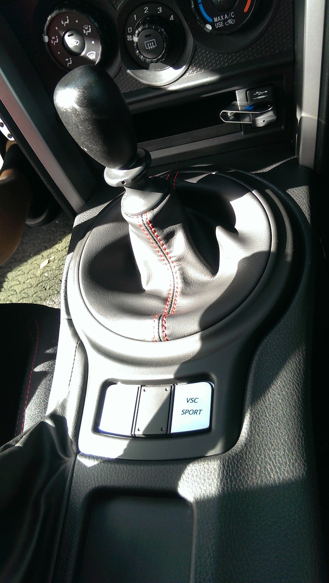

Black-out Continues
Continued today with the shift trim and around the VSC/Traction Control buttons.
The idea at first was to paint the middle, dummy button to make the two control buttons pop-out, but now I think they might pop-out a little too much.

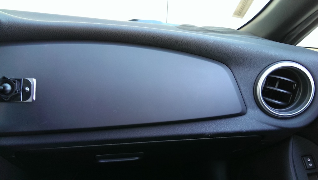

Eh, we'll see if it grows on me. Almost completely murdered out, I need to figure out to paint the rings around the air vents
BONUS: You can change the color tone for the switches if you cut out the colored, rubber film around the two LED's. Remove the rubber from the trim and try to look through it, you'll notice everything looks brownish. Cutting it out and the lighting will be clear
