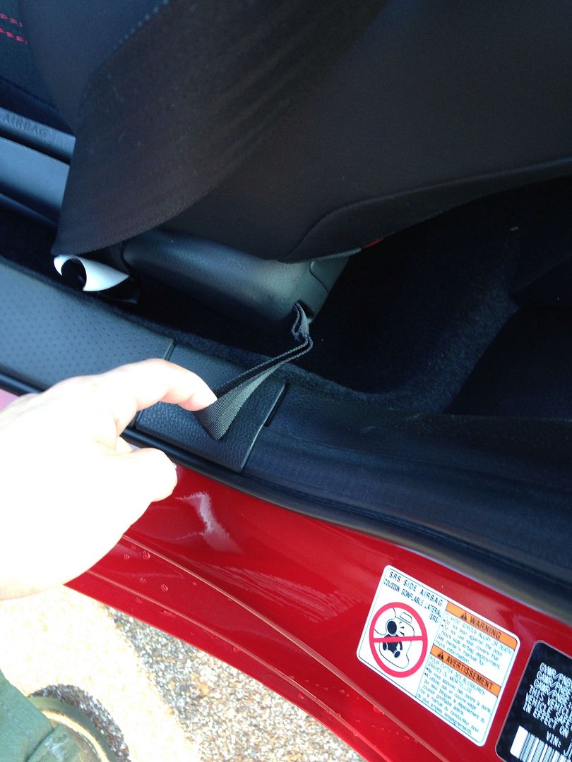

Another issue this morning was the seat "pull to release" for the drivers side doesn't release the seat to slide forward for access to the back doesn't function. Invoice said everything worked fine so it's back in the service bay will update.
And the solution was told to me that's it's not suppose to work so the driver can't be moved while driving. and for reference this is the release in referring to

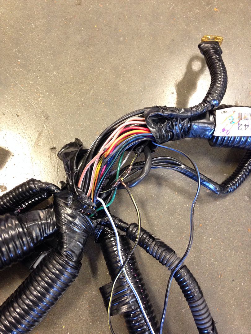

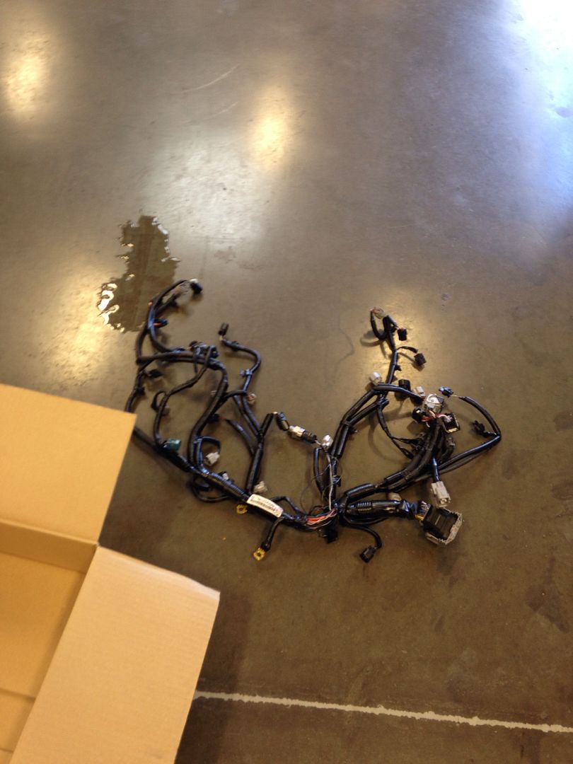

Case closed 17 OCT 2013
Well finally go my car back from the dealer today. They diagnosed the issue to faulty wiring on the direct injection sensor to the harness. So the harness has been replaced and the car is fine now. Basically as the voltage changes due to the loose wire, the direct injection was told to dump fuel immediately followed by a lean code etc read the above for better description. I'm really happy with the service tech and the local dealer how they handled this now and happy to finally have the car.
