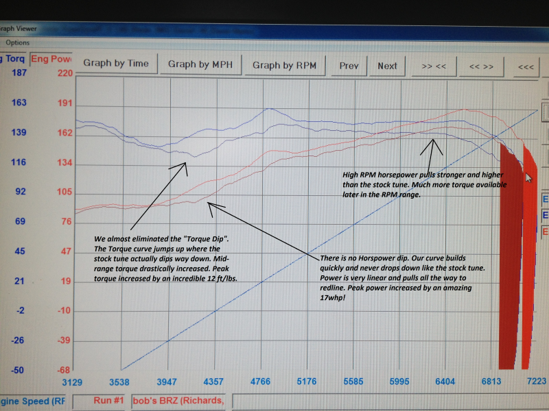

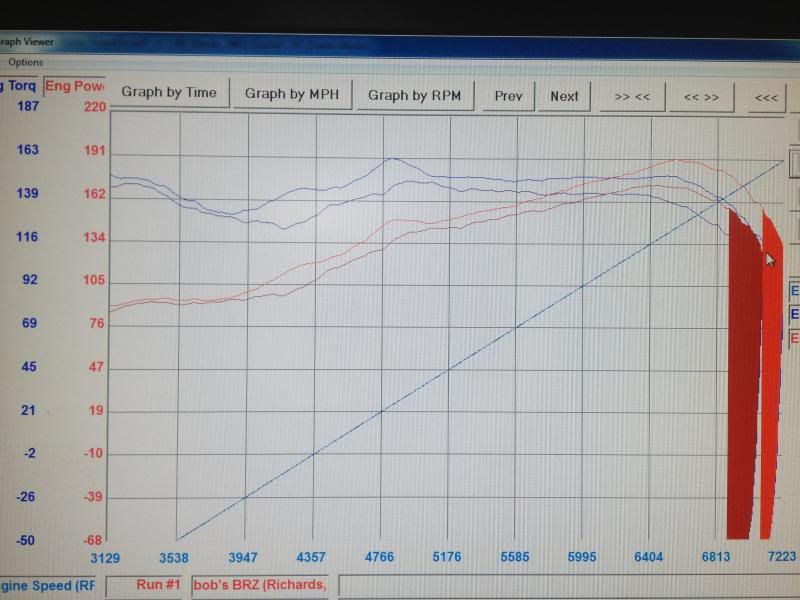

We just finished Pro-tuning a local BRZ 6mt, the car only has a drop in filter and a muffler delete, using 93 octane.
We achieved a 17 wheel horsepower and 12 ft/lbs. torque gain over the stock tune!
Stock: 174whp / 151wtq
Custom Tune: 191whp / 163wtq
Stock and Tuned Overlay:
We drastically increased low and mid-range torque, as well as dramatically reducing the dreaded "torque dip". Peak torque was increased by 12 ft/lbs. to the wheels, We provided more torque throughout the entire rev range, and the torque curve after the peak is extremely flat all way to redline.
Peak horsepower was increased by 17 to the wheels, and the curve is very linear and builds smoothly all the way to redline, power was increased across the entire rev band. We did away with the stock tunes HP "Valley", our horsepower curve builds steadily to redline, giving smooth and strong power delivery!
Keep in mind, this is basically a bone stock car. We did back to back testing with the drop in filter vs. the stock filter and there was a +/- difference of 1 hp, it was negligible over the course of 2 runs each. Also, the muffler delete was shown to have zero affect on the power numbers, but it sounds damn good!
We are very proud of this tune as these numbers are in the very upper range of what we have seen on a stock drivetrain 86, from what we can tell we have the highest horsepower gain on an N/A 86 - BRZ - FRS with stock exhaust and intake system in place.
Our Priority was to achieve maximum useable power while maintaining complete reliability and driving smoothness. We did not tune this car to the ragged edge just to achieve a big number, that's not how we do things.
For this customer we also enabled the Launch Control feature, which he really like for Autocrossing. This gives you a programmable rev limit, which allows for consistent launching, and sounds really sweet!
Please post up any and all questions, we will be very happy to talk tuning with you 86'ers

Sorry, it was a Mustang Dyno. The shop has it calibrated to read like a Dynojet, so the numbers are higher than a normal Mustang Dyno. We looked mainly at the Horsepower increase over stock, since every dyno will read differently anyway

That almost works.... except that if the dyno is calibrated to read higher the gains will also be skewed by the same percentage as the baseline.... so if the baseline is skewed by 10% the gains are also skewed by 10% etc etc

Not exactly. The results are linear, meaning the calibration shows a higher baseline, but the differential is the same to our tuned map. The percentage is not exponential, so it would not "skew" the gain from stock to tuned. So yes the base number is higher than a usual "stock car" but the gains are what matter.
Even if it was exponential by some factor, given a stock BRZ on other dynos have read ~168whp, and this mustang read stock ~174whp, the percentage difference applied to a 17whp gain would produce an approximate 16.4whp gain. And that is if the progression is exponential and not linear. We won't split hairs over 6/10 of a horsepower.
The stock baseline run, and the tuned run were done on the same dyno, same day within minutes of each other, with the same dyno calibrations.
In addition, these numbers were not corrected SAE or STD, which would have made the numbers even higher. This was done on a hot FL day with air temp at 92F.
We stand behind our published whp and wtq gains, and the gains are what we've focused on, not the final numbers, because we all know you cannot accurately or fairly compare numbers against different dynos.
