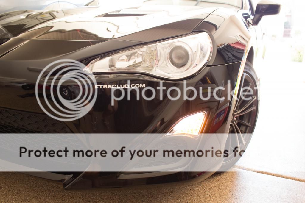

Hello everyone! Here's a quick and easy DIY on how to install your LED Turn signal housing with DRL bar.
Special thanks to: @Vicious LED for helping me out!
Product info: Vicious LED Turn Signal
Tools needed:
10mm Socket
Socket Wrench
Philips Screwdriver
Flat Head Screwdriver
Tap Wire Splice (2x)
Electrical tape
Wire cutter
Oscillator cutter (Something to cut the plastic tab)
Step 1:
Remove the tabs of the plastic cover using a flat head gently until they pop out.
Step 2:
Turn your wheel inward to help ease the access of the 4 pop in locks of the plastic panel and remove the locks using a philips screwdriver.
step 3:
Use the 10mm socket to remove the 2 nuts holding the turn signal housing on to the bumper.
Step 4:
Cut the plastic tab that's pointing on the 2 O'clock position shown in the pic below. This will enable you to plug the harness to the new LED housing.
Step 5:
Use the wire tap splice to connect the YELLOW wire from the HOUSING to the GREEN wire of the HARNESS.
Step 6:
Use the wire tap splice to connect the GREEN wire from the HOUSING to the BLACK wire of the HARNESS.
Note: Covered the RED and BLACK wires of the housing because if you have an LED relay, you wouldn't need it.
Refer to the pic below
Step 7:
Make sure everything is connected properly and TEST to see if they are running. If DRLs are running but no turn signal, reverse the connection of the housing plug and the harness as you may have plugged it in wrong.
Step 8 (optional):
Wrap the splice connectors and the wire with electrical tape to ensure nothing goes wrong.
Step 9:
Put everything back and do the same thing on the other side.
Enjoy your new LED housing with DRLs.
End result:
[ame="http://www.youtube.com/watch?v=s39AdpG4J1Q"]Turn Signal Housing for FRS - YouTube[/ame]
