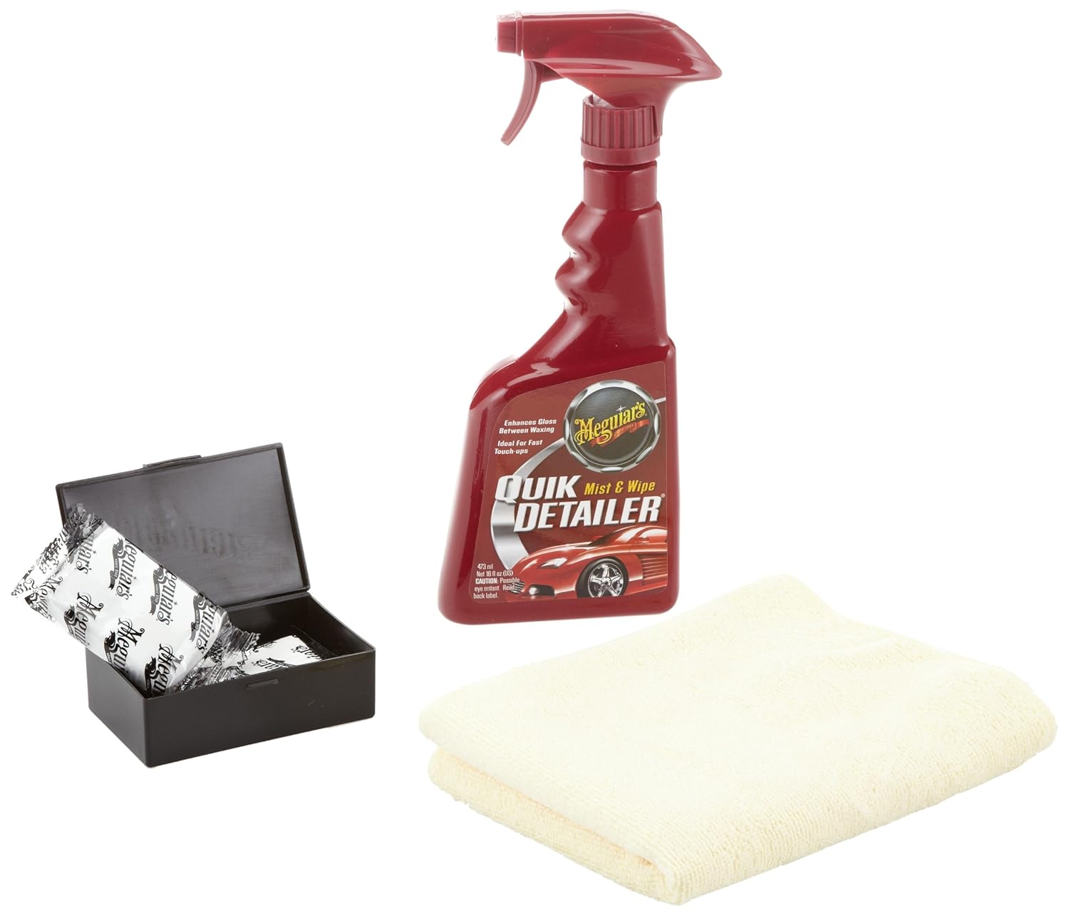

Clay Bar Kit. For example:

This. Same thing happened to me a couple of months ago. I had paint splatter along the full length of the passenger side. It came right off with clay.

Clay bar will work as noted earlier. You might marr the paint though (going at it over and over in the same spot trying to knock it down). So a lot of times I use a tar remover to dissolve it. Something like stoners tarminator or carpro TRIX
Ok, do you recommend using clay bar lightly and if it doesn't work, go with the tar remover? Or straight to the tar remover?
