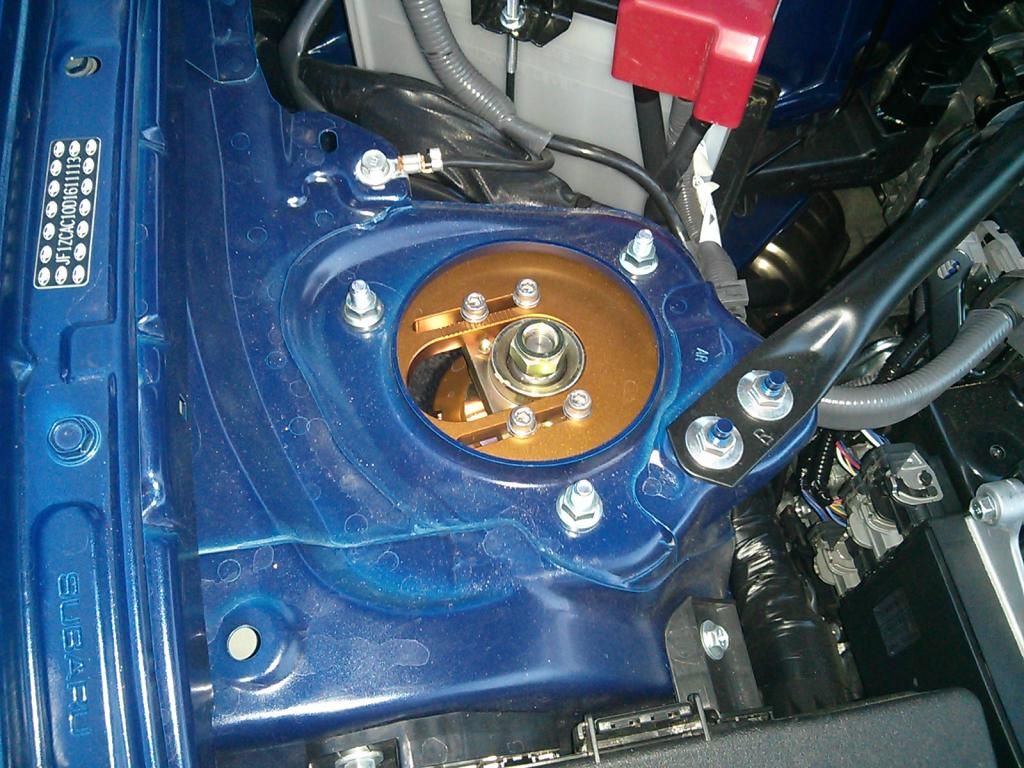

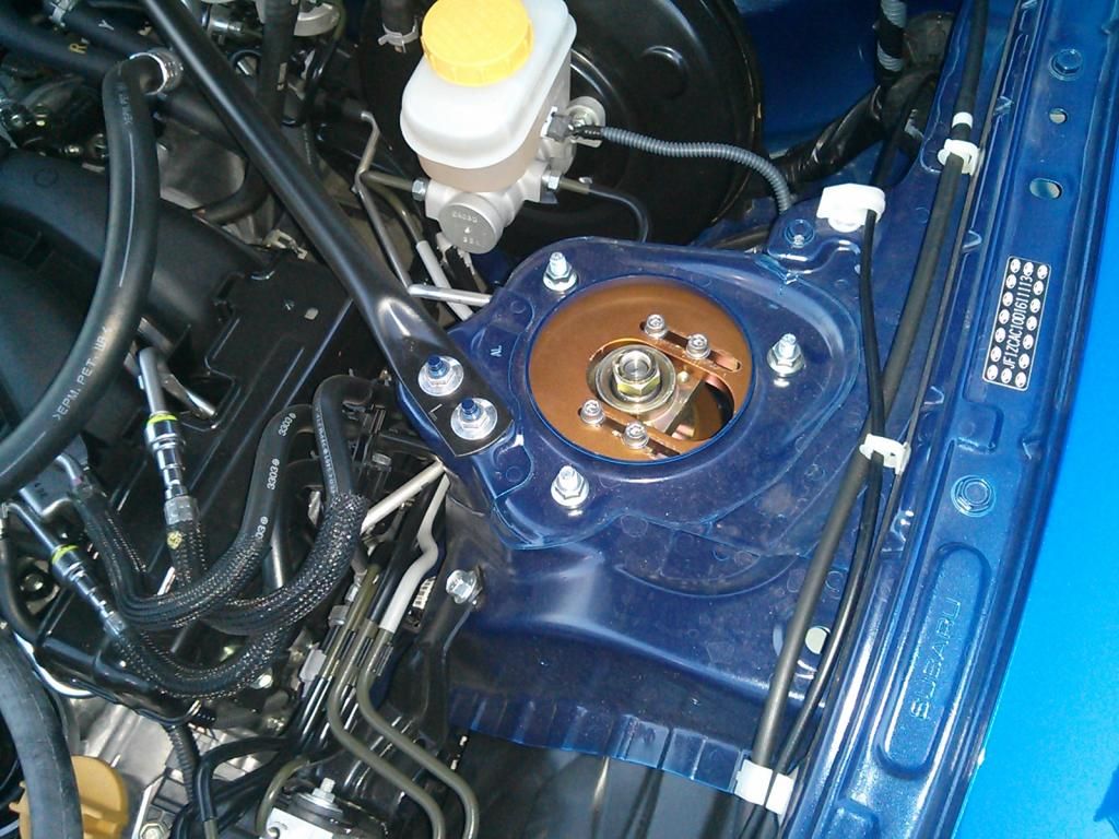

I decided to pop the trunk and look at the adjustable camber plates thinking possibly maybe the adjustment screws are loose from the alignment... WTF! I see the camber plates are in backwards!

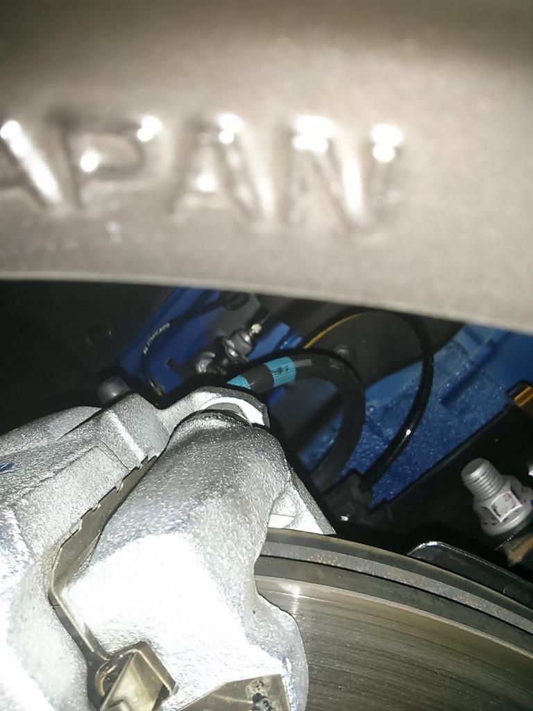

Looks like the brake lines / abs line is run correctly, but really need to pull the wheel off...

A lot of coilovers have shipped, preassembled, with the right left camber plates switched, the shops just put them in as-is. It's been a common problem.

You can't rotate the camber plates 180 degrees, as they won't bolt in that way, so that wouldn't have worked. They actually have to be removed and swapped to the proper side.

That's what I figure. Does anyone have the stance coilovers? Is the 0and dashes supposed to be closer to the firewall or the bumper...

It looks like the hash marks are supposed to be toward the firewall. It also looks like you gain a little caster as you add camber as well with these particular plates, but it is very hard to tell without a good frame of reference.
