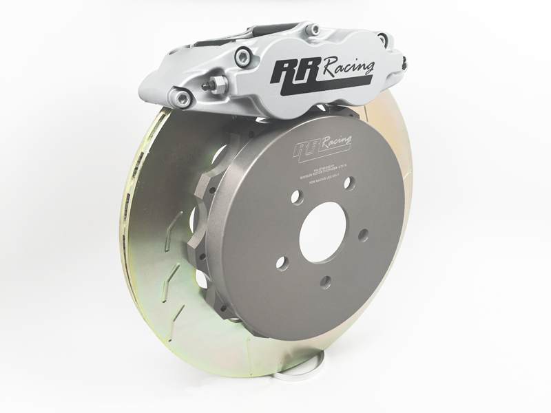

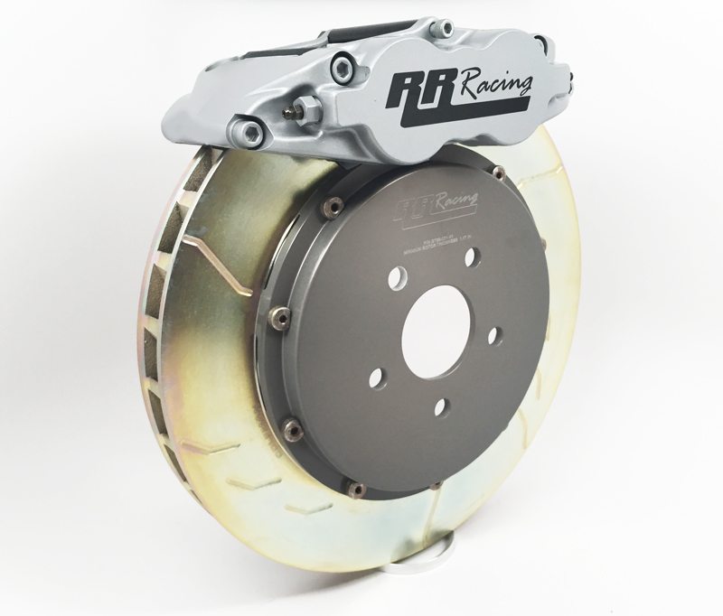

Differences between Wilwood Street Kit and our Competition Kits:
(1) We designed our own fully floating 13"x1.25" Competition Rotors. They are not fixed bolted like the Wilwoods. Floating rotors better accommodate the thermal expansion and contraction cycles and reduce stress/cracking of the rotors.
(2) We also use genuine Coleman Racing NASCAR Winston Cup rotors... they are race proven and taken straight off the Winston Cup cars. They are thicker than Wilwood rotors, and feature a unique slot pattern and direction curved cooling vanes.
(3) If you have the wheel clearance, our Stage IV kit offers much thicker pads (0.8" thick).
(4) Our Stage IV kit calipers are anodized black rather then powder coated for better heat durability (for those of you who routinely track your cars)
(5) We can now do custom colors at a very reasonable cost (silver, red, blue...)
