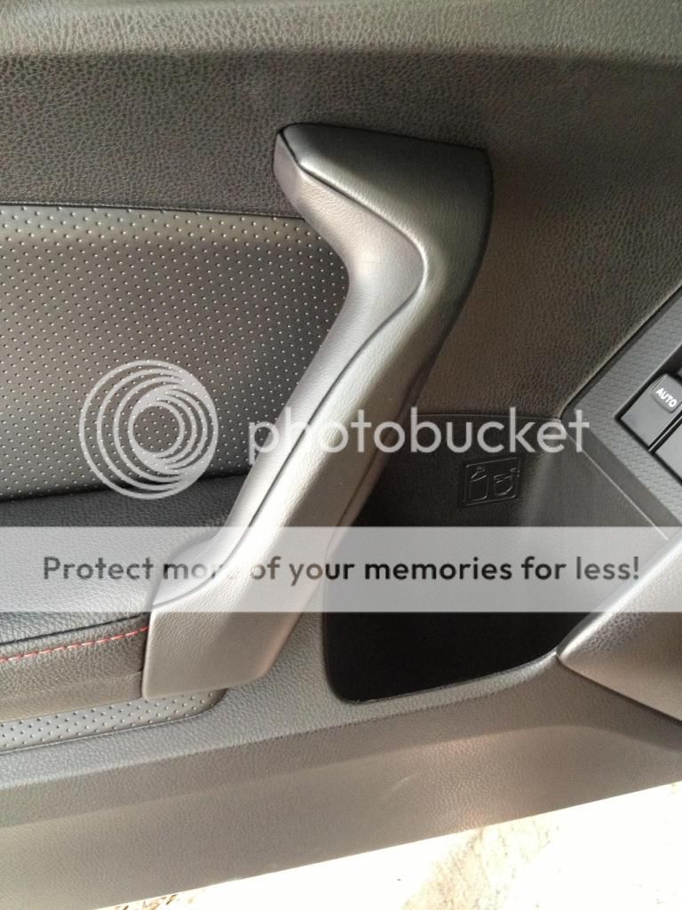

Final result should look something like this:
Installed on car. Pay special attention to how the fabric looks on install. You can fold any corner under the piece so it looks good. Also pay attention to clips on door when reinstalling. Do NOT use a piece of metal to push in corners that may be sticking out. I did this and ripped the vinyl and ended up redoing it. If a corner is not tucked in, simply remove the piece, tuck it in, and then put it back on:

With the added thickness of the fabric on the underside, installing the trim back onto the door is a bit on the difficult side. It also does not snap into place the same way or secure nearly as firmly. Since this trim piece isn't actually being pulled on when opening and shutting the door, I think that it is attached securely enough to not be an issue. If you use a thinner piece of fabric/vinyl, I think you will have less issues. The fabric I used was pretty typical vinyl thickness, so not sure what is really available that is thinner.
