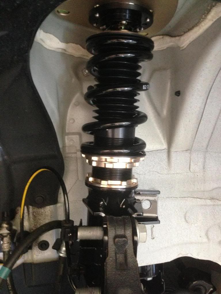

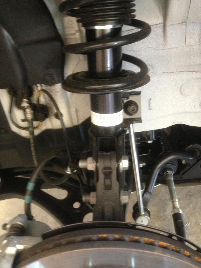

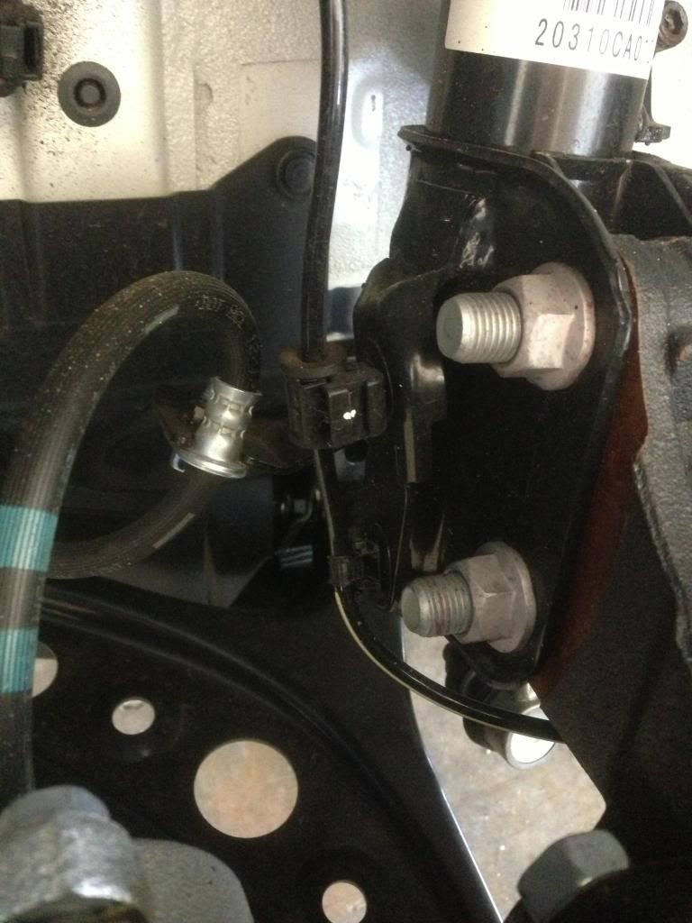

started with the front. this is the main setup w/ the wheel removed. the brake line and abs wires are bolted/mounted to the OEM strut.

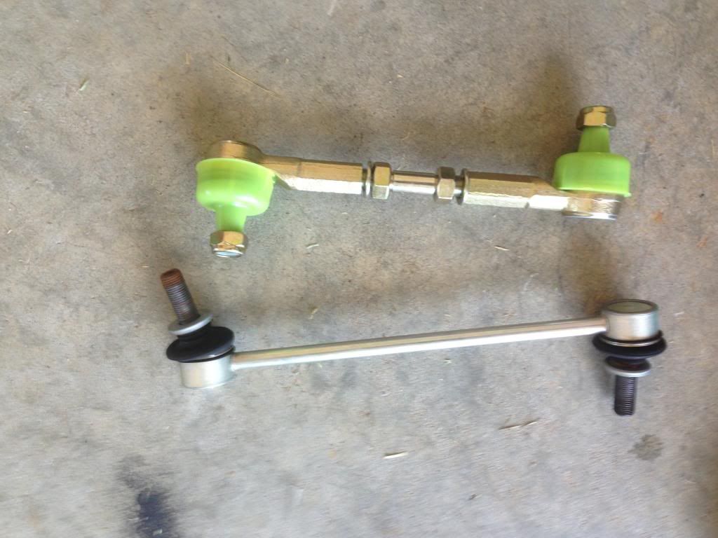

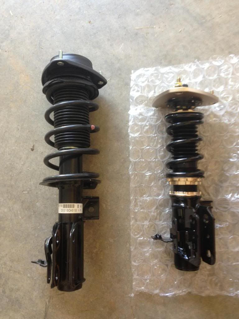

this is the OEM struts and end links compared to the BCs

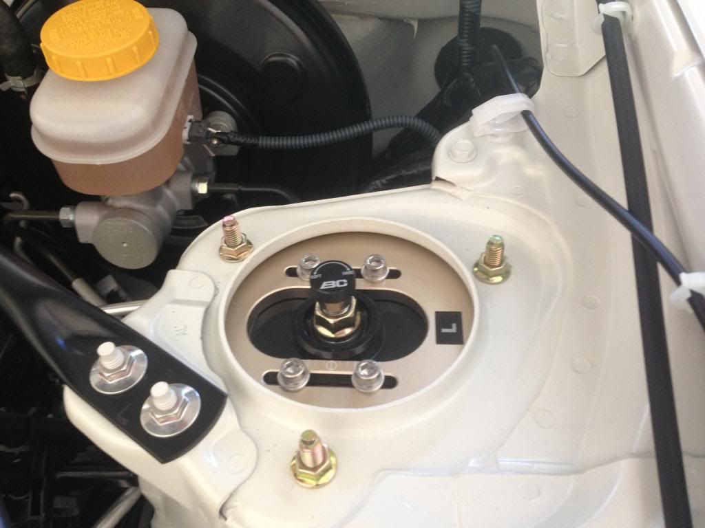

Be sure to mount the camber plates properly or you wont be able to adjust camber properly
the BCs have mounting locations just like the OEM assembly

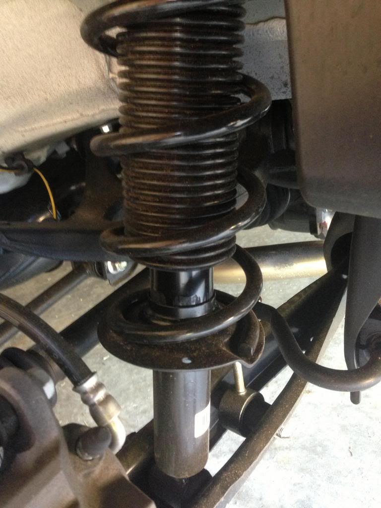

the rears were a little more difficult but not bad. you have to remove the lining from in the trunk in order to gain access to the upper strut bolts. From underneath I had to remove the endlink bolts, strut bolt, and the bolt that connects the LCA to the hub. after that it was smooth sailing!
