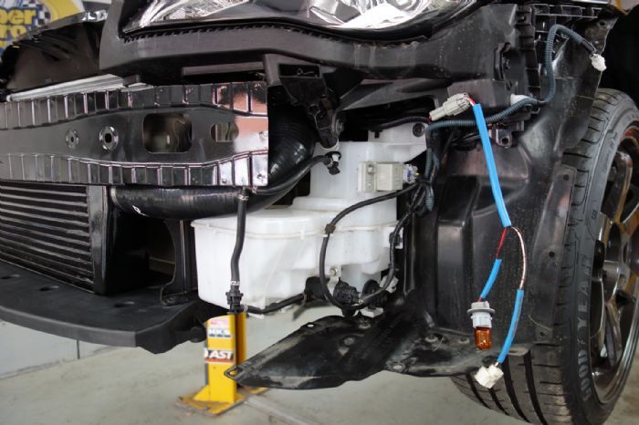

Talking Turbo time
I dropped my car off last Friday to Fensport (the European AVO Turbo agents) to have my turbo kit fitted.
The kit
Let the work begin
Inlet removed
Gearbox out for new clutch
New clutch in
Standard exhaust manifold off
Turbo prepped for fitting

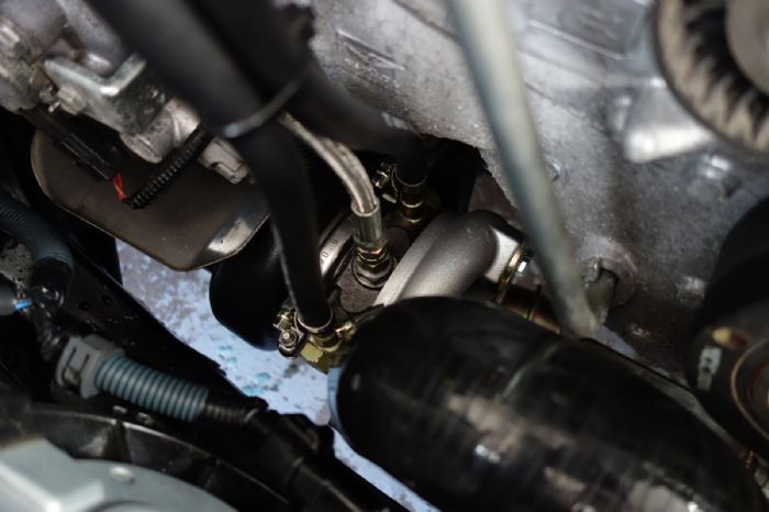

Turbo fitted
[IMG]http://i1219.photobucket.com/albums/dd422/Pitman01/GT86/Turboonwaterandoillinesplumbedin_zps6533b***.jpg[/IMG]

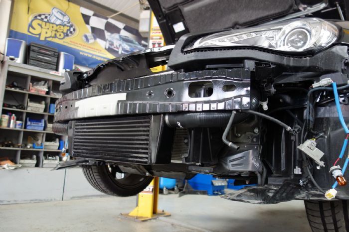

Intercooler fitted
Intercooler pipes in
View from the top
Hopefully instillation will be finished today, and then mapping can start
My cat back exhaust is still somewhere between the USA and the UK, so if necessary Fensport will be fitting a Blitz exhaust to do the start up.
Dave
Pitman is offline   Reply With Quote

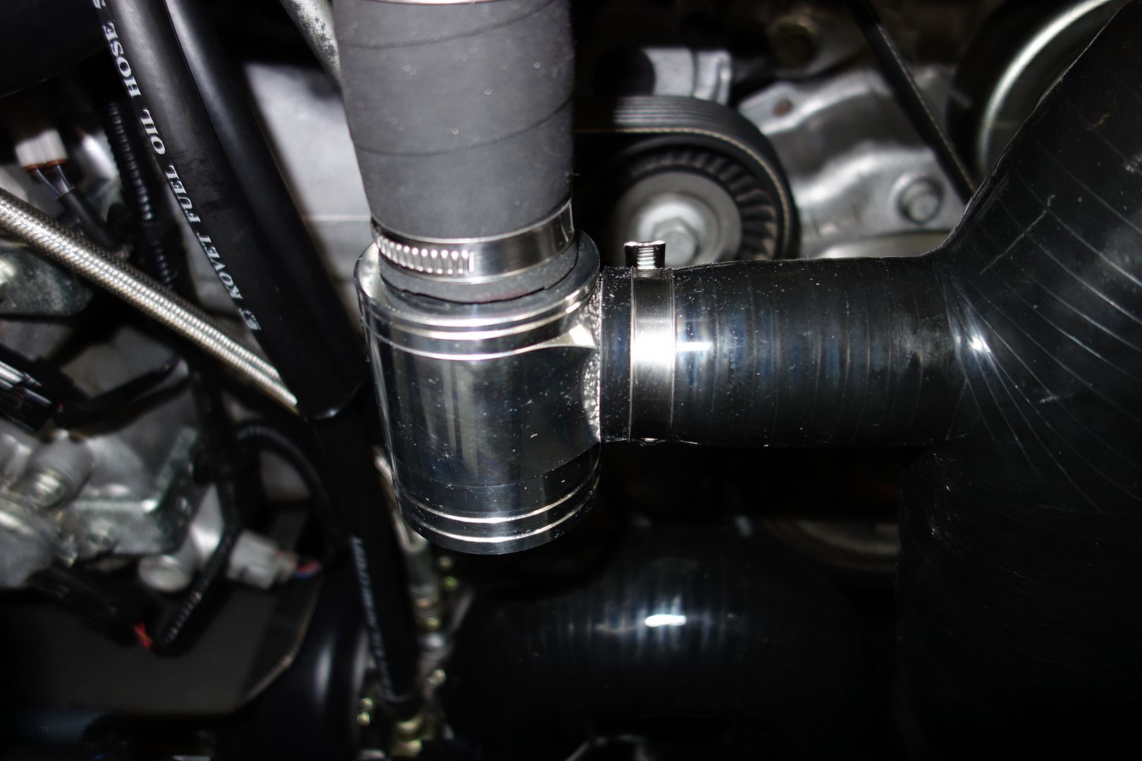

Time for an update

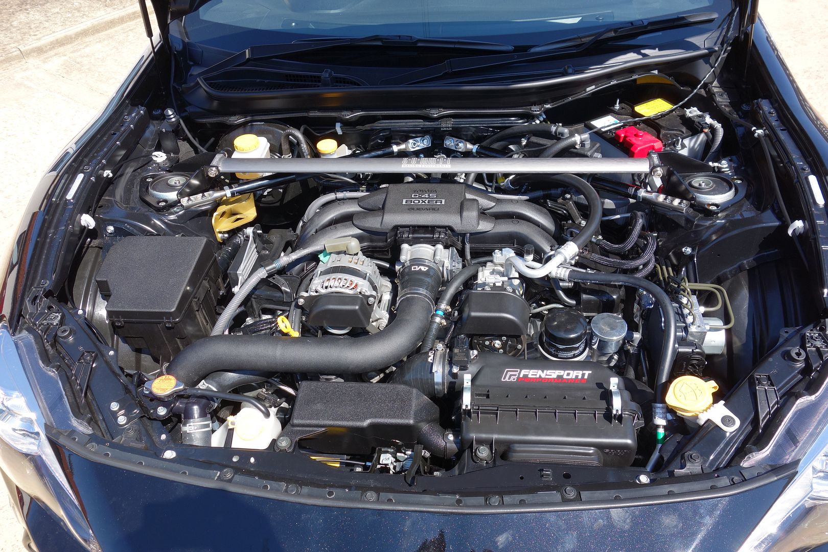

Final engine view with turbo fitted
Blow off valve

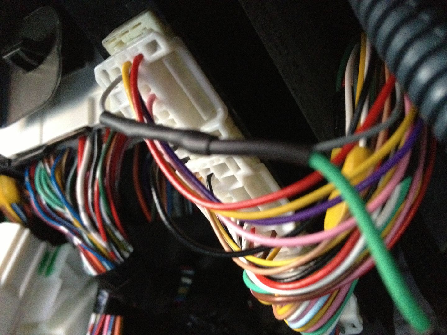

Lambda sensor for AEM gauge
RPM wire for AEM gauge
Vacuum / boost tap for AEM gauge

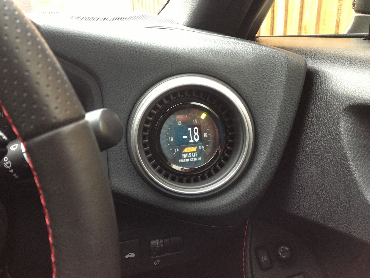

AEM Gauge fitted in drivers side vent

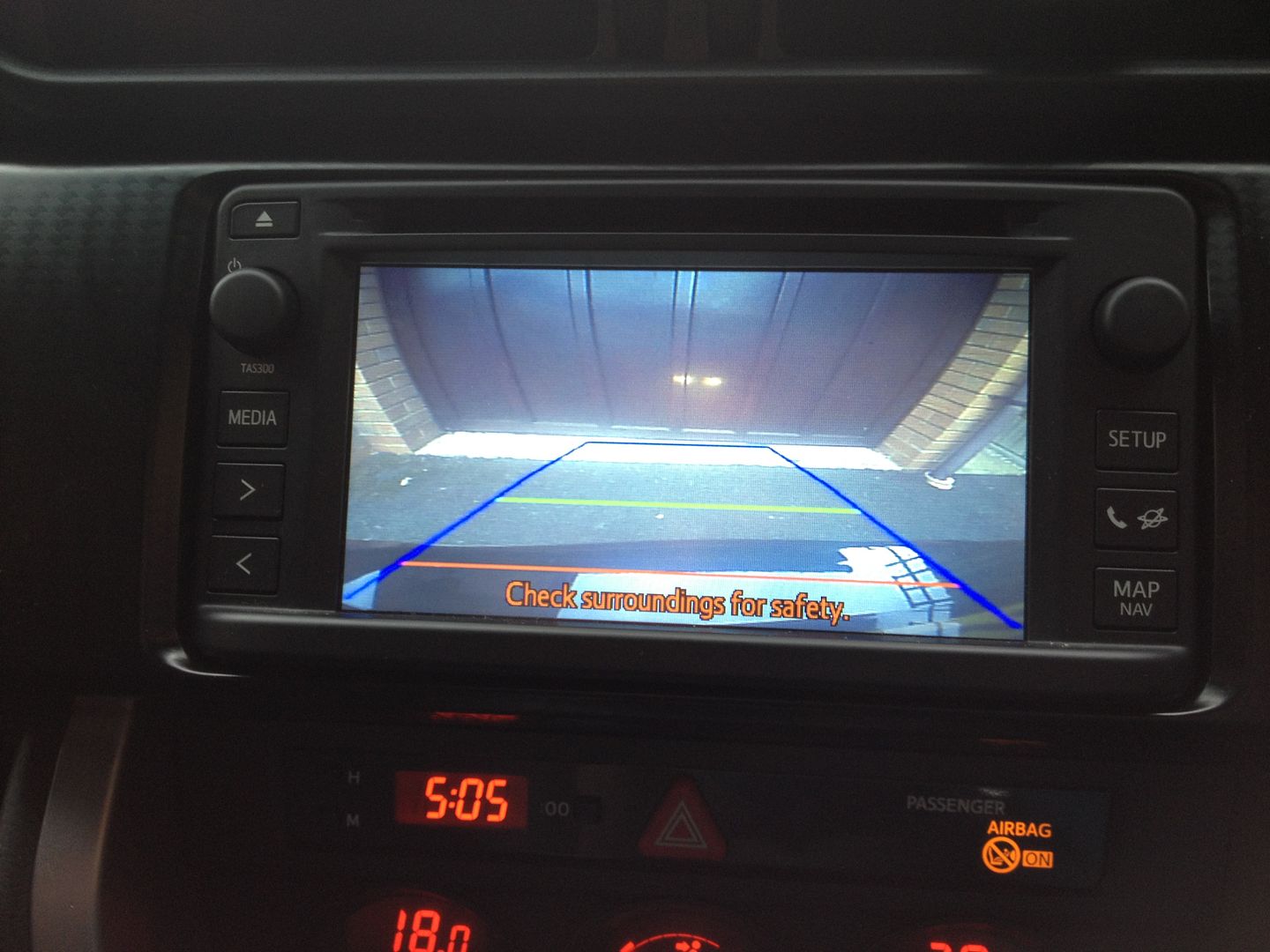

I have also fitted a reverse camera

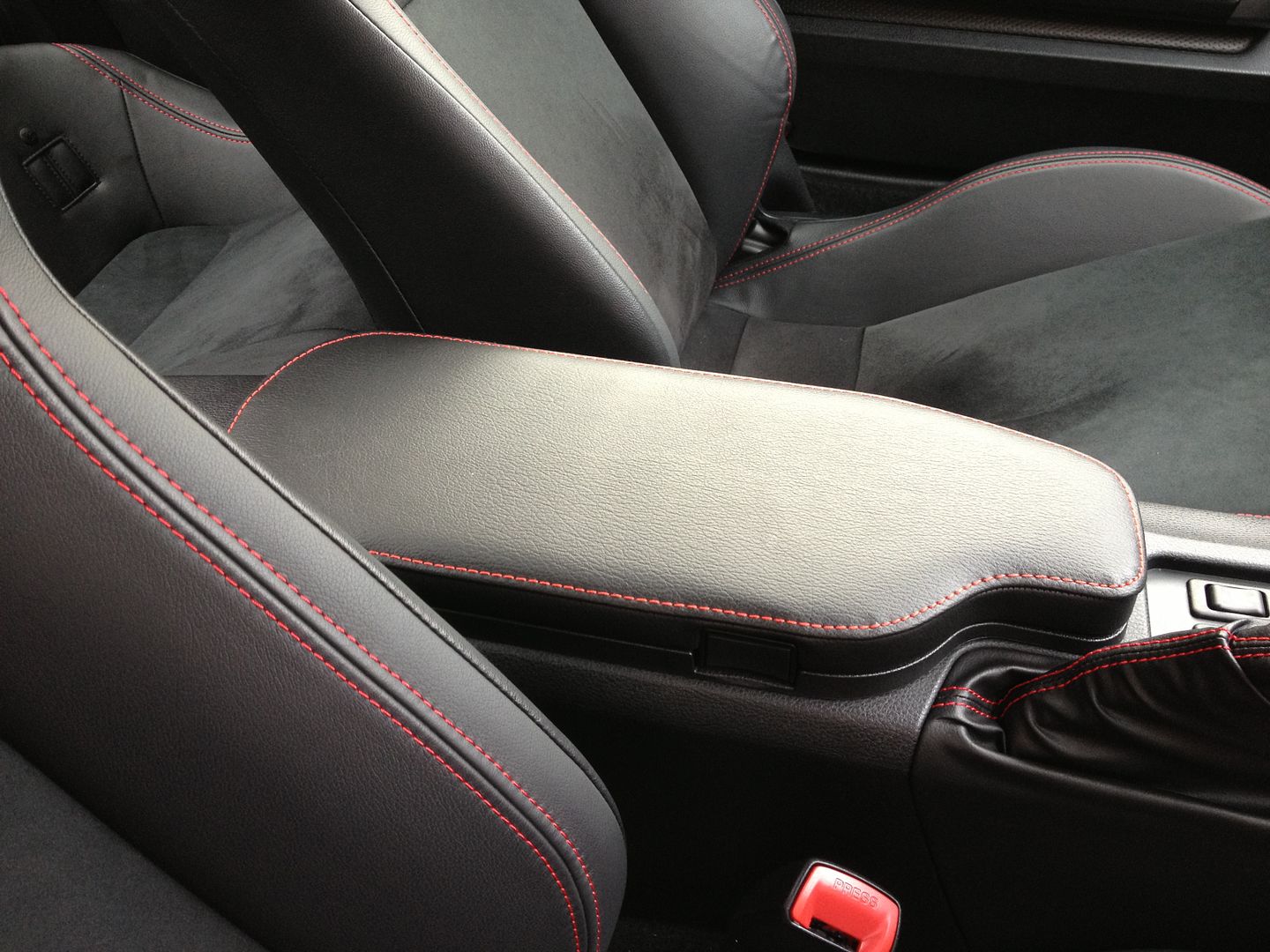

Also fitted the new Toyota centre arm rest

Thanked 38 Times in 27 Posts
@Pitman - that armrest is an OEM option in the UK?

It is, just like the red Alcantara seats with Red trim too.
