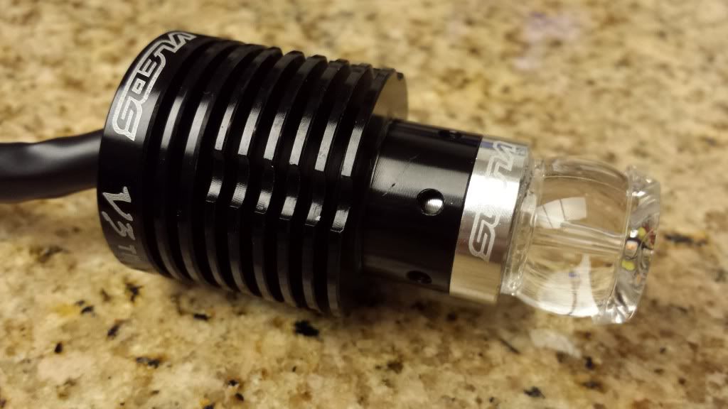

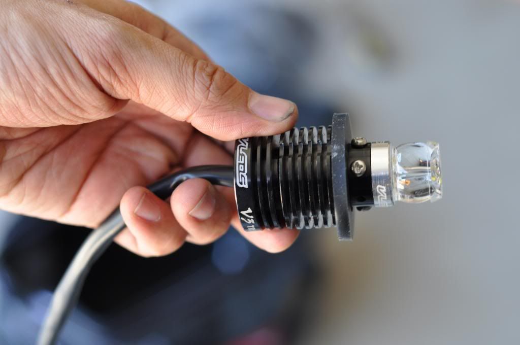

Build quality:
Amazing. The housing is made of machined aluminum to help dissipate heat. The heat sink/mount is actually threaded on to be able to adjust how far the bulb projects into the housing to get the perfect amount of light that you want.
All the connections and wires look durable and exceed the quality of the Morimoto HID retrofit I have.

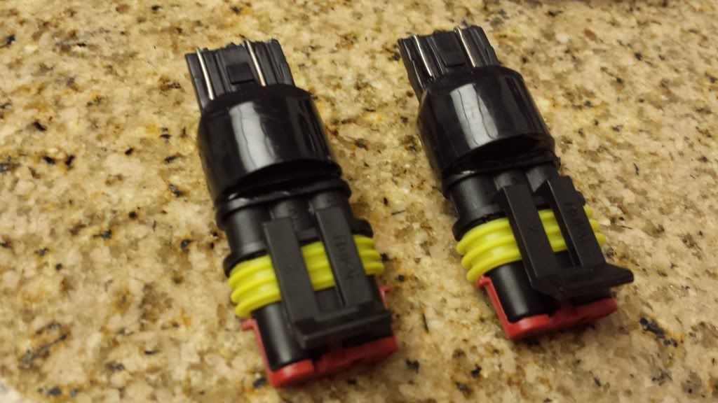

You will need to order the 7443 adapter which plugs into the existing turn signal plug to tell the unit when to be running lights and when to flash.
I also purchased these because they reduce themselves to 50% brightness when the headlights are on. This is optional or you can have them full power 100% of the time.
I have owned other switchbacks and was not happy with the build quality or brightness. These are advertised as 600 lumen which is pretty damn impressive. The other brand I had literally had to be glued once I took them out of the packaging because the led array came seperated from the plastic plug portion. That vendor said I was out of luck and should glue them.

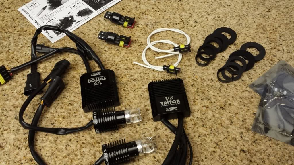

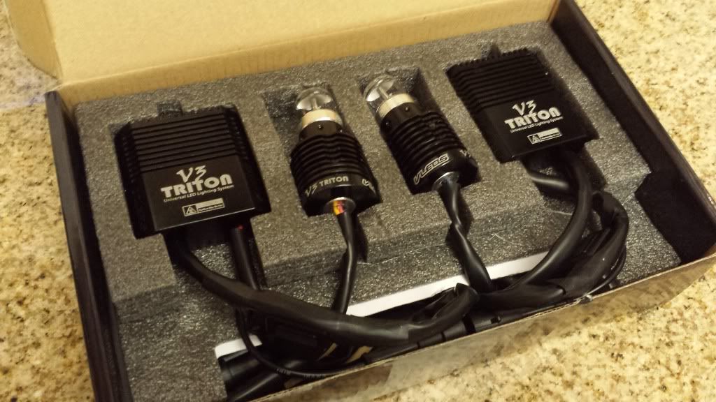

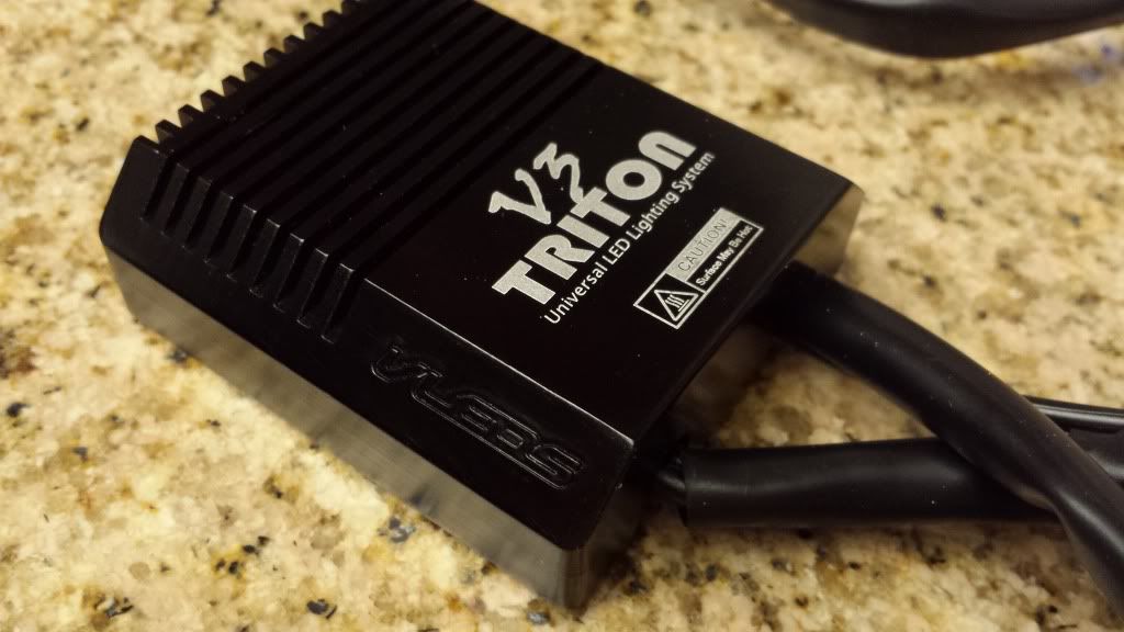

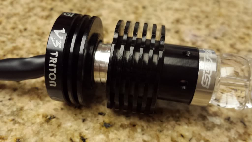

Unboxing
Good packaging but the product speaks for itself. Here are the pics.

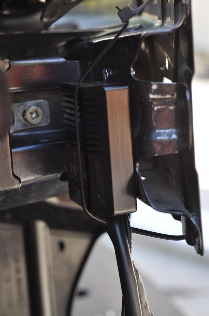

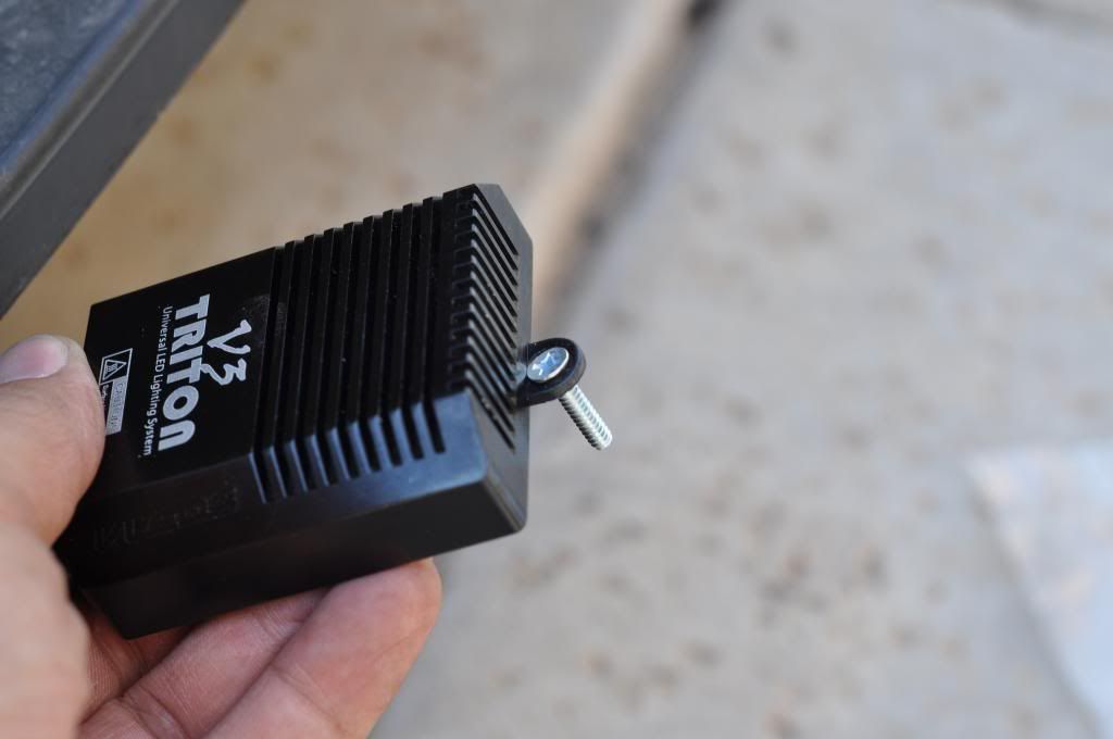

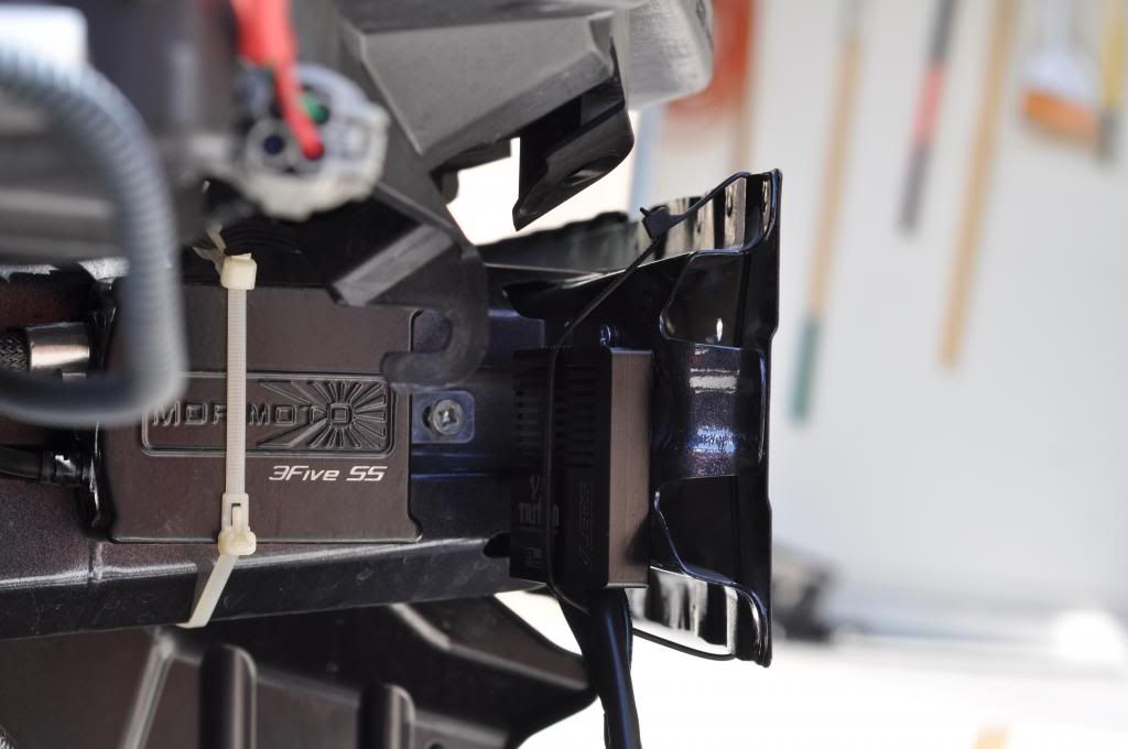

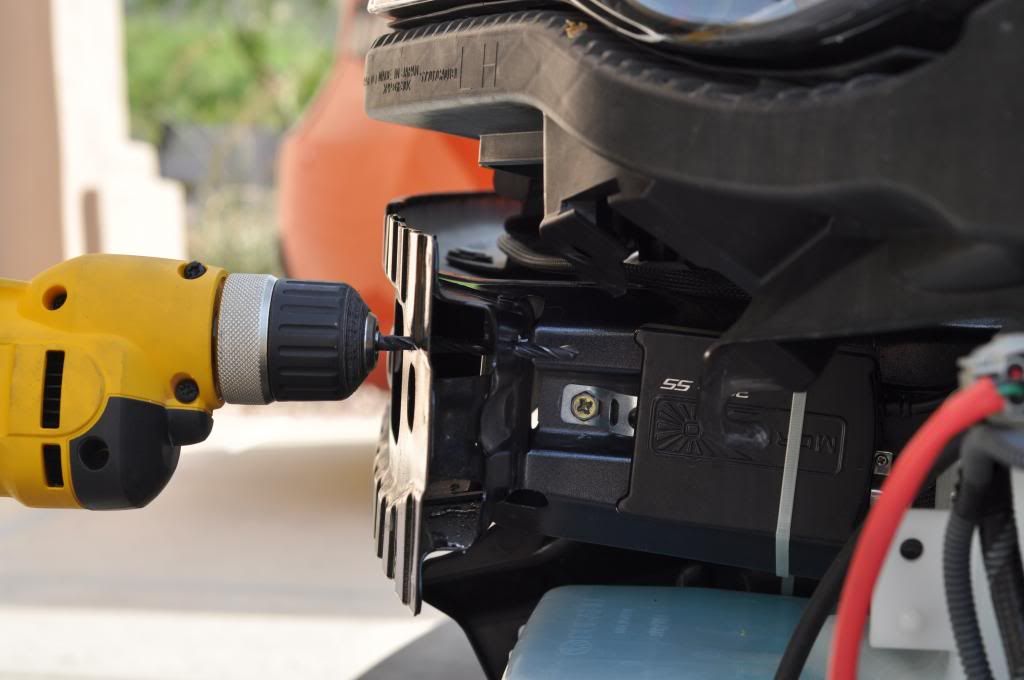

1. Mounting the power modules
You will see I have the Morimoto HID retrofit ballasts mounted so dont worry when you dont see those on your car. Since that area is taken I found the next best spot which is on the back of the bumper. I would recommend mounting them exactly where I did as there is enough slack in all the wires and worked perfectly.

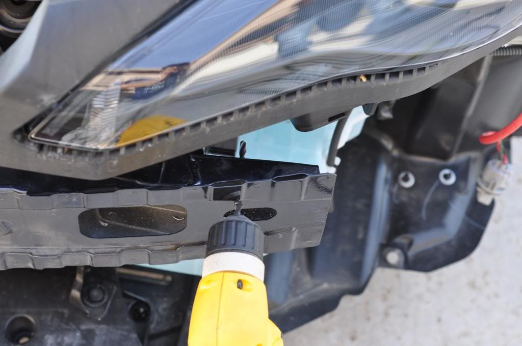

I used a 7/32 drill bit to drill a hole through the front and rear. If you have a right angle drill you can probably just drill from the rear through just the back sheet of metal.
I used a small tapered head screw as the hole on the power module is pretty close to the power module itself. This made any other type of bolt pretty difficult to fit without hitting it.
I used a zip tie to help support the module to the bumper. I would recommend a stainless steel zip tie if you can since the instructions say they can get hot when using the built in resistor function in full time use. I removed the two fuses as I have a after market turn signal relay to stop any hyperflash.
The zip tie passed through the little slit in the top and bottom of the bumper. This way it did not interfere with the styrofoam front bumper when you put it back on.
This shows the both modules mounted with the wiring hanging down.

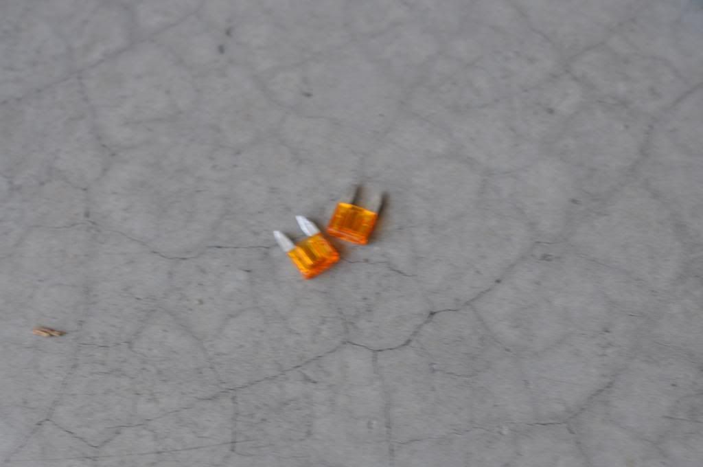

The two fuses I removed from the power module wiring.

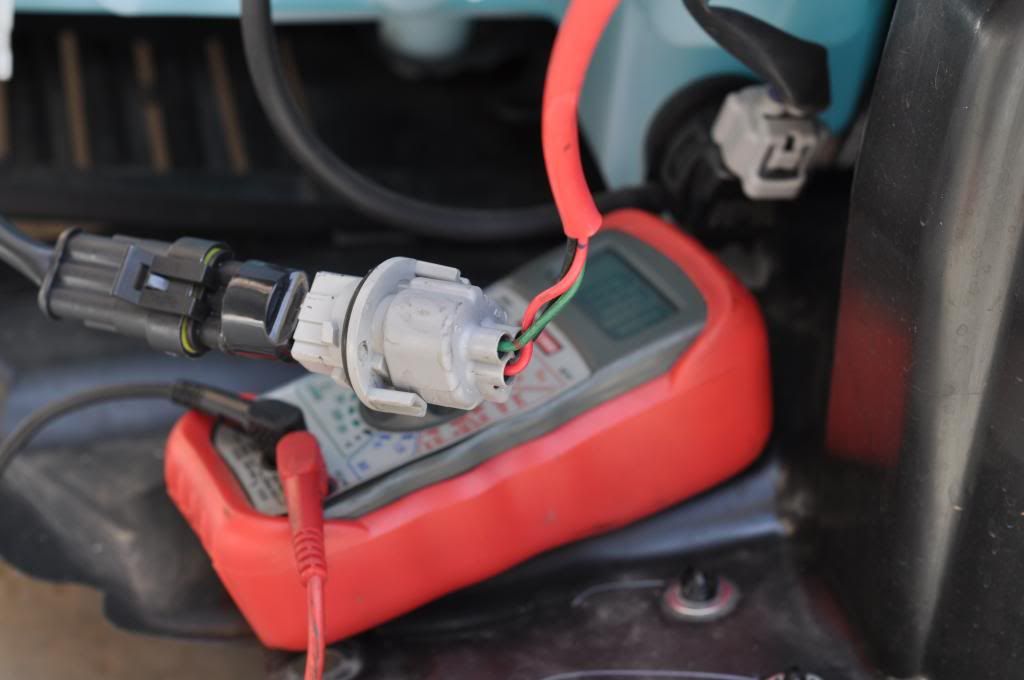

I wanted true DRL so they running white would be on whenever the car was on. The switchbacks function great. They will turn yellow as needed as well.
To do this I modified the stock turn signal group of wires that are in the red sleeves. The green wire in each of these will need to be cut. You will basically be providing ACC power from a source into the green wire going to the bulb. This way they turn on when the car is on.
Make sure to put some heat shrink on the unused side of the green coming from the original power to prevent any shorting.
I started at the passenger side. Soldered a new wire with heat shrink. Ran it over the bumper over to the driver side where I soldered it to the green wire on the driver side. I added a third wire which runs back into the cabin through the firewall into the fuse panel under the driver side dash. I tapped into a unused socket in the fuse panel. I used a volt meter to find the one that had ACC power and was not used. Ill provide a picture when I get one.

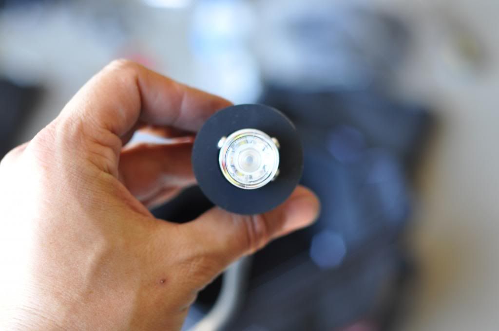

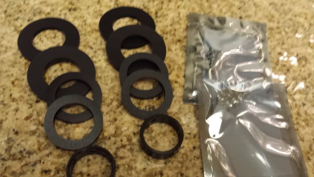

First you will need to rotate the heat sink closest to the bulb until it bottoms out. You can then rotate the heat sink farther away from the bulb until it butts up against the other heat sink. I snugged it down. This locks the position of the forward or backward movement of the bulb in the housing after install.
You will then need to add one of the supplied rubber gaskets to each bulb. The largest diameter one that is the thickest works absolutely perfect. Once its slipped over the bulb and bottomed out on the heat sink you can move on the next part.
You will need to install three of supplied 3mm screws into the ring near the bulb itself. These screws are used to lock into the notches into the light housing. I just put one screw in, held it into the hole of the turn signal housing to see what other screws needed to be added.
You can see in this pic the general layout of the three screws and the rubber gasket.
You can now insert the bulb as usual into the bulb housing and rotate it to lock it into place.
