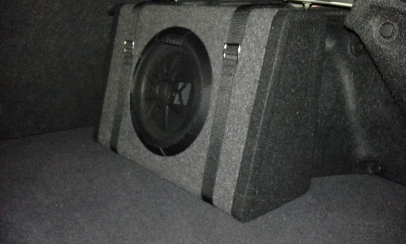

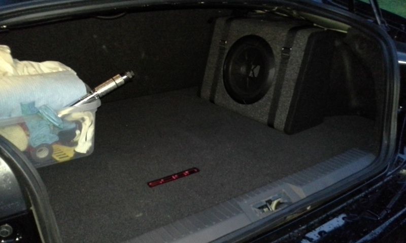

So basically it fits perfect in our small trunk. It also has 2 straps to hold the sub. Overall quality is very nice. The other thing I liked about this unit is that it is very easy to remove if you have to. The one connector has every required wires. Install was pretty straightforward. I just had hard time trying to feed the power wire through the firewall. Other than that, it was just taking time to hide the wires. For ground location, I followed the OEM Audio Plus DIY Video. I took off the rear passenger side panel and there was a good ground location. Below are some pictures.

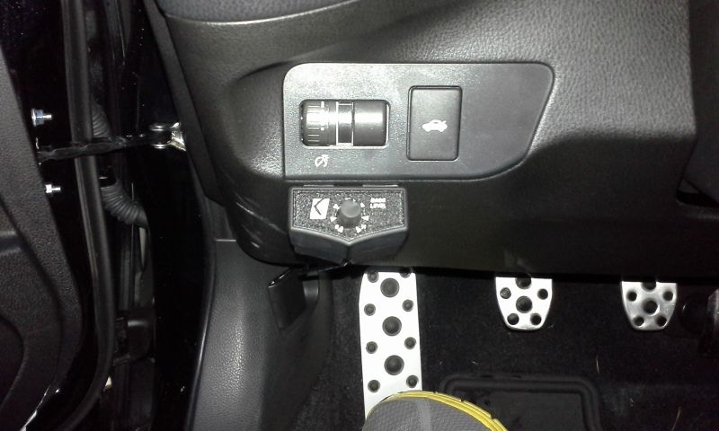

This is the bass control. I mounted it where I can easily access. The wire is hidden just like the power wire on the other side.

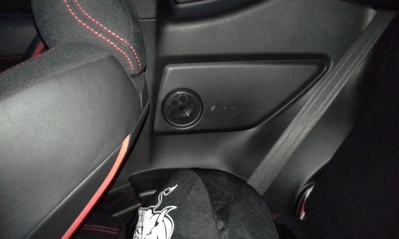

This is the rear side panel where the ground location is.

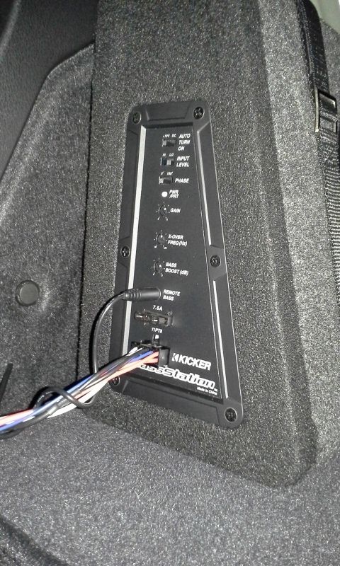

Lastly, this is the one connector that has every wires.
