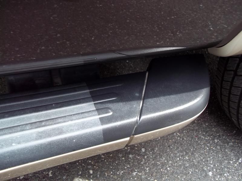

This was a Ford Explorer. Not a permanent fix as it had to be reapplied a few times a year. Certainly a big improvement though.
