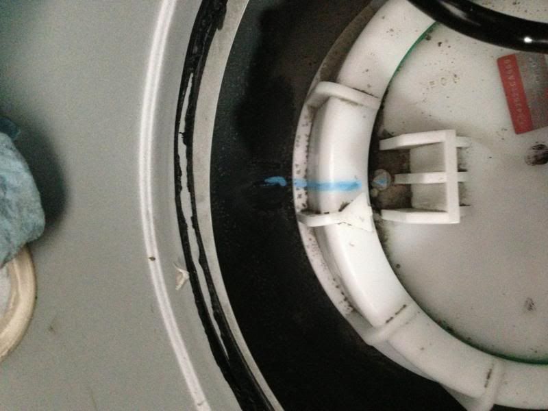

Step Five: Take photos of Fuel Canister, and notes of Orientation
This part is very important. Notice the photos below. You should have a blue mark like mine did on the correct orientation on how everything is suppose to line back up once you are ready to put the canister back in. The most important arrow is the one ON the tank itself. This has to be lined up with the small dots on the outside of the tank (the black area). Your fuel canister goes in a certain way because of the float sensor, if this is in the wrong direction you could possibly get wrong fuel readings, or damage the float!!
MAKE SURE TO LINE UP ARROWS WITH CASTING DOTS WHEN RE-INSTALLING

Now, take note of this lip on the plastic ring.
Now look at the front of the outer gasket of the tank (by the dots). You will see that these two need to line up in order to put the plastic ring on correctly. Line that up, and then push the plastic ring down. I had to push down on the back of the ring (closest to you) in order for it to line up so you weren’t trying to thread it on an angle. I thought I took a picture of the rubber gasket…sorry about that.
You will know you have it on correct because if you don’t, you won’t even get half a turn in before you can’t turn it anymore. You should be able to turn it about 80% of the way on before you need to pull the hammer and punch back out to tighten it.
I couldn’t get the arrow to exactly line up on the plastic ring to those arrows (it was very close), but the important arrow is the actual canister itself. I hammered it back on until I couldn’t move it anymore. When I did this my canister kept moving so you might have to play with it a few times to get it lined up correctly.
