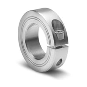

If you welded two of these in the proper bore together that would look pretty trick. Maybe put two on each reservoir.
They are called "clamping collars". As per Orbital check Mcmaster.
