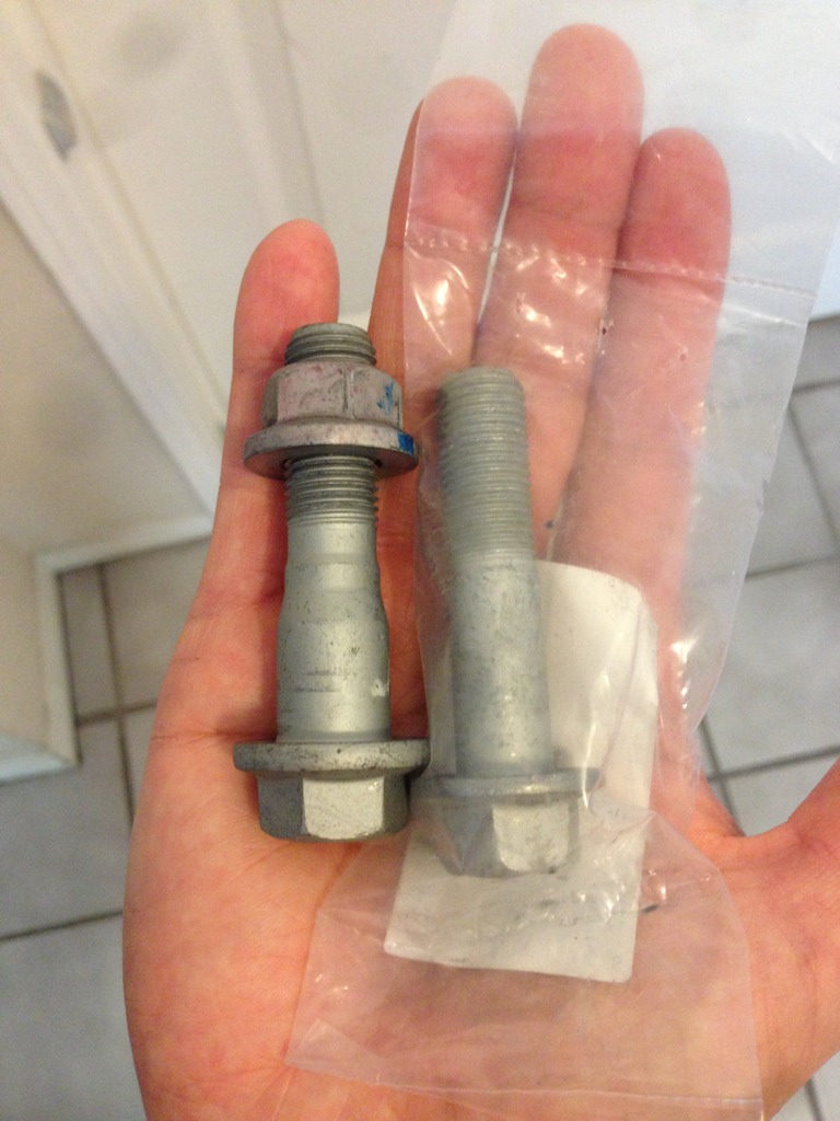

The crash bolts are 6 bucks a piece. Hold on a second. I ended up going whiteline camber bolts, but I can show you a pic of both side by side.

Here you go. The one that comes with the car is the unwrapped one
