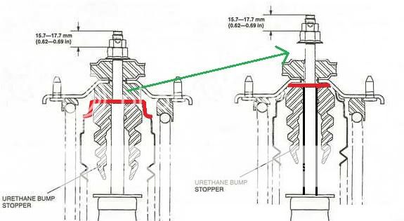

Is this a purchaseable solution for an 86? I found it in Miata forums
http://i985.photobucket.com/albums/a...shockmount.jpg
No, not available, because 86 doesn't have front shocks.
But, if you mean cutting a bit off the bump stops, yeah, you can do that and it's free.
Or look into the robispec rear mounts and Ground Control camber plates.

Robispec rear mounts will allow 2-3 inches more rear travel depending on which one you get. Ground Control camber plates will allow about 1 inch of travel in the front.

A note about top mounts that "add shock travel" including our own RCE front camber plates.
They only add bump travel if you are running coilovers. On dampers with fixed spring perches (i.e. stock or Koni) you will simply lower the car without reducing bump travel. Still cool.
On coilovers they'll lower the car, and then you can raise the spring perch back up to get to the same spot you were before. Except now you have more bump travel than before (and less droop). Very cool.

That is great, looks like Ill keep the stock and add these plates.
