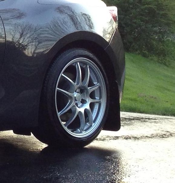

Thanked 149 Times in 61 Posts
Here's what the stock 215 looks like on my 17x8. It's stretched but not bad. Ride quality is still very good. I'm going with 225/45 when they're worn out.
