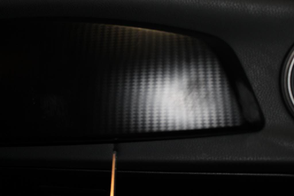

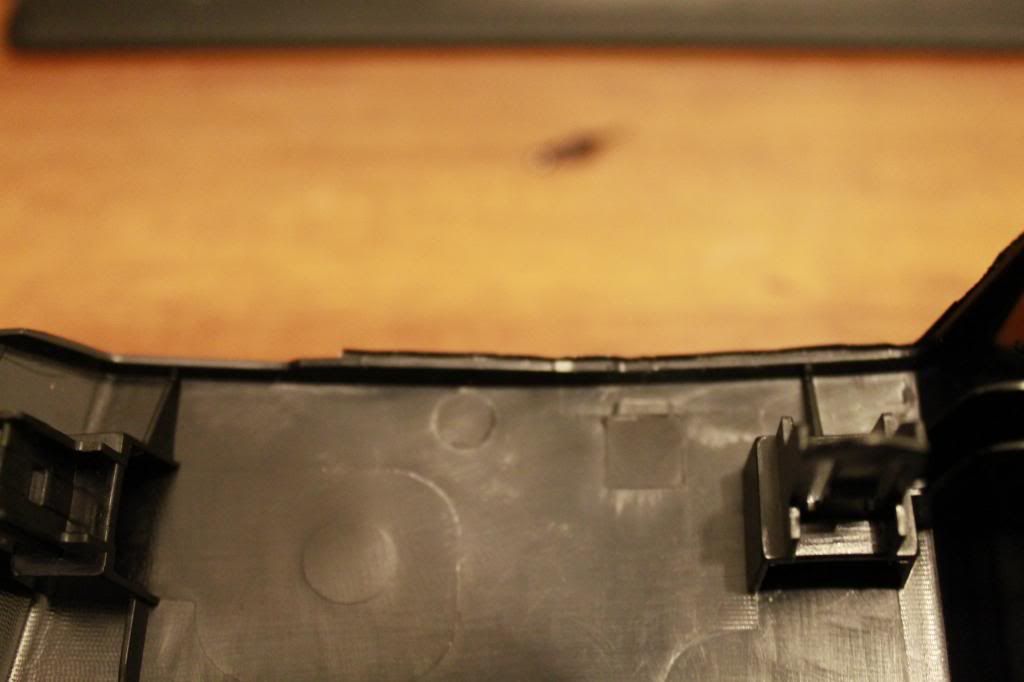

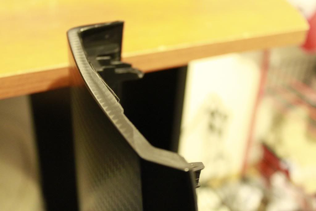

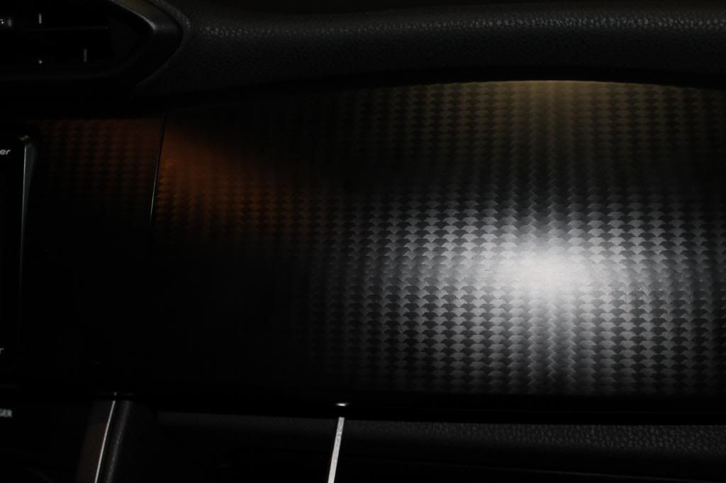

I pulled off a piece of the vinyl
I felt it with my hand and lifted. Heat gun would make it 100000x easier
Bad photo

Originally Posted by Pacific Auto Films View Post
Hey don't mean to steal thread, but whats the trick to remove the dash panels? ^
Oh it was pretty easy for me. I just took a tiny flat head and poked under the bottom panel and popped it out of place and then I just gently ripped it out. I didn't want to break the inserts. I did it in 3 places but be careful, I scratched my vinyl which isn't too bad since you won't see it.
