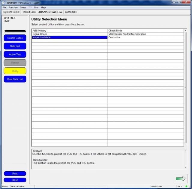

Ebay. I got it from this guy http://www.ebay.com/itm/300885728069
-How much did it cost
$24.99 Free Shipping

Here are the screenshots of the main selection screen once it connects to the ECU
From here I clicked the customize settings
Here is the window that shows the settings you can customize
You select each one then click the right arrow at the bottom to continue to the following screens that allow you to change the settings

What other features does the tech stream have
Has some pretty cool live monitoring of values from the ECU.
Also has some ABS and TPMS but I believe its for viewing only
-Another cool diagnostic feature I played with is being able to toggle the dash lights on individually to test functionality.

I wonder if there is a setting that FULLY turns off ABS,VSC. It sure would beat doing "the pedal dance" every time I start my car at the track! If that software has that capability, it would be HUGE!
Scott
naikaidriver is offline   Reply With Quote
Old 04-23-2013, 04:48 PM   #12
xjohnx
Grip>Slip
xjohnx's Avatar
Drives: 13 SWP BRZ Ltd - Innovate Powered!
Location: RVA
Posts: 3,563
Thanks: 656
Thanked 1,717 Times in 1,031 Posts
Mentioned: 45 Post(s)
Originally Posted by naikaidriver View Post
This is FANTASTIC!!!
Thanks for sharing!
Scott
There isn't, unfortunately.
