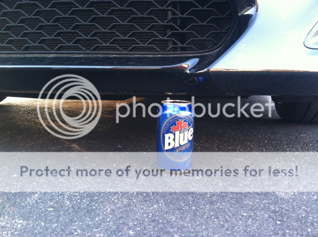

Ground clearance on just 1" sport H&R springs. No aero.
Mods: Perrin CAI, JDL EL header, DC sports Catless front pipe, top speed auto pro-1 cat-back, H&R sport line springs, Headlight blackout, "Demon eyes"

LOL nice way to show it indeed!
