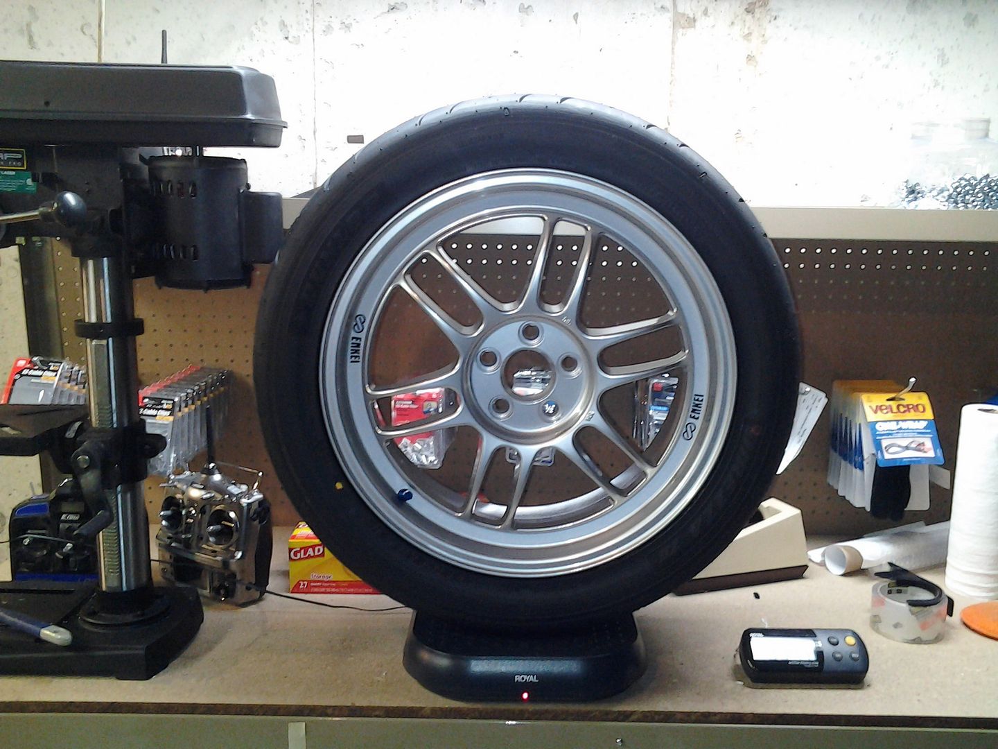

Shown with 225/45/17 Z2

SVThis, any pics mounted?

Here's your picture

Thats one good reason why not to always bet on black.
