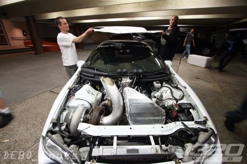

By the same theory, going to 4" would be even more benefical, and having no exhaust at all would be better again.
No, that's when you would do something like this instead.
